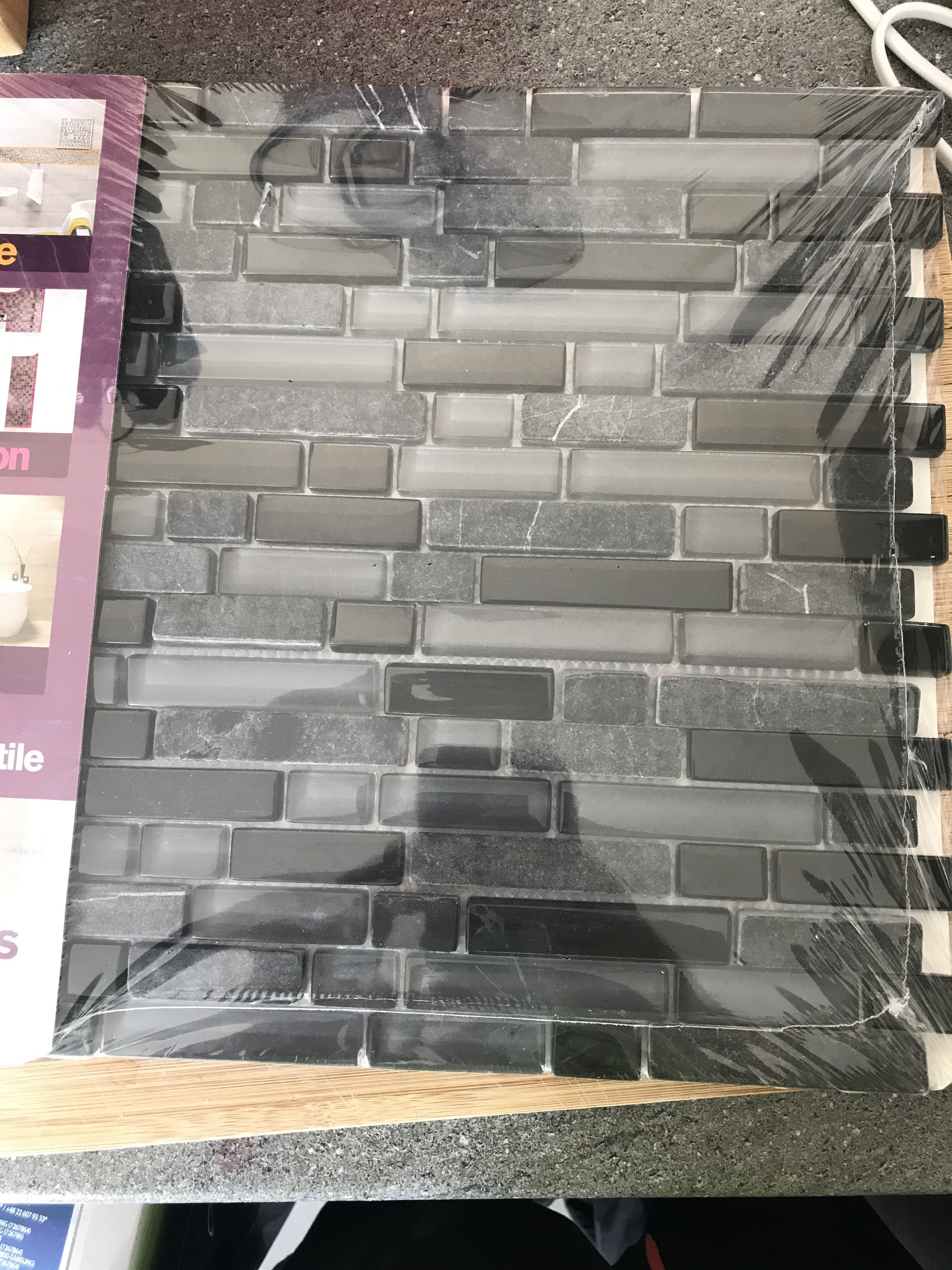

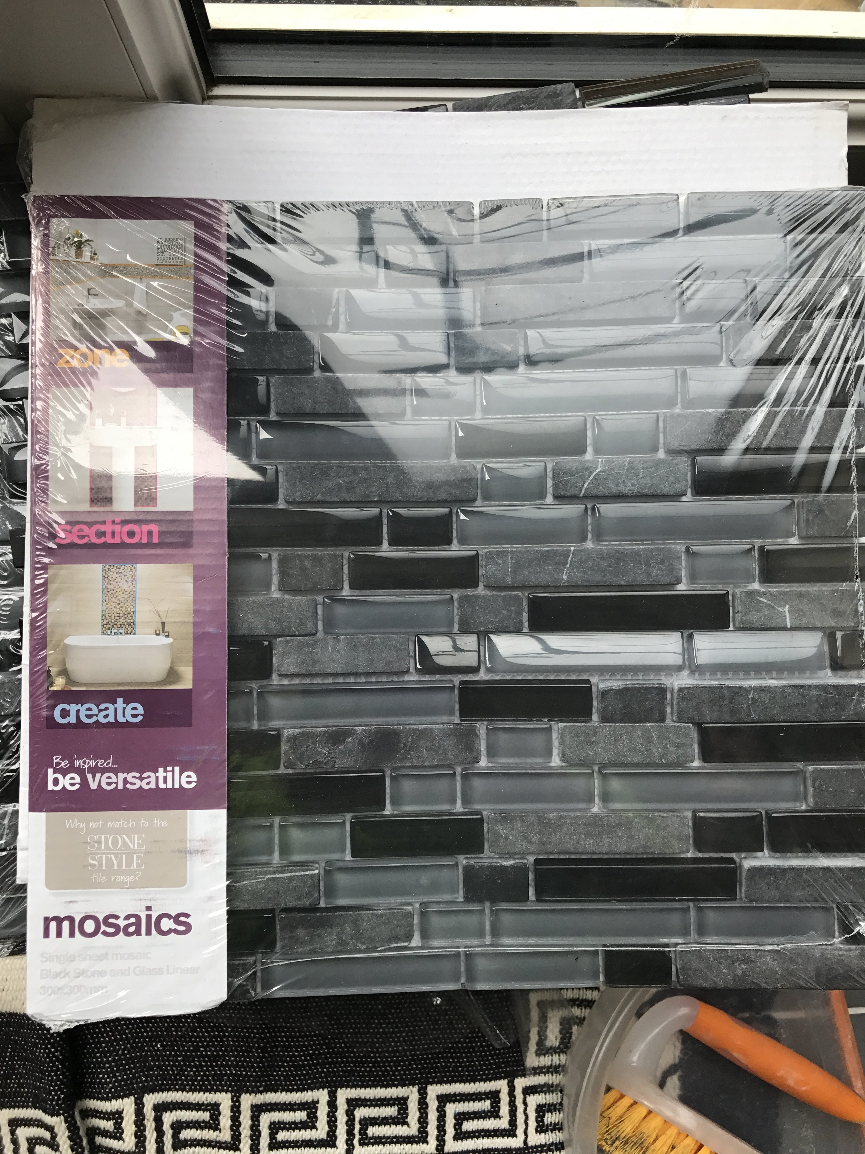

These are the mosaics glass and stone.
I have used these before and I can confirm you are in for a headache...
Alot of the mosaics are stuck on squint, slightly different sizes. I ended up sticking them on and going back with a Stanley knife to cut and fix the worst offenders. Best of luck.
