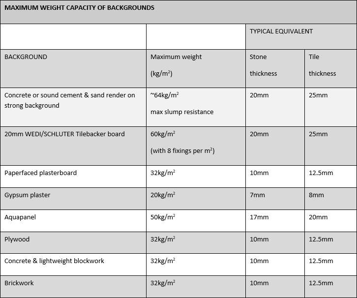

I've got a job coming up soon in a bathroom, wall to ceiling around the bath then half way on remaining walls.
The tiles are 600x600 porcelain 9mm thick and the substrate is skimmed plaster board.
I'm looking for advice on what adhesive to use, I usually use kerakoll biogel no limits would this be OK to use or should I look at something else?
Also regarding trim would 10mm be OK or should I go for 12.5?
First time fitting porcelain tiles of this size on walls so any advice or tips would be much appreciated,
Thanks in advance
