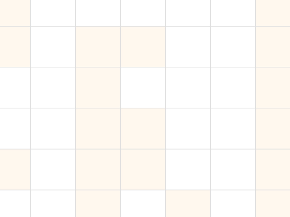

Had a tiler in to tile a living room (12m2). Bought the tiles ourselves.
Came home to the job done and noticed slight colour variants in the tiles laid down. Pointed it out to the tiler who said he had noticed the differences in the tiles but the codes on the tiles were the same so he kept going and didn’t flag it. Rechecked the codes and there were two slightly different tile variations provided by the tile supplier.
The tiles have the same pattern but one tile is whitish and the other is brownish.
Who’s at fault here? Is it the tiling company who provided two different tiles or the tiler for not checking the codes on the tiles whilst laying them?
What would generally be a fair solution to this? The tiling caused a lot of dust to go through the house which has taken us a good few evenings to clean so I’m really not keen on them being pulled up… Planning to move in two years so tempted to leave them but am I in my rights not to pay the full amount for the job?

Meant to add that the tiler is putting it on the supplier and the supplier is only willing to replace the wrong tiles but won’t cover the labour involved in having them replaced.

I take your point fully. At the same time, I'm just a random bloke who ordered tiles from a tile shop and booked a tiler to do the job - I had no idea tiles had codes to even check until the tiler himself told me that's how they know the tiles are the same/different.
It's also not like the tiles were laid down in a pattern or anything that would suggest there was a deliberate purchase of different coloured tiles. The tiler did spot the different colours, didn't fully check the codes (but I take your point that arguably it's not his job), and didn't just give me a shout to check with me even though I was working 10 meters from the room he was working in.
I'm gonna pay the tiler what he quoted and take the issue up with the supplier, but in all fairness would you not have expected the tiler to flag with the customer that two different coloured tiles were going down? Especially since they weren't put down in any pattern on the floor to make it look like the different colours were put down on purpose? The room now looks like the image below.
