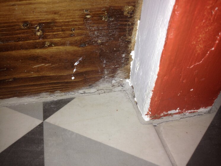

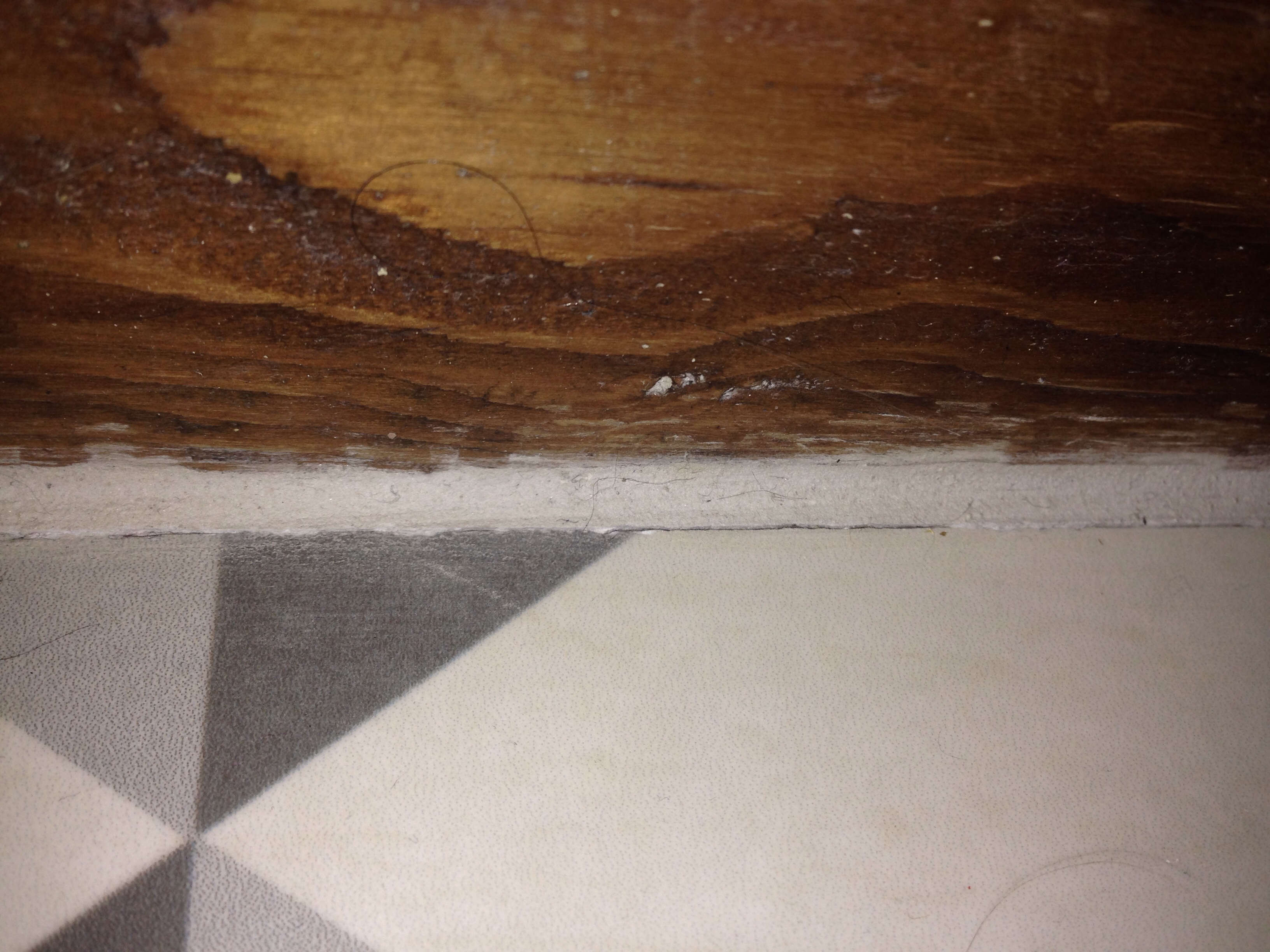

I'm hoping somebody can help and give me a good honest opinion.
May last I had my kitchen tiled. The subfloor is 18mm ply with ditra.
Shortly after the floor was finished around a month later I noticed a crack in the grout running horizontally by the back door. It seems to coincide with where the ply underneath meets. The tiler said it wasn't abnormal to have cracks. It hasn't got worse but I am curious to understand why it's happened. By the doors to the back door part of the floor is concrete. I have photos to show the they didn't ditra over the concrete so half the tile is on concrete and the other on play and ditra. The crack is running a along the grout line after that tile. Thoughts? Another tiler seems to think it's because they didn't ditra over the concrete.
At the other end of the kitchen there are cracks running along the grout where the grout meets the old wooden stairs. I'm particularly concerned by this as the tiled floor directly where the cracked grout is make a little creaky noise when walked on. Not all the time but sometimes. I'm not entirely sure if it's the old stairs creaking or the ply underneath. Having looked online it says that sanded caulk should be used when grouting next to wood.
I have had the tiler who carried out the work back around however he thinks the cracks aren't a sign of anything bad but of course he would say that. He seems to think an old house such as mine has movement which could cause cracks in the grout..
Any thoughts you can share would be greatly appreciated. I've attached some pictures so you can see how the cracks look and may help you advise..
Thanks in advance
Nat
Should have been an expansion / movement joint at intersection of wooden floor and concrete.
Should have been a movement joint round perimeter of room, silicon joint.
Both cases, tiler error 🙁
Floor creaking equals movement, floor was not correctly prepared before tiling, was ply fix correctly? Was joints solid enough? Or has something moved after tiling was finished?
Not abnormal to have grout cracks where there is large movement - like against doorways. Simple solution would be to replace the cracked (not really cracked but moved) joint with a good quality mastic.
The tilers did the subfloor, strengthened it too but I dot have pictures of that particular area of subfloor whilst it was being done. As I said I can't tell if the creaks are coming from the floor or stairs. I have a builder friend (who's very experienced) and he seems to think the creaks are coming from the stairs.
If I replace the cracked grout where the stairs and tile meet, with caulk would that not work? I've read online that, that should be used between wood and tile..
Thanks
Not chalk but a good quality silicon to match grout colour.
If the floor is moving this may still give problems later with tiles coming loose. High foot fall area at base of stairs
Thanks for your reply - can you clarify what you mean by movement 'like against doorways' there's a set of 3 stairs that lead from the tiled floor to the hallway. Obviously us walking on the stairs could have an impact on the grout cracking? A builder friend who came to look said he thought the creaks were coming from the stairs. They're old pine stairs so it's not unusual for there to be some Movement..
The tilers did the floor, if it's moving surely they're responsible? The invoice for the job says the work is guaranteed so surely they are responsible to Silicon/grout as a first step to fixing the problem?
The rise on the first tread, that meets the tile will probably be moving every time you step on it - it is timber and it will be flexing - only fractionally but enough to cause the grout joint to displace. Just replace the grout joint with good quality mastic Silicon caulk or whatever you want to call it.
Soudal is my mastic of choice.
Thanks
Thanks Tom will try and see how we get on.
