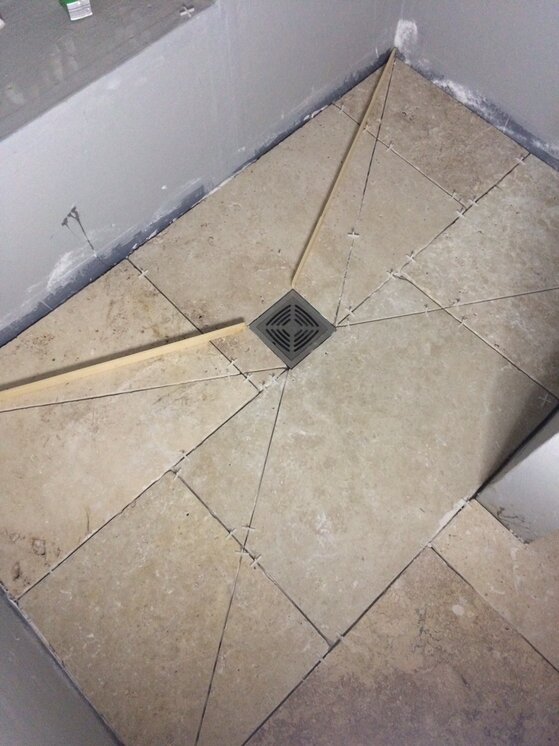

So the tiler has just left and we have this in our wet room.
What do you think? I don't think it's how it should be - would any of you be happy with this?
It was just laid today so I don't even know what is involved in taking it up.
Opinions very welcome thank you!

Not seen one like that before, usually all four corners of the drain have a fall.
It's not unacceptable per se but it's unusual. I guess?
He's done the fall to the grout joint as a whole I assume? So then it runs into the drain from there?
If you're not happy, ask him to run it to the 4 corners before it's too late to rectify it.
What adhesive has been used and what's under the tiles?
I don't know what adhesive is under the tiles but really I would prefer it to all 4 corners. Am just slightly worried about saying start again!
The bits of wood in this one show where I assumed the lines to the drain should be.
It just looks wrong and now I've seen it I can't unsee it! Since I seem to be spending almost 10k on a 2.5m square bathroom I am not sure I can live with it....
They shouldn't be there per se. I guess it's personal preference.
You usually find they fall to the corners. That's what nearly everybody would do. I can't see why the set out has been chosen that he's gone with. It's the same amount of cuts pretty much etc.
I'm wondering what the fall is in the former under the tiles or whatever? Perhaps that's stipulated the location of the fall in the tiles?
I might me talking out my arse though. The other lads are the professionals here I'm just the tea boy.

It's a wet room shower tray under - the drain is off centre and the point he's come to is in the middle of the shower but it just looks wrong.

if he has tiled on to a shower former the lines will go from the corners of the outlet and it will have the correct fall. if he has moved the lines the fall will be wrong so he need to re do the back three tiles to follow the fall in the former.

Tiler is off site today but the builder / project manager who built and tanked the shower area said he had noticed the irregular cuts yesterday and spoke to the tiler who apparently was following the former lines exactly.
However, this morning, contacting the shower tray company revealed that you can indeed go "off former" to meet the corners of the grate without any issues.
The problem now it that its all gone off and they say that it may damage the tanking, waterproofing and even the tray if we take out the 3 back tiles meaning the whole build will have to be restarted.
The dilemma we now face is - do we get them to redo it. The issue I suspect is more aesthetic but I just can't unsee it now and have to weigh that up against the cost of it all going wrong.
Incidentally I felt absolutely terrible mentioning it this morning as they have done an amazing job, but the devil really is in the detail and had to do it as with all the money invested in this, I really wanted it to be perfect!
Oh okay so he did follow the former lines. So perhaps wasn't wrong at all then.
If it's your personal preference to have the lines in the corners (which would be my preference too) then perhaps just deal with the damage and get it done. But perhaps don't expect the tiler to do it FOC if he's not done wrong following the former.
FYI it's a Aqua dec shower tray with rotatable drain so I guess there are no solid former lines to follow as such - so I feel he definitely had some room to play with. The drain is off centre due to joist position but I do think he could a got a much cleaner look.

I'm guessing whoever ordered the former knew what the layout was going to be like? Especially if they ordered one specifically to fit around the joist or whatever?

I think from what feedback I'm getting from the professional's on the forum, that the tiles should have met the corners of the drain as you (and I) would expect.
So unless there is a reason he's done it weird. Then perhaps he hasn't done it actually correct.
You could do with finding out why he's done it like that if you're about to tell him to re-do it which might cost him a new former and a day sorting it out! Perhaps the builder or somebody specified he did it like that?

We are really worried about damaging the wet proofing underneath - I don't mind the hard work of getting them out but ripping the whole lot out to re-do the wet proofing is pretty epic on the disaster front. Just wondering about using a travertine filler - do you think you could hide the wrong lines with that? Am I grasping at straws?
Just take it up and get it done the way you are happy with. Never seen anyone do the falls this way before. I would be looking at that every time i had a shower.
Never mind if the taking needs redoing, you wont be happy with the way it is.
I think we're making a mountain out of a mole hill here.
Hammer and chisel the back three tiles until you're back to the adhesive, then if needs be, he can skim the back of the new tiles going in there a little to take off some thickness to fit them in. It's not the end of the world. They're going to have a fall anyway.
I think it looks ok and so long as the water drains well I'd be happy with it. That said, its you that needs to be happy so if your not, definitely redo it. It's costing a lot too, so I'd want exactly what I wanted for that. Nice looking tiles by the way.
But I have to say, I think there be really hard to get off the tray without causing damage to the tray. That said, I've not handled these aqua trays before.
If it's one of those things that would annoy you when you have a shower like @Sir Ramic says then it's a no brainier.
