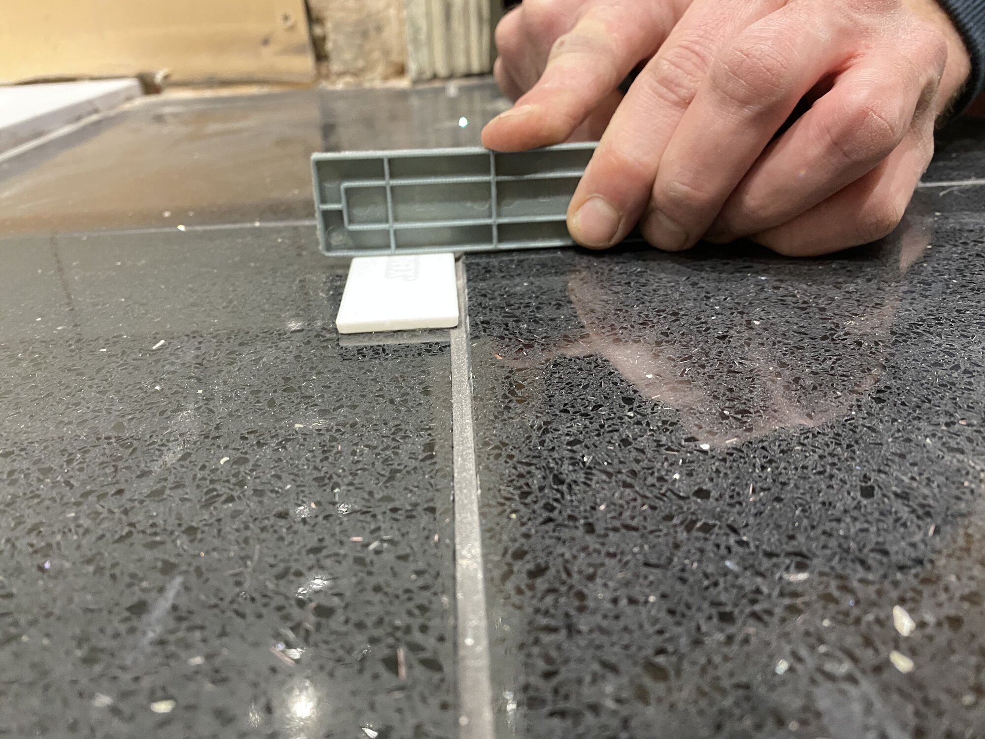

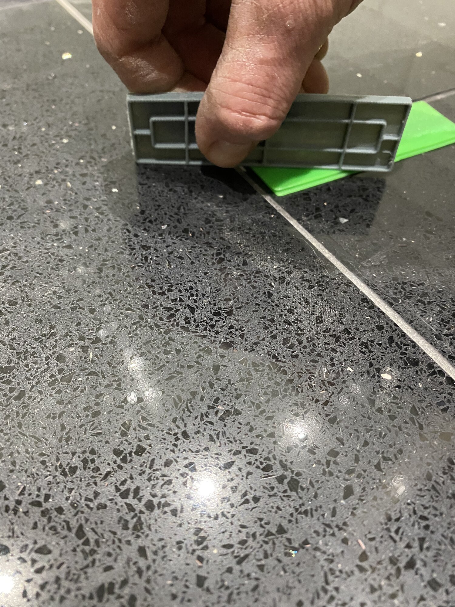

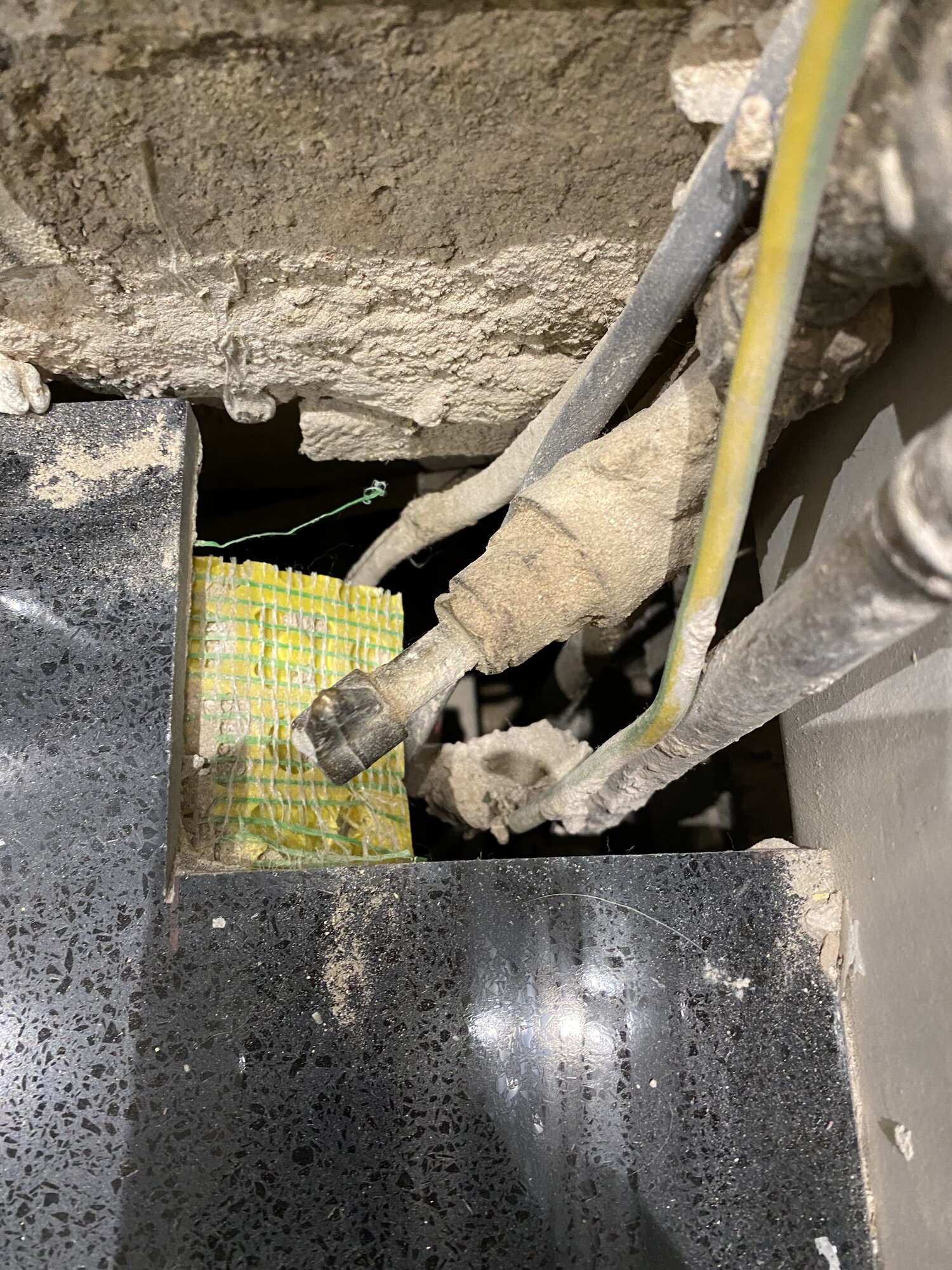

We thought the walls weren’t prepared and sealed before tiling (no tanking, tiled directly onto bonding etc) . Tiling was out of alignment. The floor tiles weren’t level and had lipping of about 3mm in places. The niche cupboard in the shower had 3 wood sides with no seals, there was tiling on to
wood on the outside. There were odd cuts out of tiles where he’d slipped with the angle grinder etc. The ceiling is sloped.
