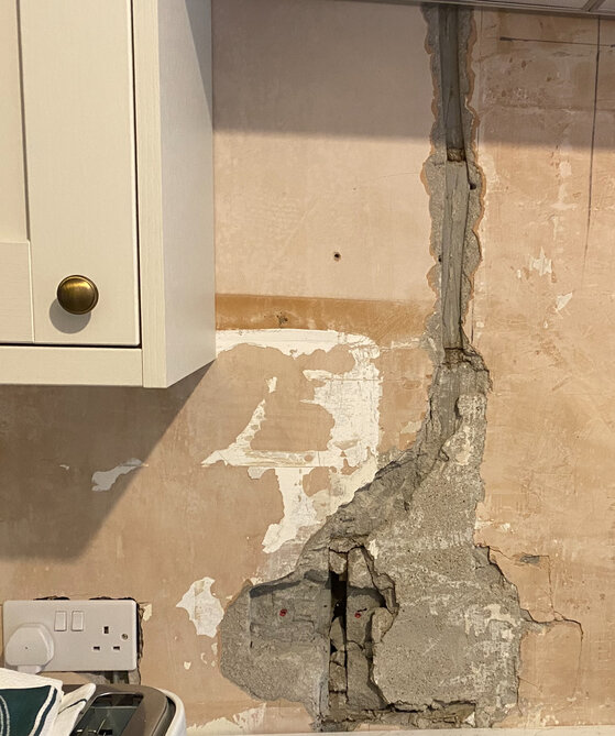

I’m after some advice please.
Is this area going to need plastering before tiling or will tile backerboards be ok to use? Not looking for a quick fix as I want to do it properly but I know plastering will delay the tiling.
Thanks ☺️

Also any loose plaster that you can pull off with your hands needs to be removed with tiling preparation of what your gonna stick too is key and makes it easier when it comes to tiling. It’s better taking more time getting the area your tiling bang on more than just throwing tiles up.
