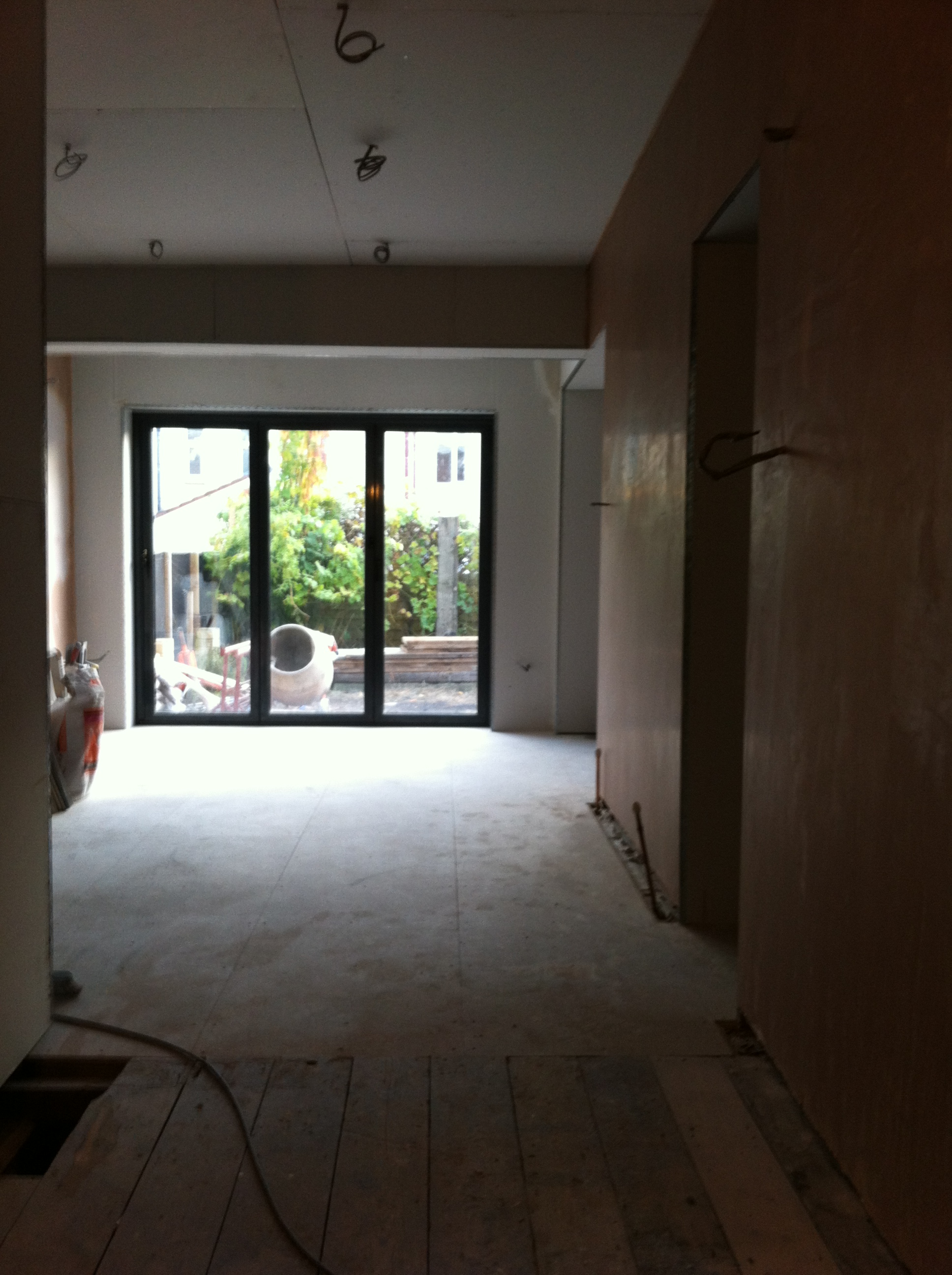

I've just had an extension done and I'm wondering how best to tile the room, I am a novice and haven't tiled before, as if that wasn't hard enough, I am also fitting underfloor heating and dealing with 800mm by 800mm floor tiles.

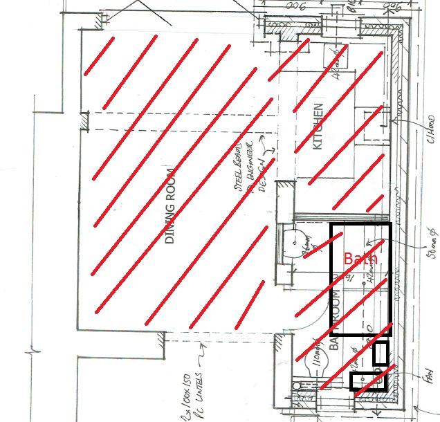

From the attached picture I am looking to tile the red lined areas, I haven’t got any kitchen or bathroom fitted so the floor is completely free for tiling, the only obstacle in my way is the soil pipe in bathroom and a few radiator pipes, I was intending to mark the size of soil pipe on the tile and use an angle grinder to cut the shape out on the tile, would you agree this is the best method? And for the radiators to cut out a square piece and cut the remainder of the small piece of tile to put behind the pipe and use a filler for any gaps?
From the research I have done, a lot of people advise to start from the centre of the room, but because the living room, kitchen, bathroom will all be the same tile and I want it to flow and I wonder if starting from the centre of the living room is really the best idea?
I have been told that it would be a good ideal to use a levelling compound or levelling boards, for the underfloor heating, but It’s a new wood floor fitted with big wooden sheets, which is quite level and underneath that is 100mm in insulation boards, so my plan was to coat the floor in some heatflex which is a primer used to stop heat escape for underfloor heating, then the underfloor heating mats, and then the mapei adhesive recommended for the tile, then the tile and grout as normal.

The Diagnal lines were just to show the area, I want to tile it normally, yeh I know it's not the easiest of jobs but I have run out of money to finance a tiler to be honest.

I'd be setting out from the biggest area, check that you don't have any little slithers to cut in doorways etc.

There's timbers, then insulation between the rafters then big sheets of board screwed down.

Id find the center on the bifolds and work your setting out from there, either grout joint in center of glass or full tile spanning the middle door.
Measure your cut to the long wall, cut them all and work from that wall.

So basically all the cuts should be on the lefthand wall, so you can see full tiles infront of you as you walk in the room, makes sense.
