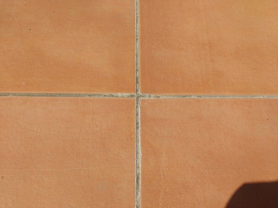

I had not heard of efflorescence before. Having googled it I think that it is the problem. I tried a little 10% acidity white vinegar and I can see the residue bubbling away, just like in the kettle. Attached is a photo after a little cleaning with said vinegar and a view of the grout showing distinct white deposits.
The tiles were laid on a schluter drainage mat and hence it is seeping out of the schluter bara rak edging.
I guess there is little I can do to stop it.
When searching efflorescence a product called ZIDO cropped up. Are you familiar with this or any other cleaning product that you could recommend as i understand that vinegar could possibly damage the tiles.
Many thanks
Image of grout on horizontal
Original stain after 10% vinegar

Oh it's efflorescence for sure then. :)
So the salts in the products used work their way to the surface then pool up.
So washing often will help. Then just deal with the pools of it which will be in the same place all the time.
