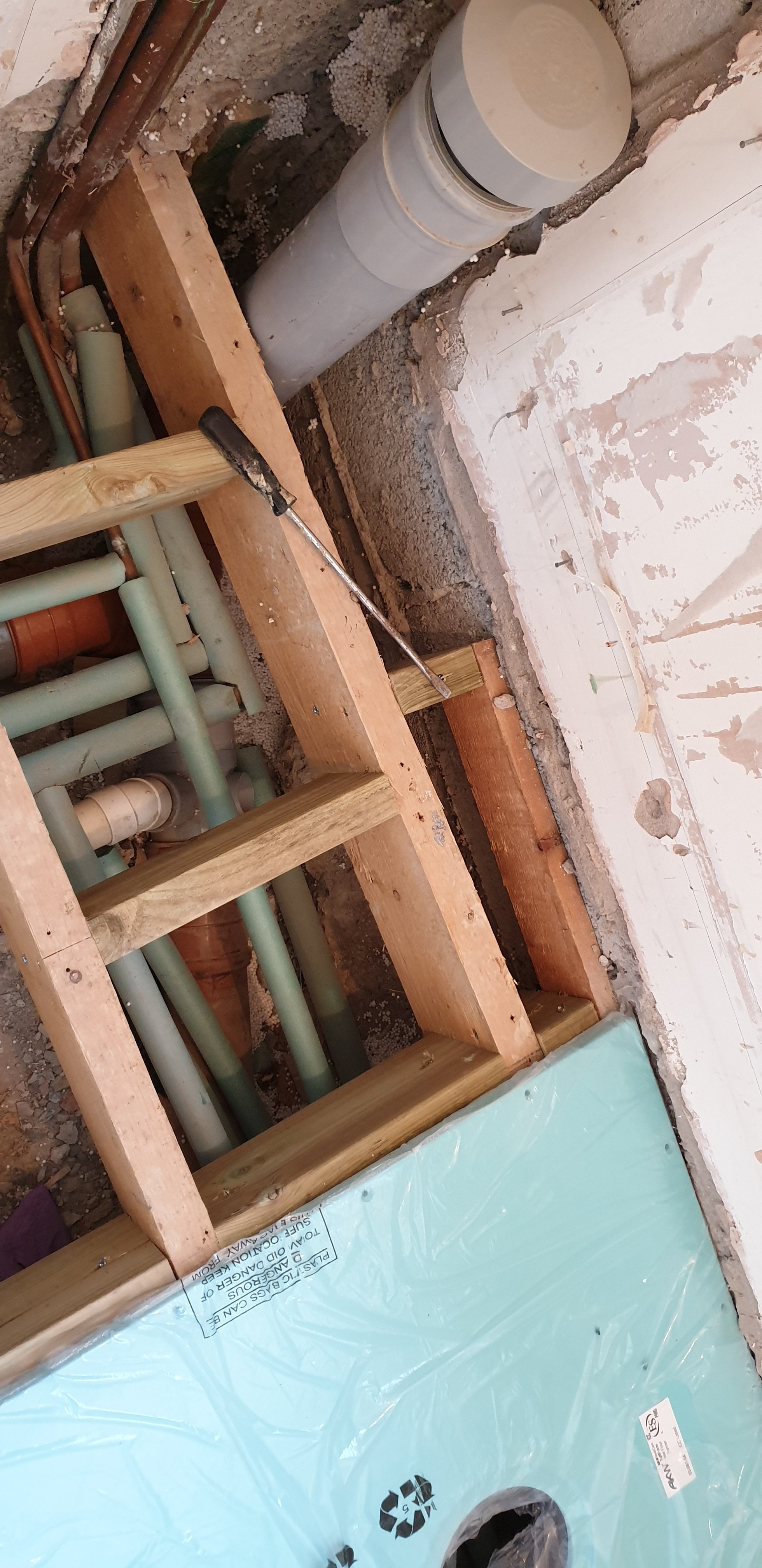

Trying to fit the waste for my former, can anyone advise where I can get the part I need or
What it's called? I'm just trying to connect a 50mm pipe to this 50mm adapter on the soil pipe, but all I can find are reducers?! I can push a 50mm pipe connector on the end but I don't think there's sufficient depth on the outlet to be correct. I'm just trying to mirror what's been done already to the other 50mm outlet.
I'm right in assuming this will be solvent weld I hope?
