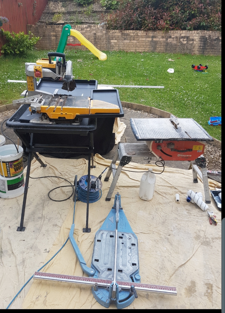

If you can go see the husq in person i would recommend it as it's bigger that it seems and I don't see the benefit of it over a regular decent table saw at half the cost outwith the turf inside to stop the water spray. I have a picture of it but there isn't a regular saw to compare it to. That's just my opinion of course 🤷‍♂️
I should also add that the person that owns it ended up buying another smaller saw due to the size & weight of it!
