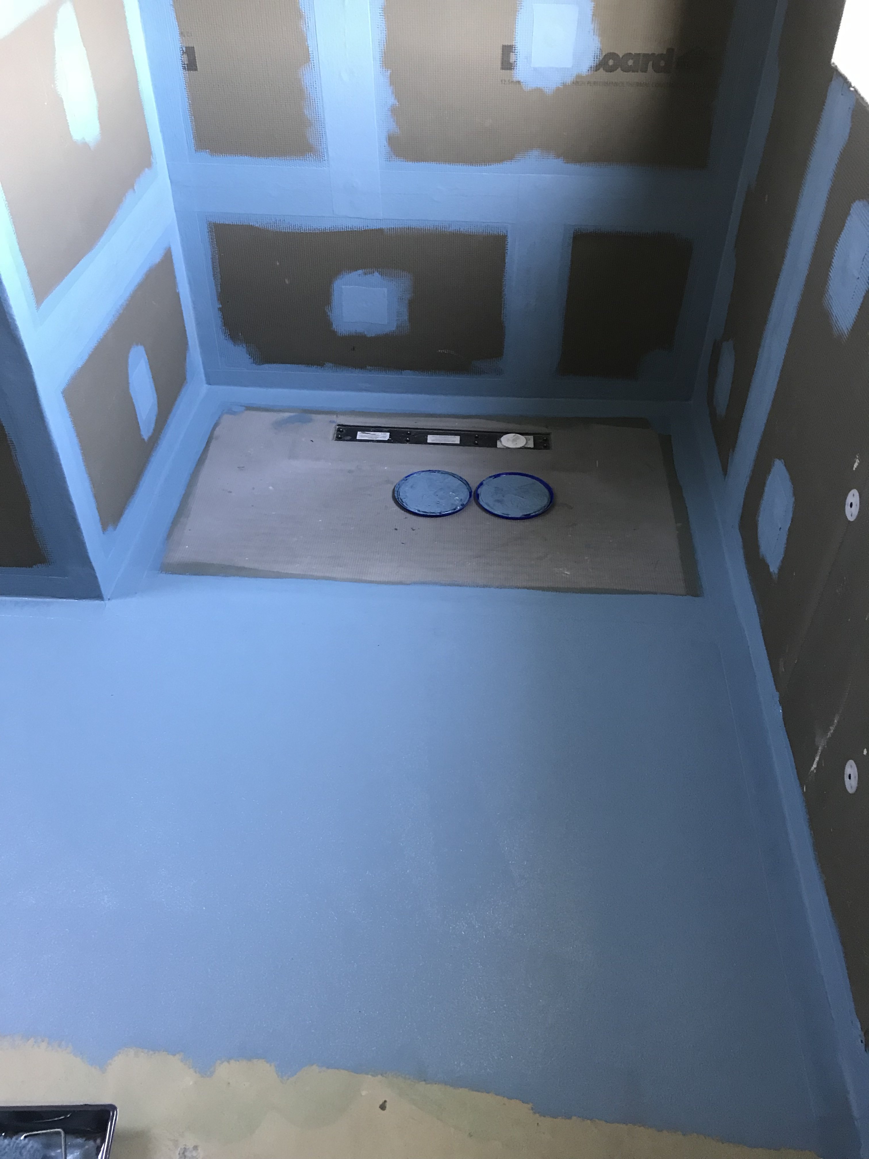

Im looking at installing a wet room with underfloor heating mat and then tilling the full room
Ive had a look at existing posts on here but I am confused by a few points so hope that you fine people will help straiten a few things out.
I will try and keep this as clear as I can
Starting at the top of the joists i have 22mm chipboard floor on top of that.
my thoughts are having a 30mm wet room shower tray former on the floor sat on top of the joists.
then putting 10mm insulation boards onto of the chipboard and screwing it all down
then tanking the room with a tanking kit the rest of the floor will be 2mm higher though
then putting a electric heating mat down (does this go over the shower former or just the surrounding bathroom area floor)
this is where I'm a bit confused.
Do i need to use a self leveling screed to encase the underfloor heating mat ?
if i do then it will flow into the shower area and former and change the level
then tile on top of this
my worries is that if i have the heating mat/screed in the bathroom this will then be higher than the shower tray former so there will be a step down into the shower I want the floor to be one level.
