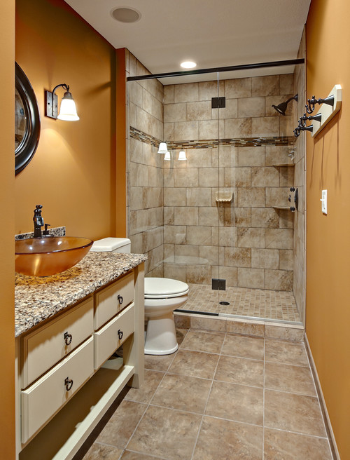

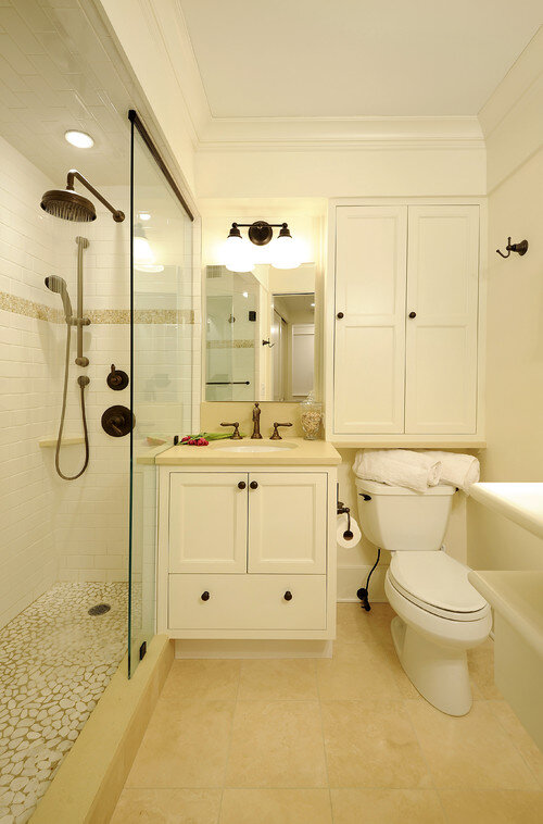

The plan is to build something like this, where there is only 1 glass panel hanging, and a tiled curb on the floor to keep the water inside.

These are the pictures of the stuff that I want to re-create:
