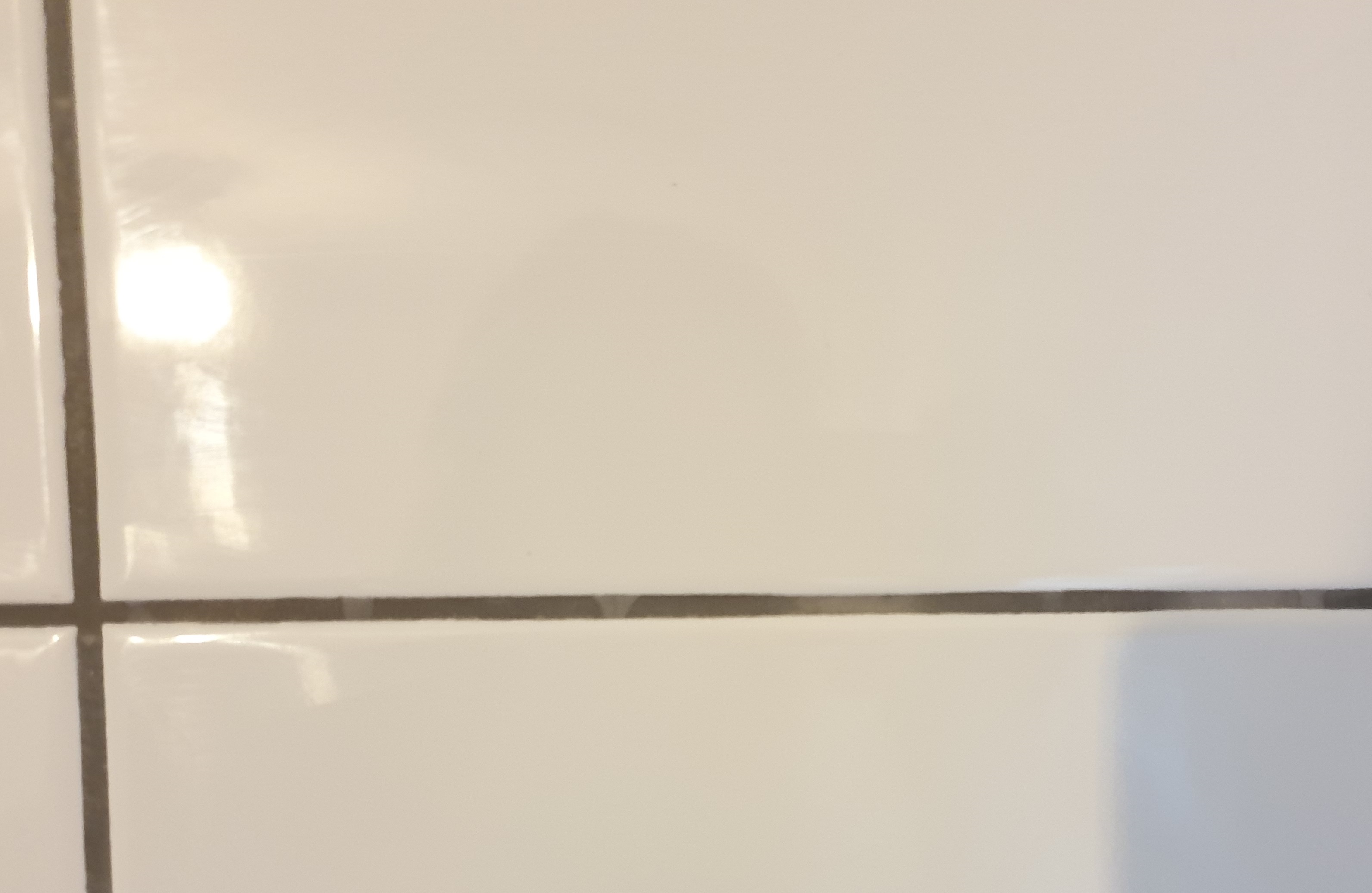

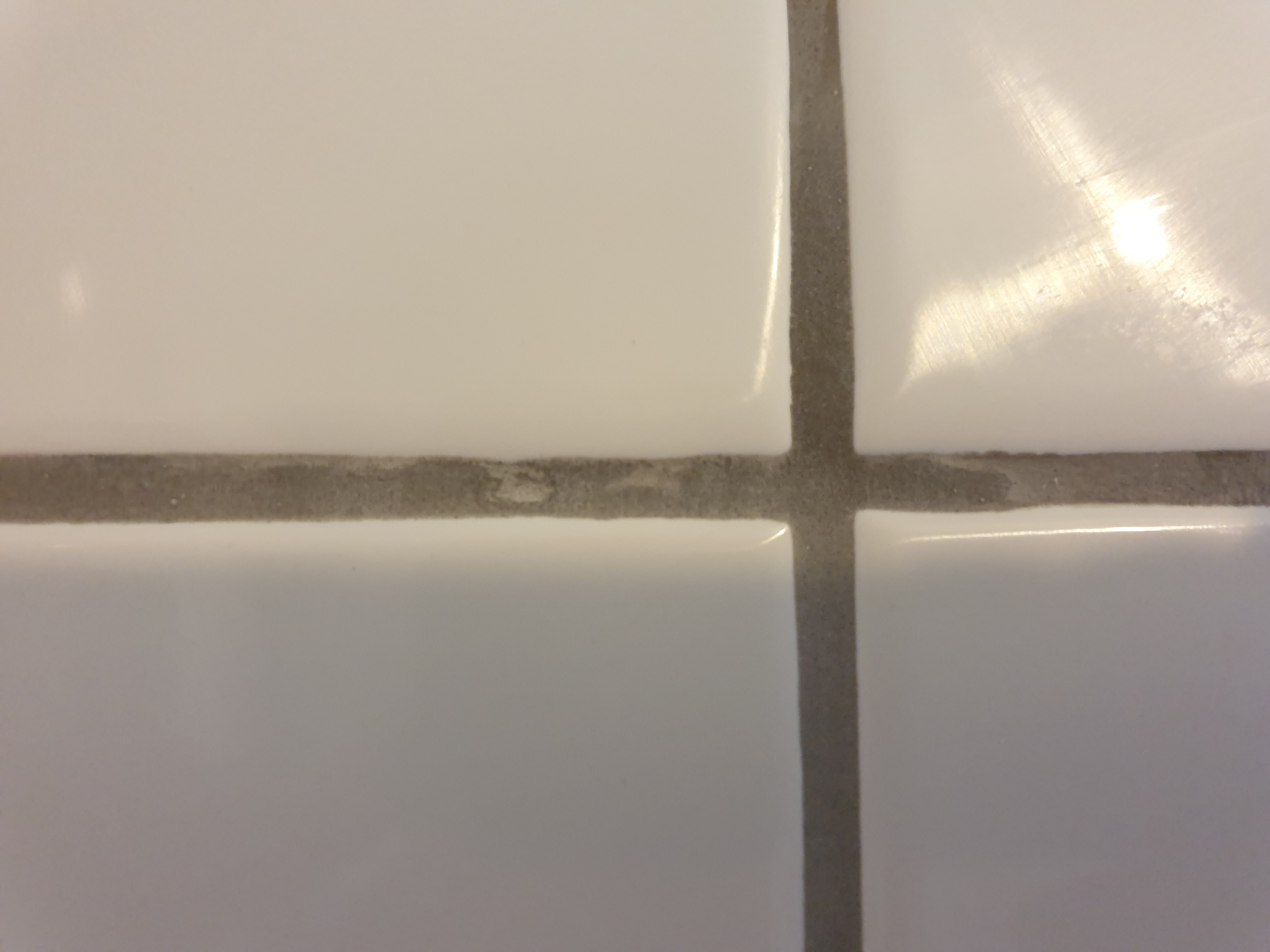

I have recently grouted a bathroom with mapei ultracolour plus manhatten grey grout and have a couple of issues in places. It's the first time I've grouted.
Firstly, after roughly a week of use a few grout lines very near the shower appear to have lost small pieces of grout from the surface:

Looks like it was too wet or had been remixed with more water once it started to set in the bucket.
Just my opinion.
Just my opinion.
Thanks.
I didn't add more water to it, but I did mix a second lot without completely cleaning the bucket so grout from the first lot could have got mixed back into the second lot.

Try mixing a little bit and going over those spots and then give it a few days to see if it clears up?
Failing that; wait for an actual tiler to comment :)
A bit of fine sand paper folded over to create a ‘sharp’ edge over the affected areas , just to remove the surface layer can often reveal a more consistent colour. Good luck
Thank you both for your replies. I tried the sandpaper over the darker areas and it improved the appearance.
