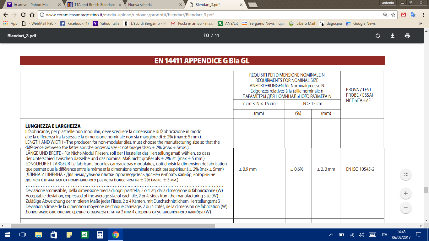

Italy
you are right.
the question you should turn to the manufacturer?
if they were writing that the nominal size was 595x595
everything was ok.
