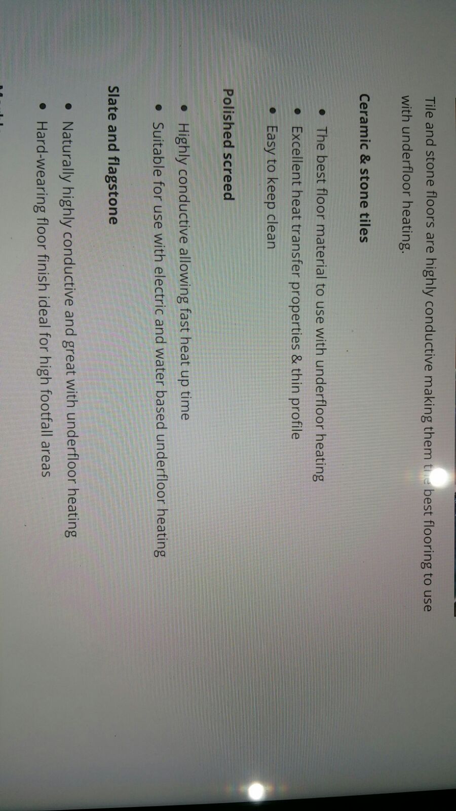

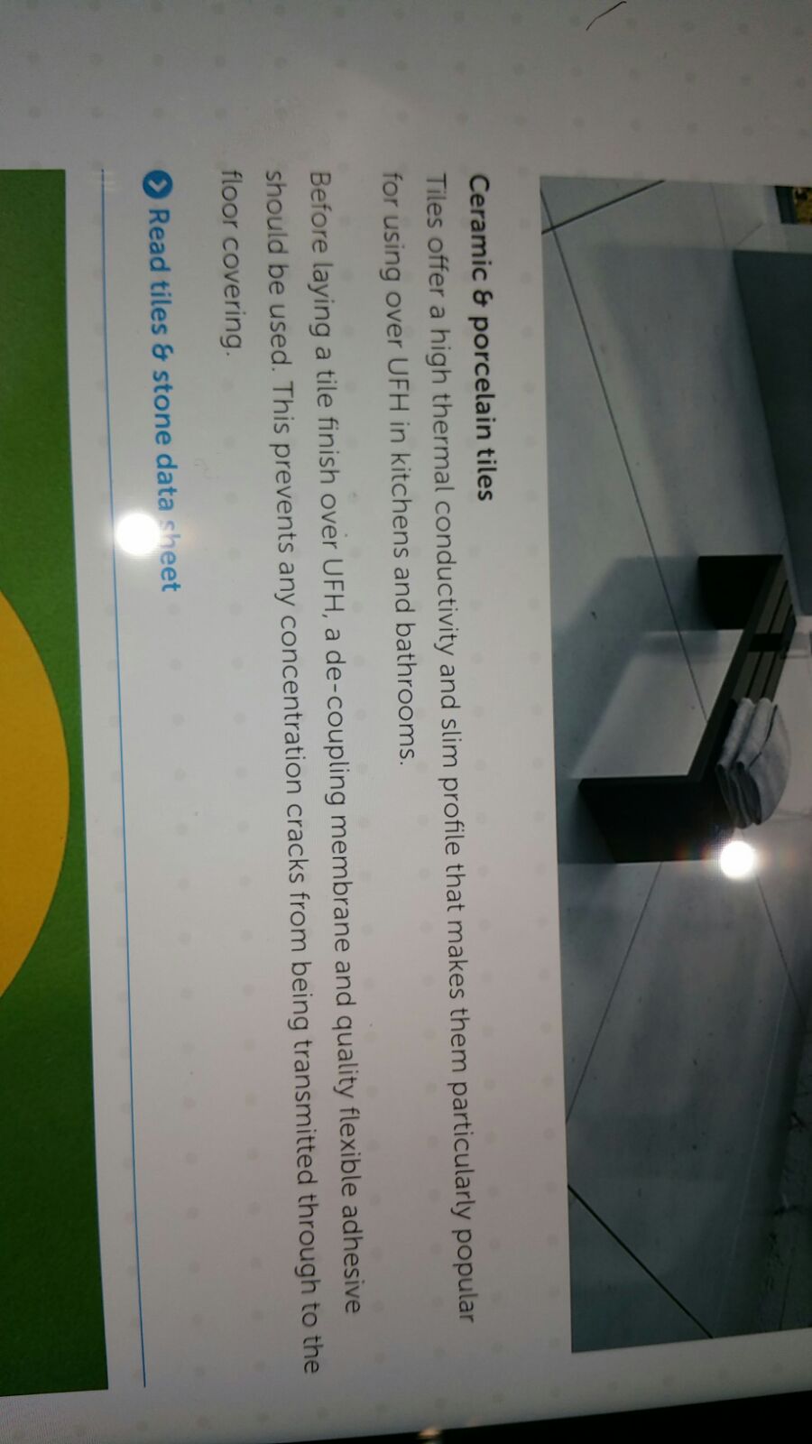

I’ve tried reasoning with the interior designer and he’s adamant that is what’s being used, he was even sending me screenshots of bct website saying it’s ok to use with ufh with de coupler.
The job is a good client of his as well.
All the materials been supplied by topps o_O.

Oh do it is ok when some other p.o. suggests that bct tiles are poor but if I do it then it is nonsense.... well go ahead and take my highly fantastical advice with a pinch of salt.
This is what he sent me and he said he’s speaking to the rep on Monday.
