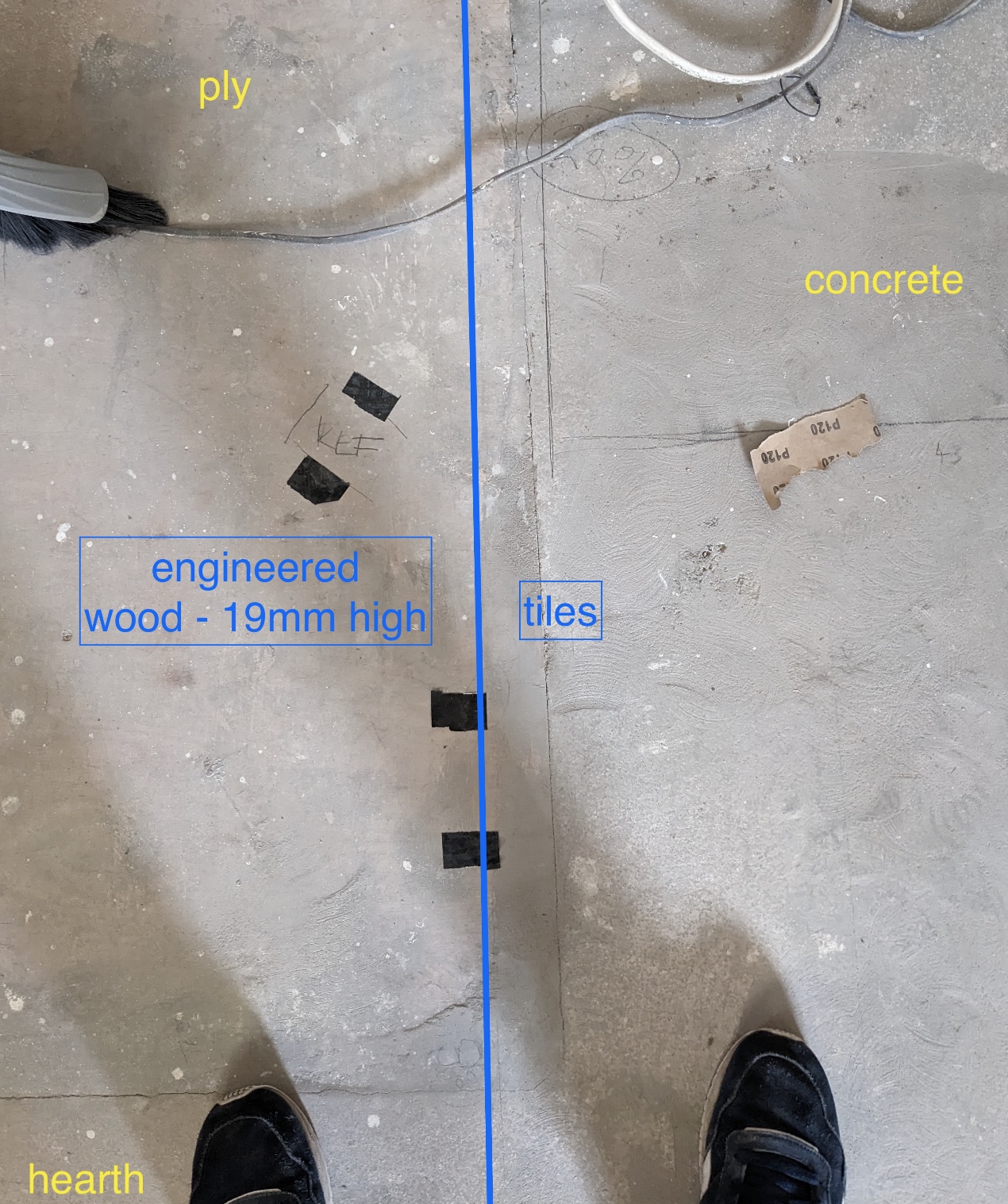

I'm embarking on tiling a kitchen, wall-to-wall (under washing machine etc). most of the floor is concrete/screed, but there's a 2" overlap onto both 18mm ply, and also an old hearth which is not connected to concrete slab. kitchen install is in 10 days time..

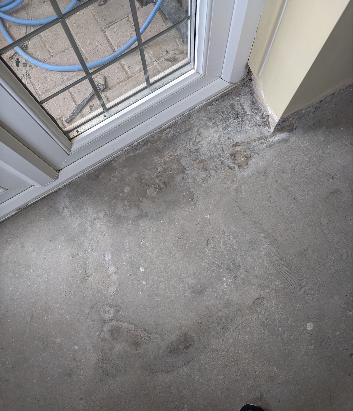

there was a failed attempt to level/flat the floor previously, some parts took well over a week to dry. some small patches still not dry, but the builder is saying it's ok - pictured. the builder said it wasn't a problem.

2. there is about 2 inches overlap on to ply substrate, and another section of concrete hearth which isn't attached to the rest of the floor concrete
