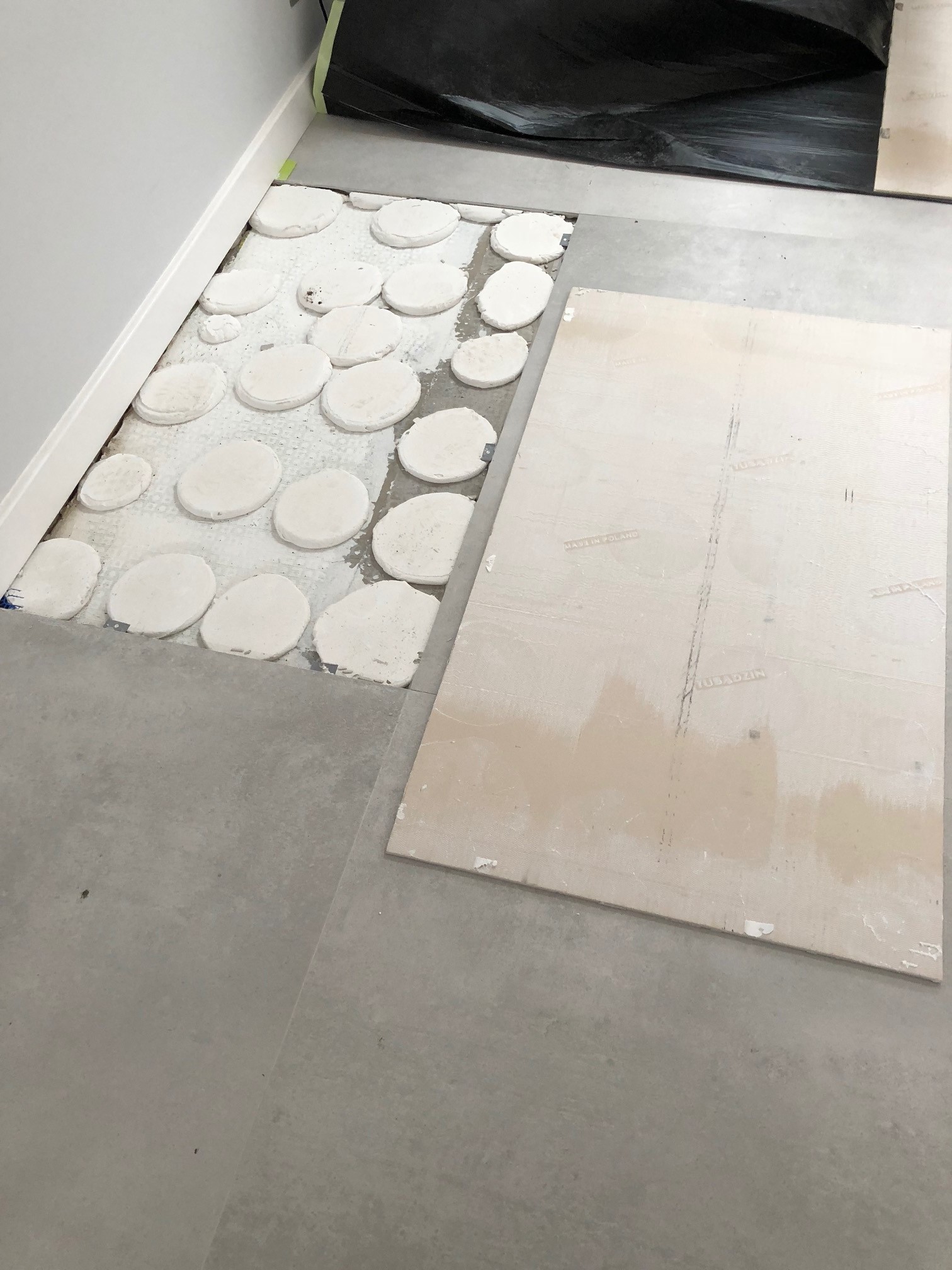

Reading a previous thread I feel that there is hope for my situation. The names listed below are from contributors of the old thread, that is the only reason they are mentioned. Thank you.
@Localtiler, @3_fall , @jcrtiling - Guys I'm in desperate need for some PROFESSIONAL advice. I've saved for 10yrs to get my family home extended... I've had no house now for just under a year with 2 young children. This has literally broken me, so any advice would be massively appreciated.
I've had the wunda EPS 400 install to the whole of my downstairs as I have a 120 X 120 - 6mm ceramic tile laid. 1 month ago the floor protection was finally removed as my was kitchen installed. After waiting a whole year for this moment... I walked into a nightmare! A number of tiles have blow and all felt hollow. They have dot and dabbed my whole floor! After 4 week battling between my kitchen company (Tillers) builder (floor prep) I have finally got the kitchen company to agree to fix it... now I want it done properly!
Tilling: They used an adhesive to stick down a ditra matting directly on top of the boards before dotting and dabbing the tiles to get them level as the house is sloping by 30-40cm. Bal adhesive from Topps tiles. Very wrong!!!
Floor prep: The builder glued the boards directly onto the concrete floor (extension) and the existing wooden floor boards. No levelling at and the existing wooden floor area has movement when standing on it.
My question to you guys - The Kitchen company recommend removing the tiles and as much of the adhesive and then screeding it level - Reading this thread this doesn't seem right but will this work?
Or would you advice to remove the UFH and start again?
For both option do you have any experience with how you would do it?
Do either of you do consultancy work and would be interested in helping me I'd be happy to compensate you for your time. I'm in south east London.

Ok an update... the builder said the extension flooring area is chipboard and not concrete (least the whole downstairs is the same material)... and tested it with a laser level - The floor is only 15mm out over a 80m2 area (measuring from the surface of the ditra matting/ not the top of the dabs). The tiller used a large level to try and get the floor ask accurate as possible (not a laser level) hence them trying to build the levels using the dab method.
They are aiming to take all the tiles back up. Chip away the Dot and dabs and the use a 5-10mm self levelling screed on top of the ditra matting before tilling again.
I get this is not the correct way to do but can anyone advise if using Bal screed will stick on top of the ditra matting ok and then using bal flexible adhesive will work?
Some pictures... I hope this will help other out in the future...IMG_4739.jpg IMG_4740.jpg

What a mess!!! 10mm on top of ditra very risky! As you remove the dots i bet you will pull at the matting making it debond.. i wouldn't mess about i would rip the lot up!
D
Dumbo
Just splitting hairs but that ditra matting looks like dural durabase

As above, you've paid for a proper job, that's what you should get. They're offering a solution which saves them money, but I don't think would last. Layering up leveler into old adhesive is not ideal and it will negate the properties of the durabase (cheap ditra alternative).
I can see the thinking behind the proposal but who's going to guarantee it?

Thank you all very much for your advice. Just call them, yes this is Dural. I've got a better chance of winning the lottery than getting them to agree to pulling this up and relay it!
D
Dumbo
Dural not a problem used loads of it without comebacks . It's just that if they quoted and charged schluter ditra price then fixed dural with different price point

The only positive is that it looks like the adhesive hasn't bonded to the tile at all so you could probably reuse them!

I would however be more concerned about the movement you mentioned originally.
The chances of removing adhesive from the Dural matting are slim to none without destroying it. It’s not like ditra where you can chip it clear. It’s covered with a mesh that doesn’t let go.
Apart from a little difficult to use at times it’s a decent product.
These overlay ufh systems are designed to be laid to flat, sound, load bearing substrate.
It doesn’t sound as if your original floor was up to standard if there’s movement and bounce.
Your floor should have been levelled prior the install of ufh.
Levelling over the top will now impact the efficiency of your floor and you may find some areas warmer to the touch than others, especially if it’s different thicknesses of leveller everywhere.
There are other issues attached to Wundafloor, it has an aluminium covering, this foil can react with Portland cement and is supposed to be tiled in a very specific manner, in fact most I know, won’t even tile it at all.
There is a product now sold by Wundatrade, which is a 4mm backer board designed to be stuck over underfloor to negate the chemical reaction between aluminium and Portland cement.
https://www.wundatrade.co.uk/shop/home/accessories/tools-accessories-2/4mm-backer-board/
Have you checked to see if the Dural is actually stuck to the ufh still?
