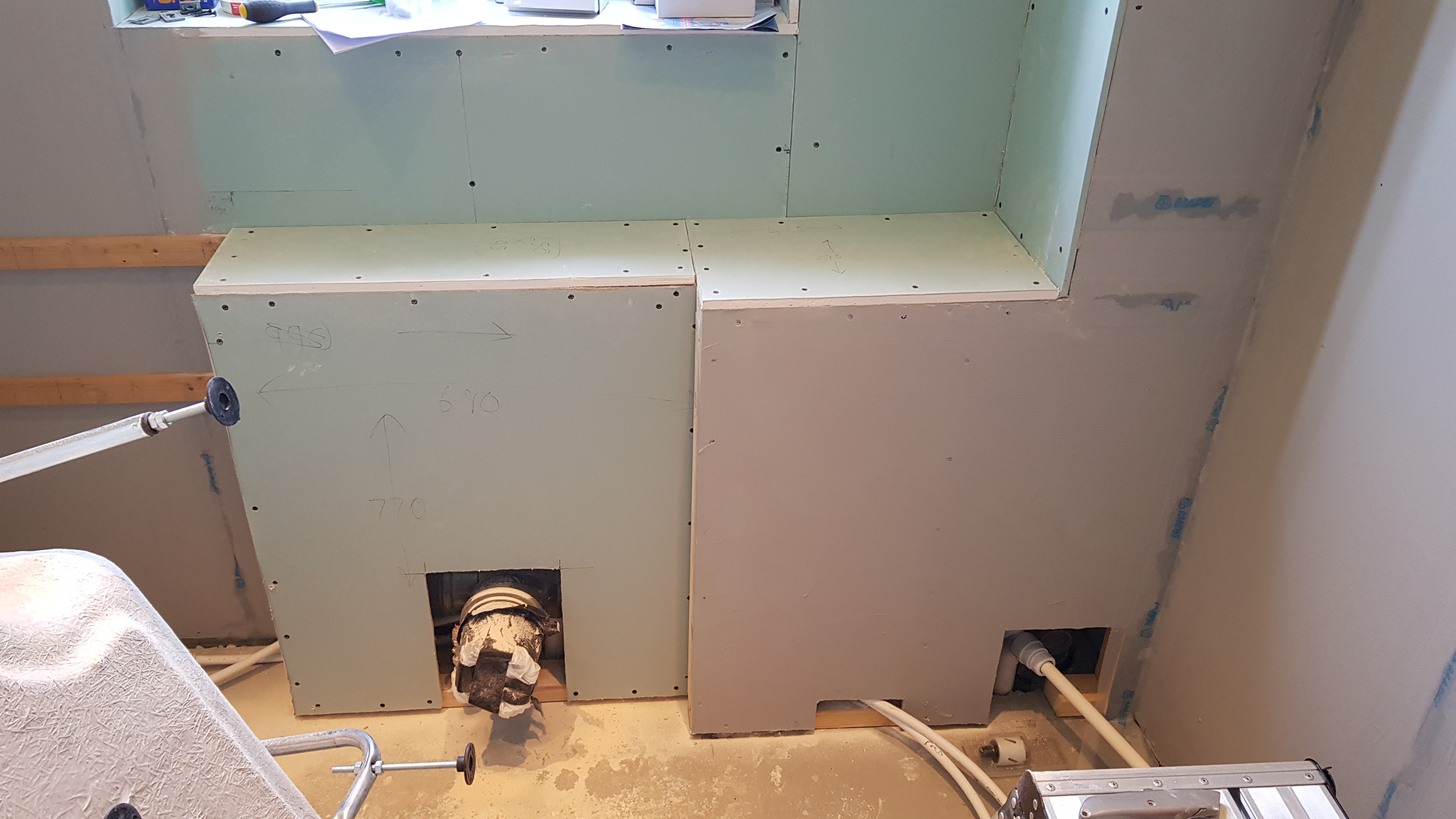

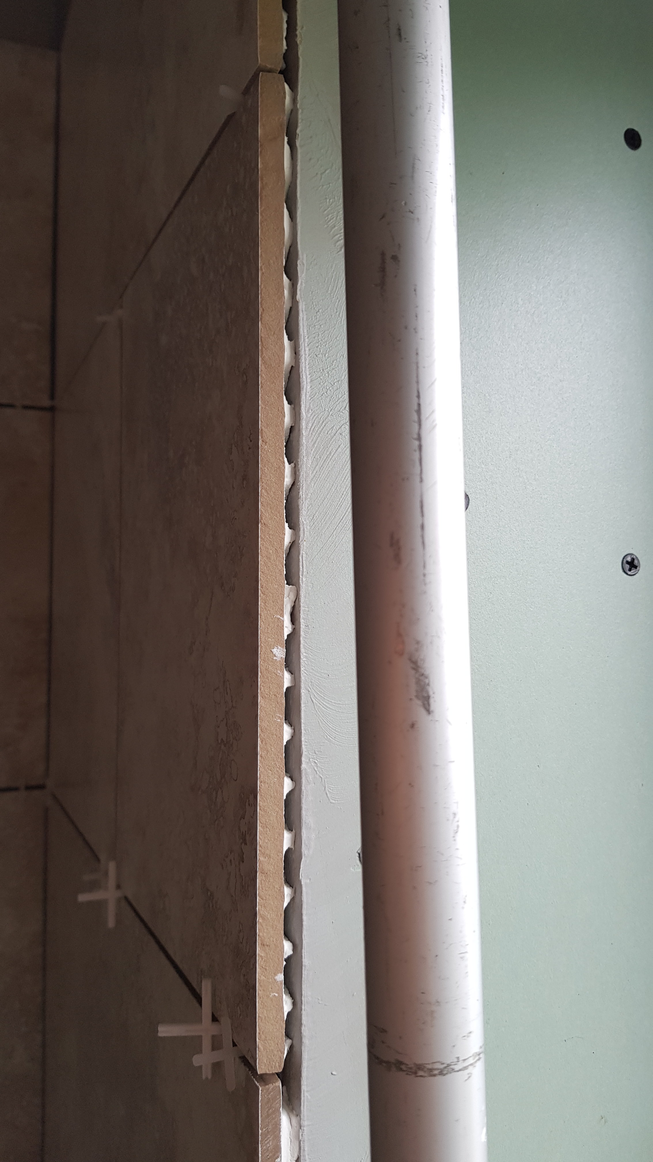

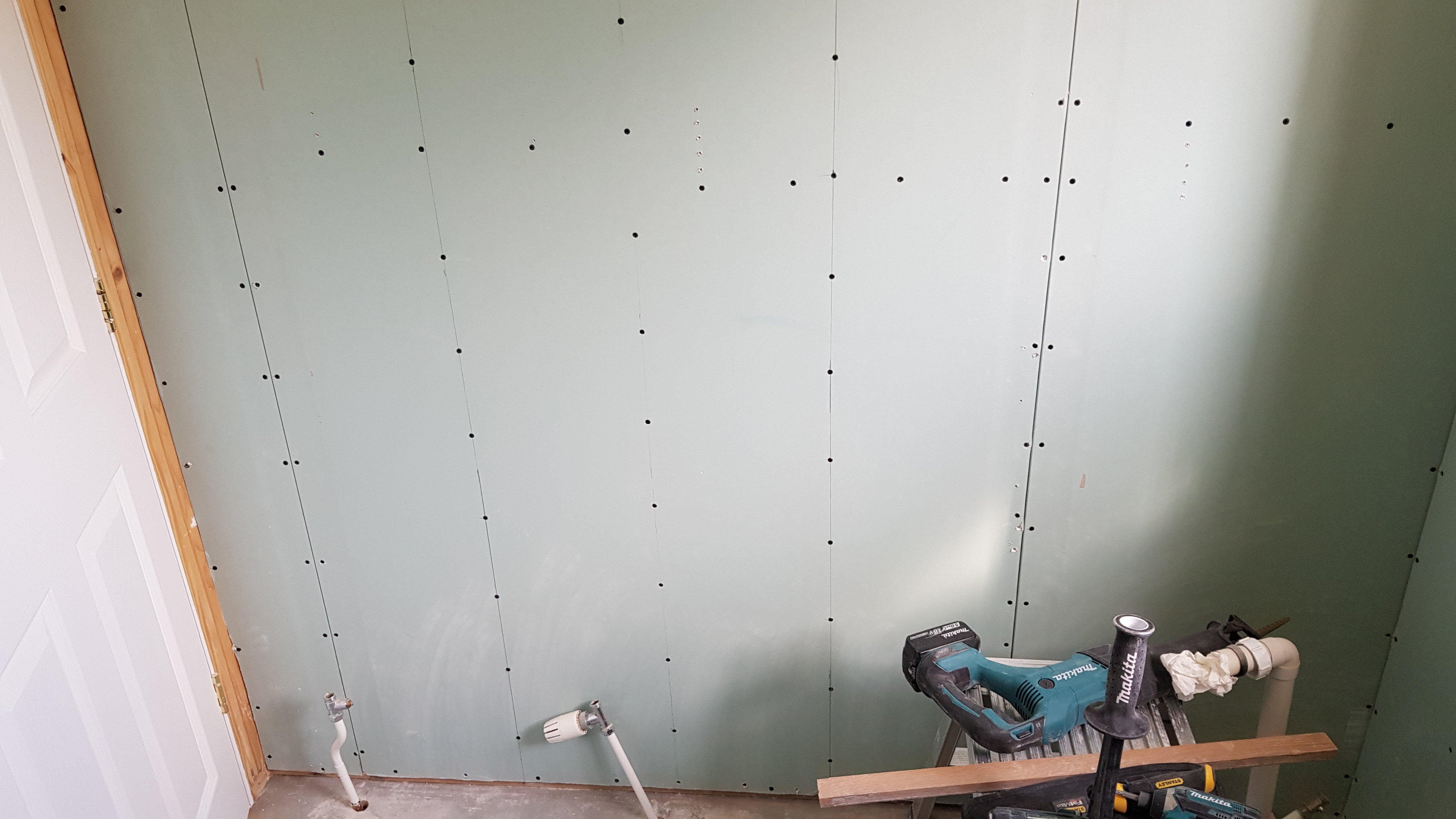

Well, as promised, here are some pics. Had to unexpectedly put extra studs in too as the spacing was too wide according to Knauff's spec (even though it had worked up til now; rather be sure than the walls fall down).

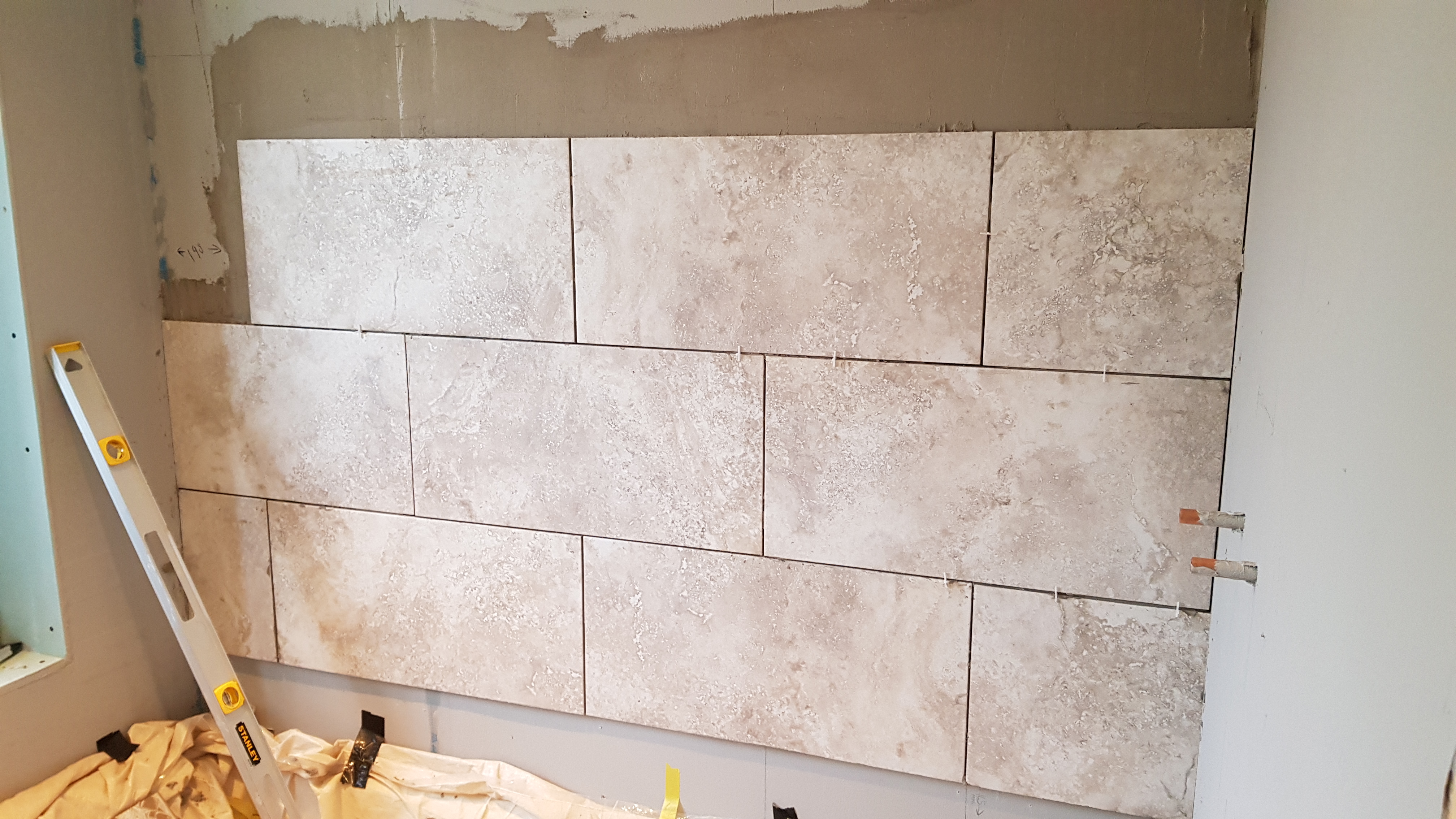

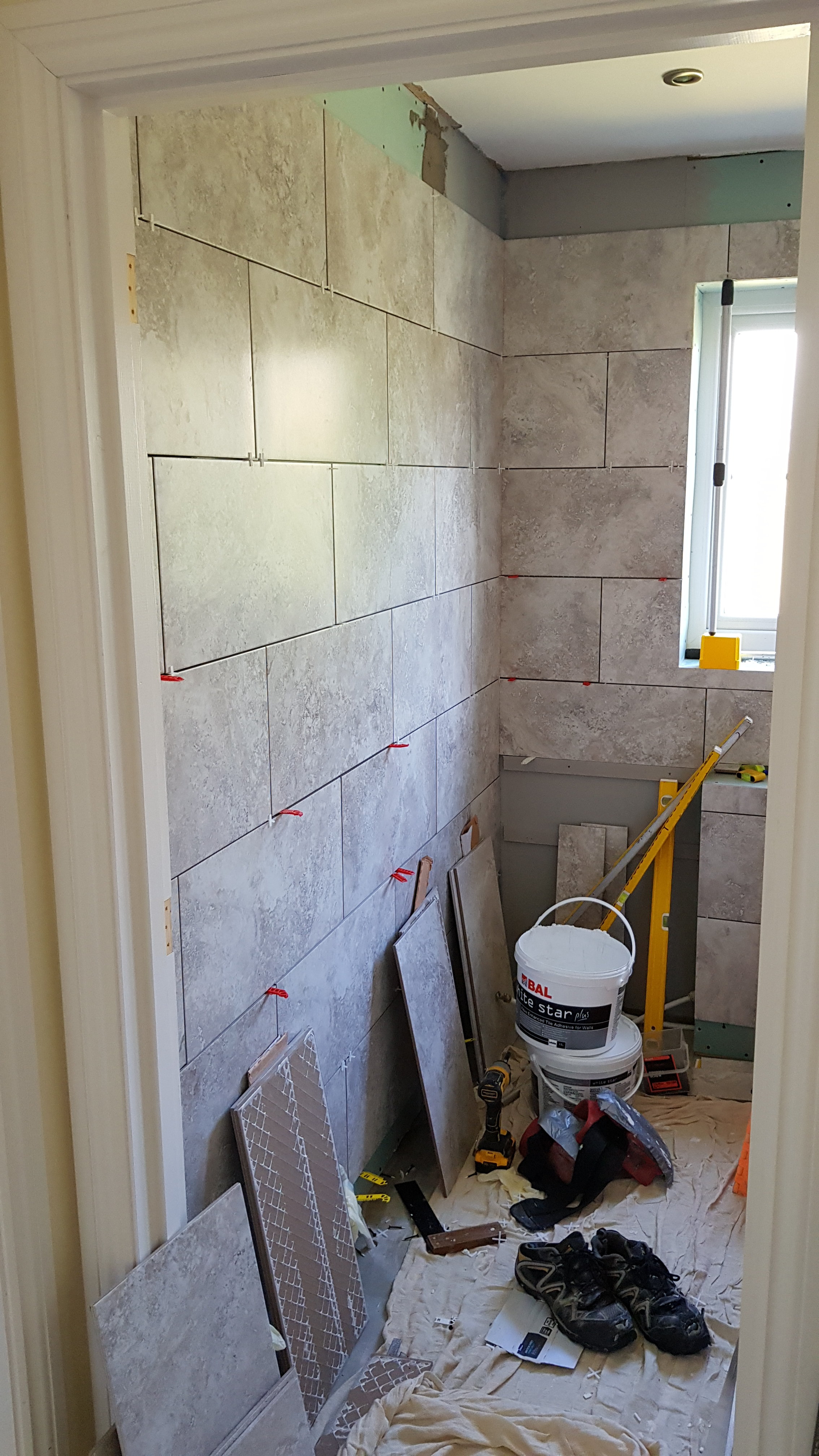

Started on the tile too but can't say it's enjoyable yet. We've gone brickbond pattern with 600x300 porcelain and that's fine but im struggling to get the tiles to stay flush with each other using 10mm notch and back buttering :persevere: Walls are mostly flat/not much variation in them either.

Judge away!
Don't be too harsh though, this is the first big tile job I've undertaken!
Cheers, Chris
Boggs
4,729
Looks ok so far :)
Better prep than other jobs I have seen today.

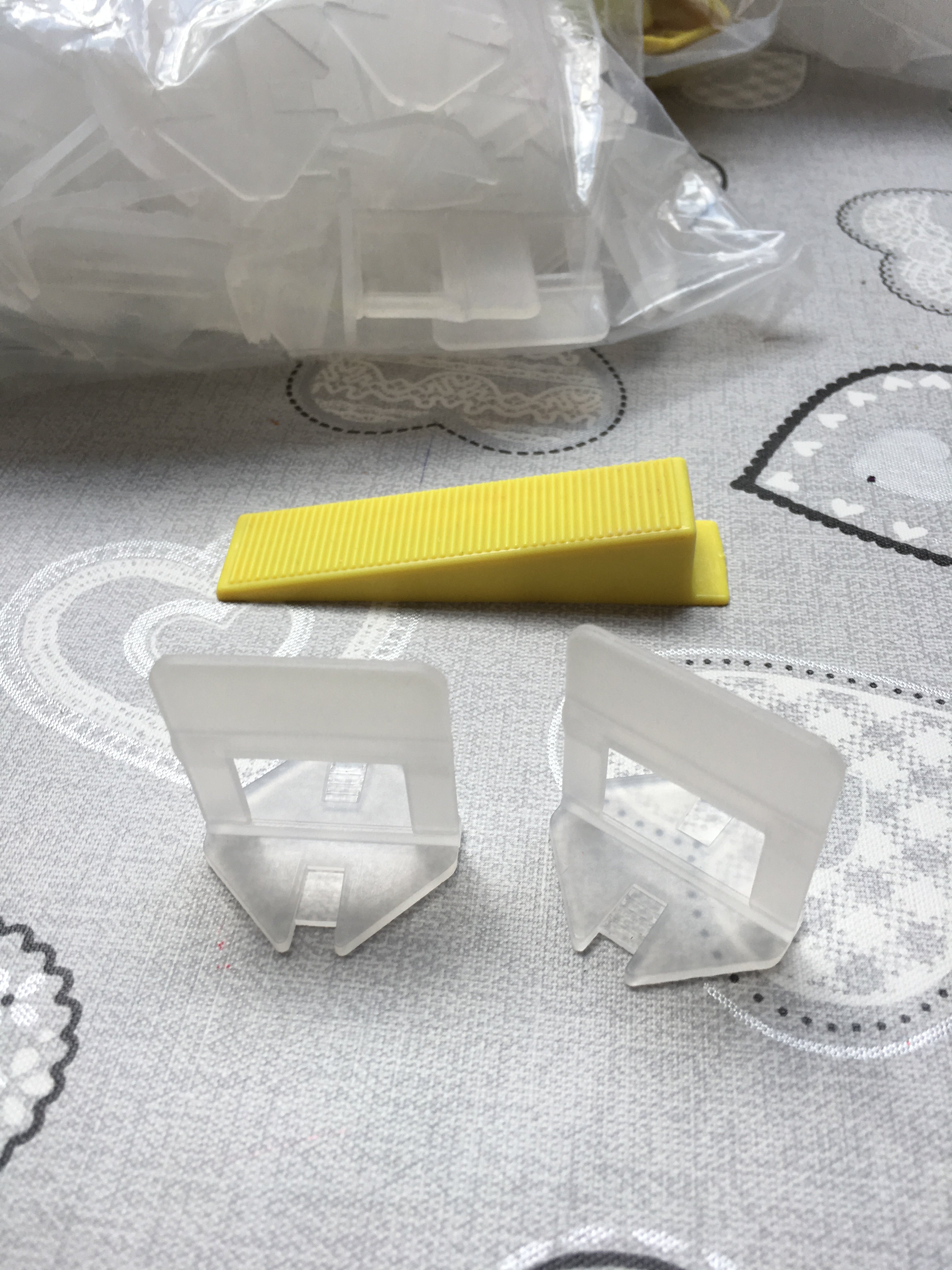

Check the tiles for flatness by laying them face to face, if they are out you could try using levelling clips, like these
Cheap enough on eBay and should help a bit.
U
Unused Account 1
Cheaper tiles normally bowed so hard to do brickbond ,looked at a job today ,the client wanted brickbond,i showed him the bow in the tiles,and now back to stacked,brickbond bit old fashioned these days ,im doing more stacked ,bit more modern

Bit the bullet and got a tiler in to finish the rest of the job off as I wasn't happy with the tile I was doing and also started to run out of time.

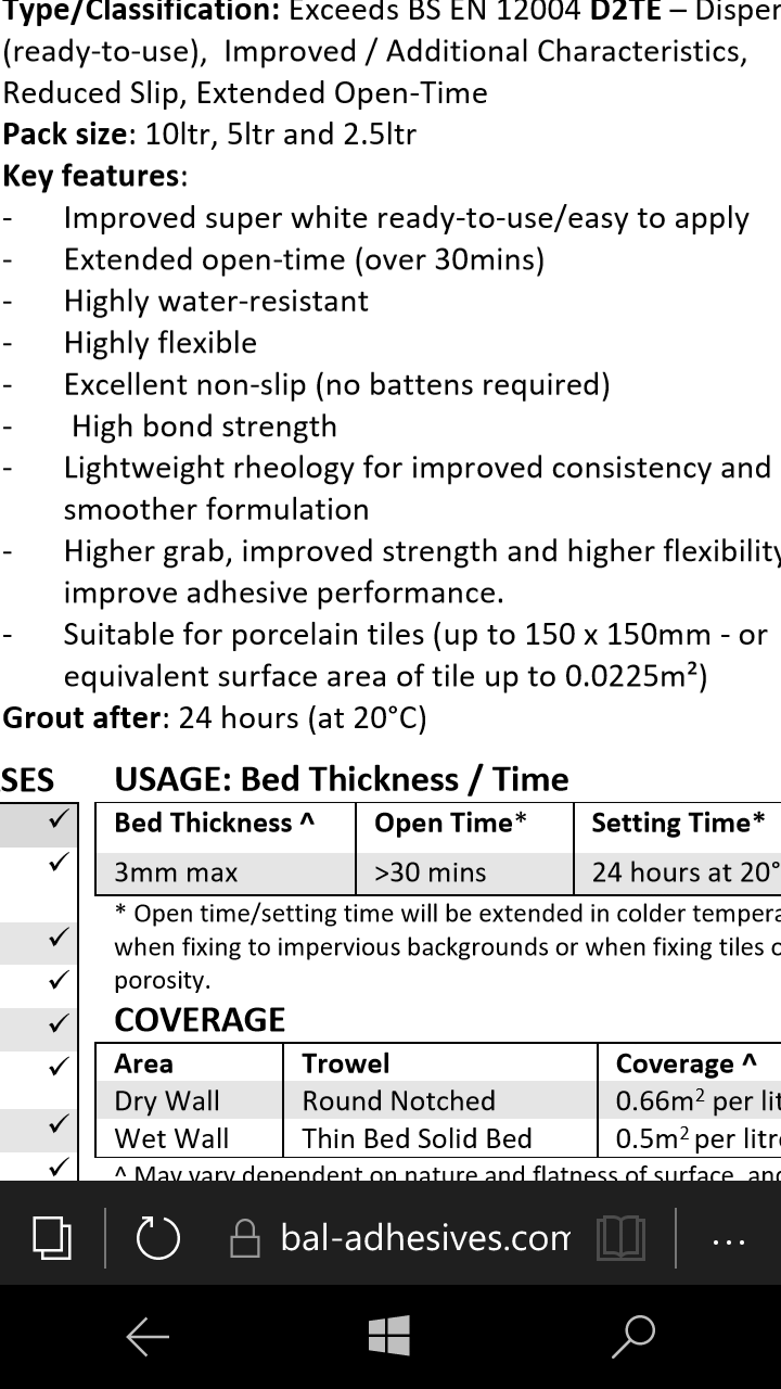

Anyway, to the point... The tiler I've got in comes recommended on the normal UK review websites (won't list them obvs) and is a member of The tile Association so all looks good there. Nice bloke too and the work he's done so far I'm really happy with... BUT he has been using BAL White Star Plus ready-mix adheasive to put the tiles up after priming any non-tanked walls (tiles are 9mm thick, Wickes (nothing too fancy), 600x300 tiles which are porcelain according to pack).
My worry is that the BAL data sheet says for that adheasive says no tiles (of any kind) bigger than 600x150.
Also, all I'd read was that cement based adheasive should be used for that tile type (which is what I'd used to do some tiles earlier before stopping).
I guess I'm looking for some sort of reassurance as this has got me stressed out. I have zero reasons to be concerned with his work other than that datasheet... I'm obviously going to speak to him about it when he's next in too!
P.S. It feels a bit late now anyway as the room is mostly done (bar last few rows and grouting etc).
Thanks in advance, Chris
There will be trouble ahead!
Ready mixed no bigger than 30x30 and certainly not porcelain.
