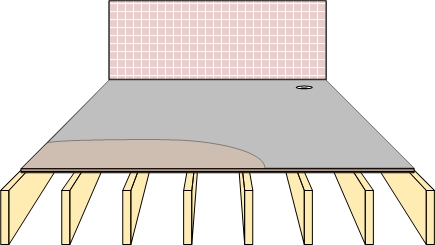

A bit of an odd question I'm guessing. I have a floor that needs tiling, the existing construction is 20mm plywood on joists which has been clad with 1.2mm stainless steel sheets. The existing construction is solid and stable with very little flex but I need to tile it.
The stainless cladding is basically a pan, it has 50mm edges and it's glued to the ply with a drain toward one corner. The existing setup is waterproof so I didn't really want to remove it which would also damage the top lamination of the plywood.

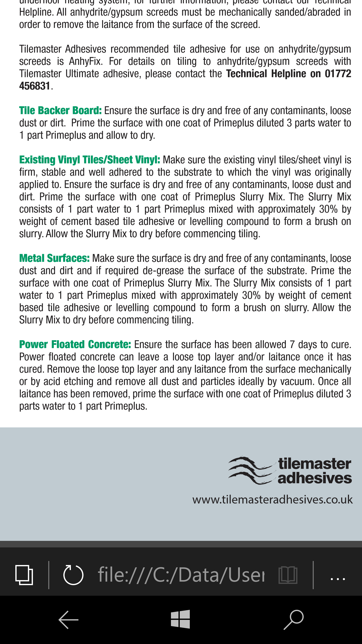

isn't it what is used to prime / treat the metal prior to fix with adhesive which is the important bit?
ultimate S2 straight on metal not right
J Sid
as I said it's how the metal is treated before the adhesive is used wp_ss_20160518_0001.png not saying it's not good stuff, just saying it only part of the process needed ;)
