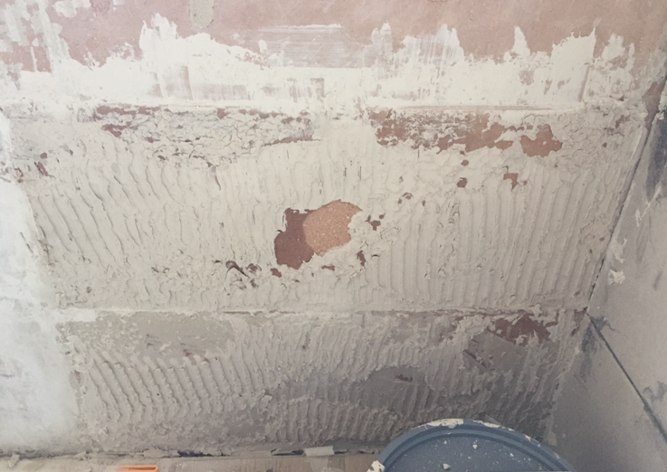

Hi,
I hope someone can explain where I am going wrong (also the grief I'm getting from my wife is amazing.), I seem to be having massive problems getting tiles (20cm by 50cm)to stick to a plaster wall, I have tried Mapei Ultimate Shower Proof and Mapei Ultimate Supergrab, this is the order of things have been so far
Plaster Wall:-
Mapei Ultimate Shower Proof: Tiles came off after 2 days, as Tile https://www.tilersforums.com/forums/tile-adhesive/ was damp
PVA'ed the wall, use Mapei Ultimate Supergrab: Tiles came off after 2 days, as Tile https://www.tilersforums.com/forums/tile-adhesive/ was damp
Sugar Soaped the walls, allowed to dry, then used Mapei Plaster Primer allowed to dry, used Mapei Ultimate Supergrab: Tiles came off after 3 days, as Tile https://www.tilersforums.com/forums/tile-adhesive/ was damp.
I have included a pic, of the wall so hopefully that might explain better.
From the picture, I can see that i have not had good grab, but the Tile https://www.tilersforums.com/forums/tile-adhesive/ was all damp
Also can I reuse the tiles , as i have scraped the damp plaster off?
Any tips, tricks gratefully received, I need to earn my "man card" back in the eyes of the wife,
Thanks for looking
