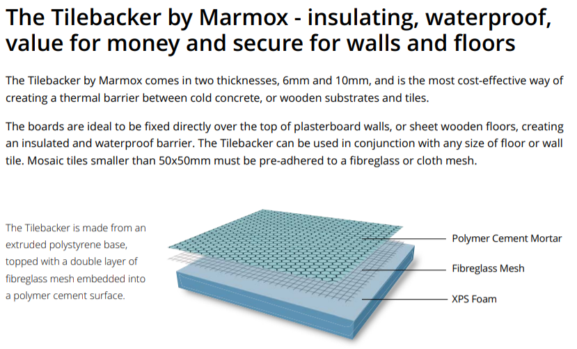

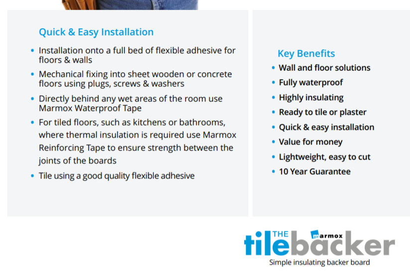

Yes, exactly. That was my plan. The point is when I've spoken with a marmox guy he said that I can't do this like this as there's no full bed of adhesive between the pb and solid wall and there will be no warranty whatsoever on such an installation. And installing screws with washers won't help. That way I went here to seek advice from tilers. I'd like to use Marmox' The Tilebacker - the one with mesh only on one side. Based on info from their leaflet that should work.

Interesting, I'd like to know the reason for that. If you think about it there is not a solid bed of PB adhesive behind PB on a stud wall either, you obviously have the voids between the studs.
So with your dot and dab PB if you fixed rows of screws and washers at 400mm centres and at the tiling board edges is it any different to fixing to a stud wall. If the PB has been installed correctly in the first place it should have rows of dabs at 400 centres and around the perimeter anyway.

That was my way of thinking either! When I asked marmox guy what will be the weakest point of the sandwich created on the wall he said ... "screws". Because part of the screw won't be fully embedded in any material (he meant that gap between solid wall and plasterboard). I'm not too sure what to do next.
