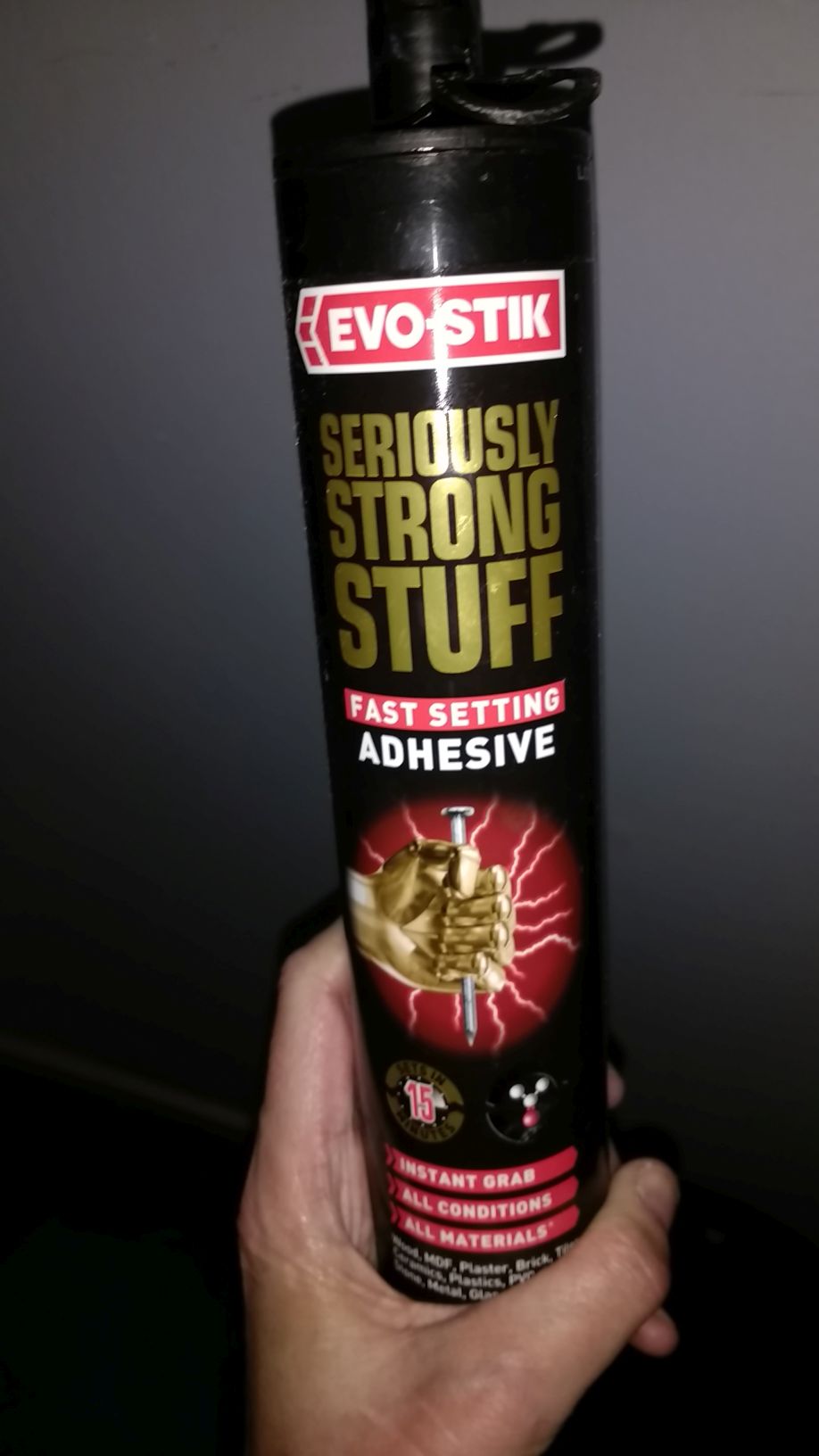

Sounds like Silicon!!! Got a picture if the evo stik product?
Yeah, here it is, says its suitable for tiles. I just squirted a little circle of it in the middle of the tile and the tiles are now stuck harder to the wall than ever. I left a 1 inch gap so that the glue would not squirt out of the sides of the tiles, as I need to grout them tomorrow.
See below, have I done the right thing?

Not really the way it's done to be honest. But it's done now. Just grout it tomorrow.

Not really the way it's done, can you elaborate where I went wrong please?
1)Is it likely to damage the gypsum plaster? (IMPORTANT)
2) Did I leave too large a gap - should i have put glue closer to the edge?
2)Even though they seem stuck fast, are they likely to fall off?
3)I'm using unibond tile grout suitable for kitchens and bathrooms.
No it's fine don't worry about it.
You usually tile with tile adhesive and grout with tile grout though.
Thanks for speedy reply, just used evo cos it was only three tiles.
Will the evo stik damage the gypsum, like have a chemical reaction to it?
It seems stuck fast and secure at the moment, but worried it may loosen in future?
Is unibond grout ok?
PS I left the granfix primer on, but only one neat coat on top of a weak 1 part granflix to 3 parts water.
