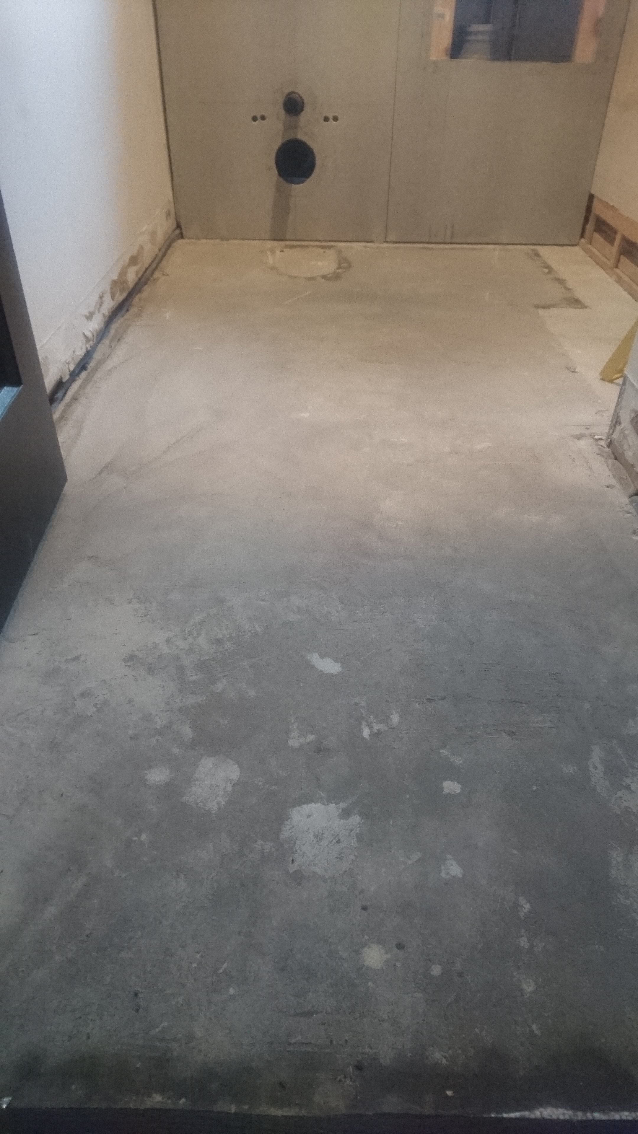

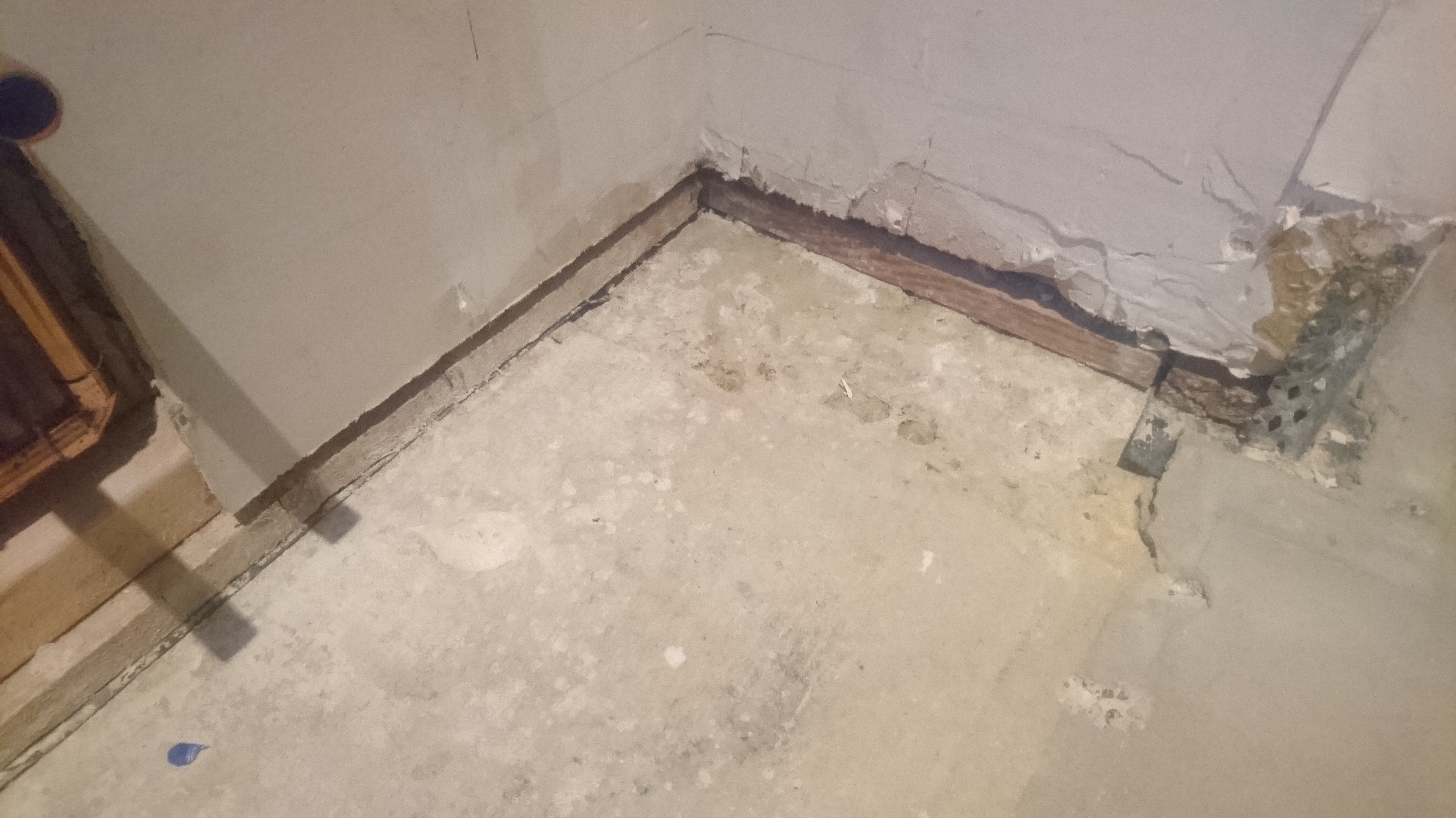

Here's a couple of pics.
The floor has a few areas that are slightly uneven by around 2mm at most.
Would i be able to use additional adhesive and back butter the tiles to fill out any uneveness or am i better off self leveling the floor first?
WetSaw
That deep hole in the corner will need filling, hard to tell how deep it is from the photo. The rest of the floor just use primer before tiling. The paint needs to come off the walls.

Thanks for.the reply
That uneven bit in the corner is about 8mm deep.
Would you use self leveling screed to fill that in?
Also what type of primer should i use on the floor?
Spare Tool
For what it is might as well get a bag of leveler and fill all the dips in, got to mix a full bag up so might as well use it, just pour and pull a straight edge over the floor... Try and stick with the same reputable brand throughout, so prime with the same manufacturer as your leveler and adhesive..
