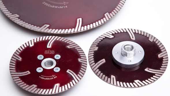

Looking for some recommendations on a good blade for my grinder. Used for a stone job I have coming up 20mm thick (Jaipur brushed) is the name of the stone
Spare Tool
Used the ATS flush cut vanity blade last week and found it excellent...

No need to go bigger, have a look at the new dewalt grinder, I've had one about a month now, it's 1100watts will fly through anything with a decent blade on
I was thinking blade depth more than power as my grinder has an effective depth of 30mm . I know that is enough but thought it might be easier with a larger diameter blade .

Fair enough @jcrtiling I usually just have the blade only slightly out of thw bottom of the cut as I cut flat on a bench now so didn't really think of the depth issue, plus I'm just not a fan of the 9 inch and will only use if absolutely necessary
Dumbo
Do you know I hate to be pedantic but I was actually thinking 7". I agree on 9" it is a bitof a beast .
9 inch is a beast but it's got the balls to cut thick stone with ease. Probably twice as fast as using a 115m grinder
