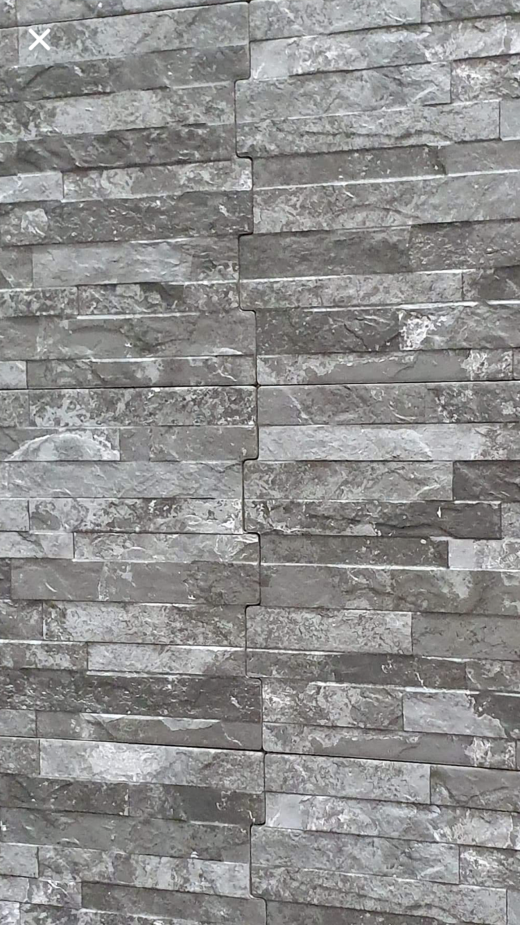

I will definitely be staggering them that’s not my tiling that was In the showroom the customer sent meFor me i would yeah and i'd stagger them in a random bond also to try loose that lock pattern
I’ll see what it looks like once there installed if I have to grout them I will but wouldn’t mind not grouting them as all the tiles on the other walls are white with white grout I’d have to be seriously careful grouting them hahaI knew that wasn't yours
It might look much better ungrouted and staggered as you wont have that gap at the center where 4 meet when they are stacked. A grout piping bag could make it a much easier job also. I've had a few nightmares grouting some textured splitface tiles
Morning josh,ive done a lot of these ,i never grouted them ,as one the gaps so small and the different thickness you will struggle to get in ,i did 40 metres outside ,just sealed it 3 times ,no problemGot these split face porcelain tiles to do tomorrow as a feature wall would you grout these or not they aren’t being used in a wet area thanks View attachment 108886 View attachment 108887
Thanks that’s what I wanted to hear it’s only a small feature wall in a cloakroom so it will never get wetMorning josh,ive done a lot of these ,i never grouted them ,as one the gaps so small and the different thickness you will struggle to get in ,i did 40 metres outside ,just sealed it 3 times ,no problem
Cheers Andy. More than 5 wordsAny cement based adhesive suitable for porcelain...
I use Weber set plus....
Cheers Josh. Hope job goes okI’m using a standard set flexible
