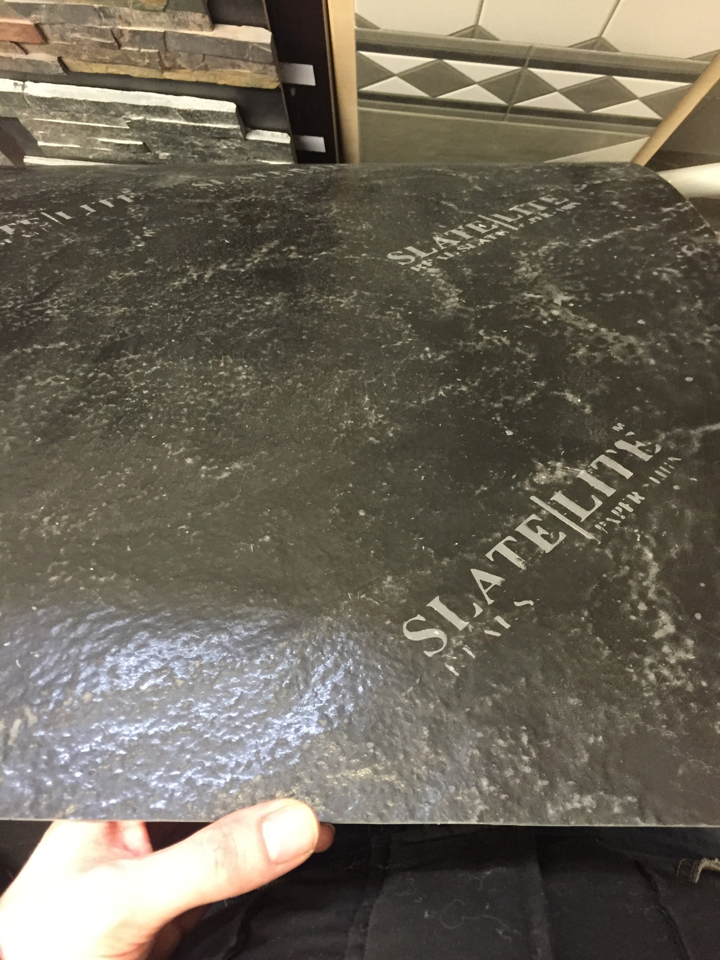

holy smoke !!!!well i had this tested a few years ago after one of my staff who handle it got a reaction
and got back a 200 page report from ceram the long and short of it was a modern version of asbestos if you cut it without a full face mask and extractors you run a high
risk of fibra glass partials reaching the lungs X the loose partials on the face could cause rashes that i had already seen .and if it catches fire it gives out more carcinogenics than you can shake a stick at . the company that tried to sell this to me
had reports all did not match mine .i dont know if they have solved these problems
but there is an easy way to tell .if you push your hand across the face do you get small
splinters in your palm of fibra glass or if you put a lighter to the courner does it start
to burn giving off a thick black acrid smoke .PS any time you cut fibra glass you release
thousands of partials into the air do it again and again there will only be one out come
for you in the end X.
