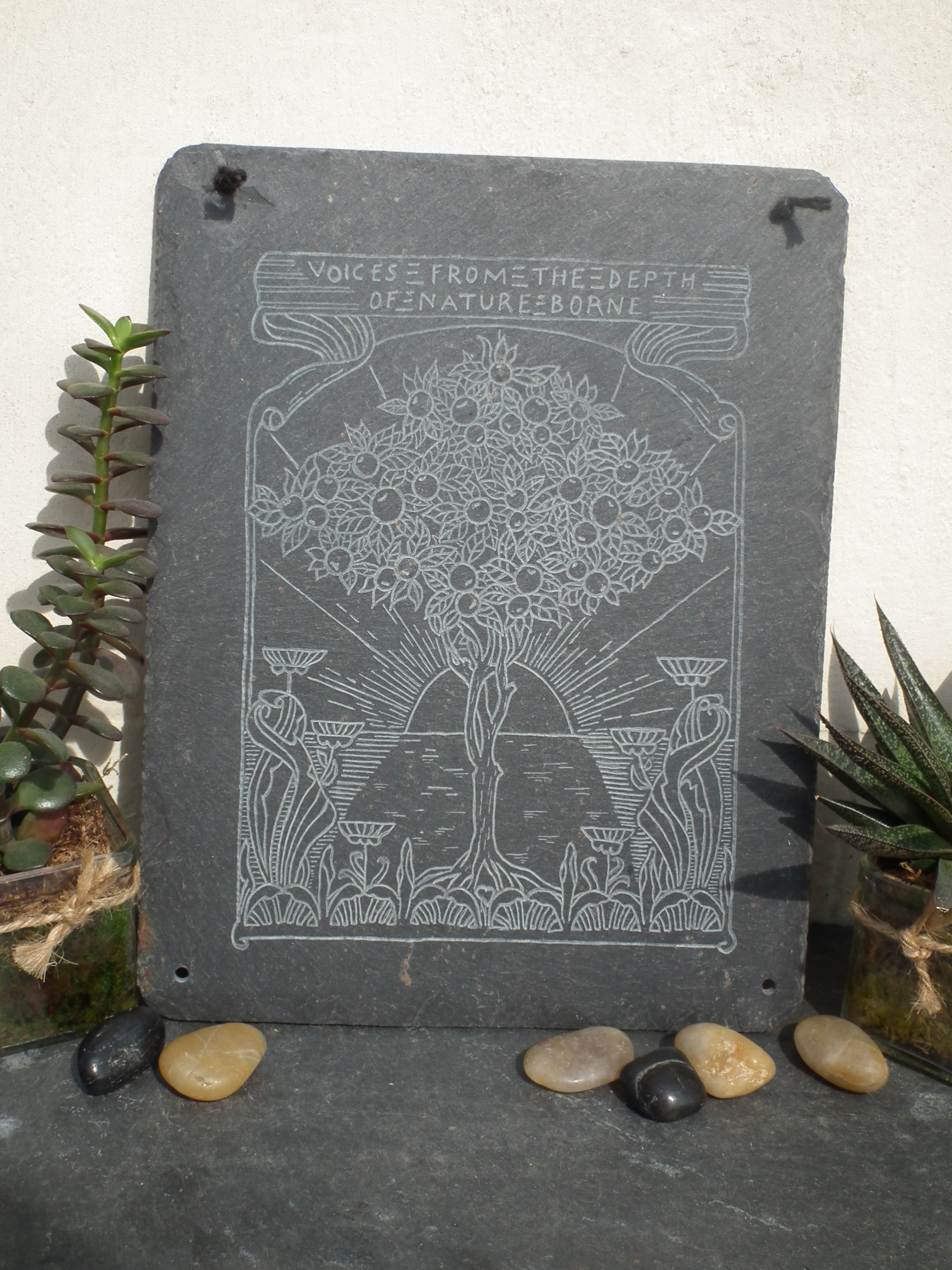

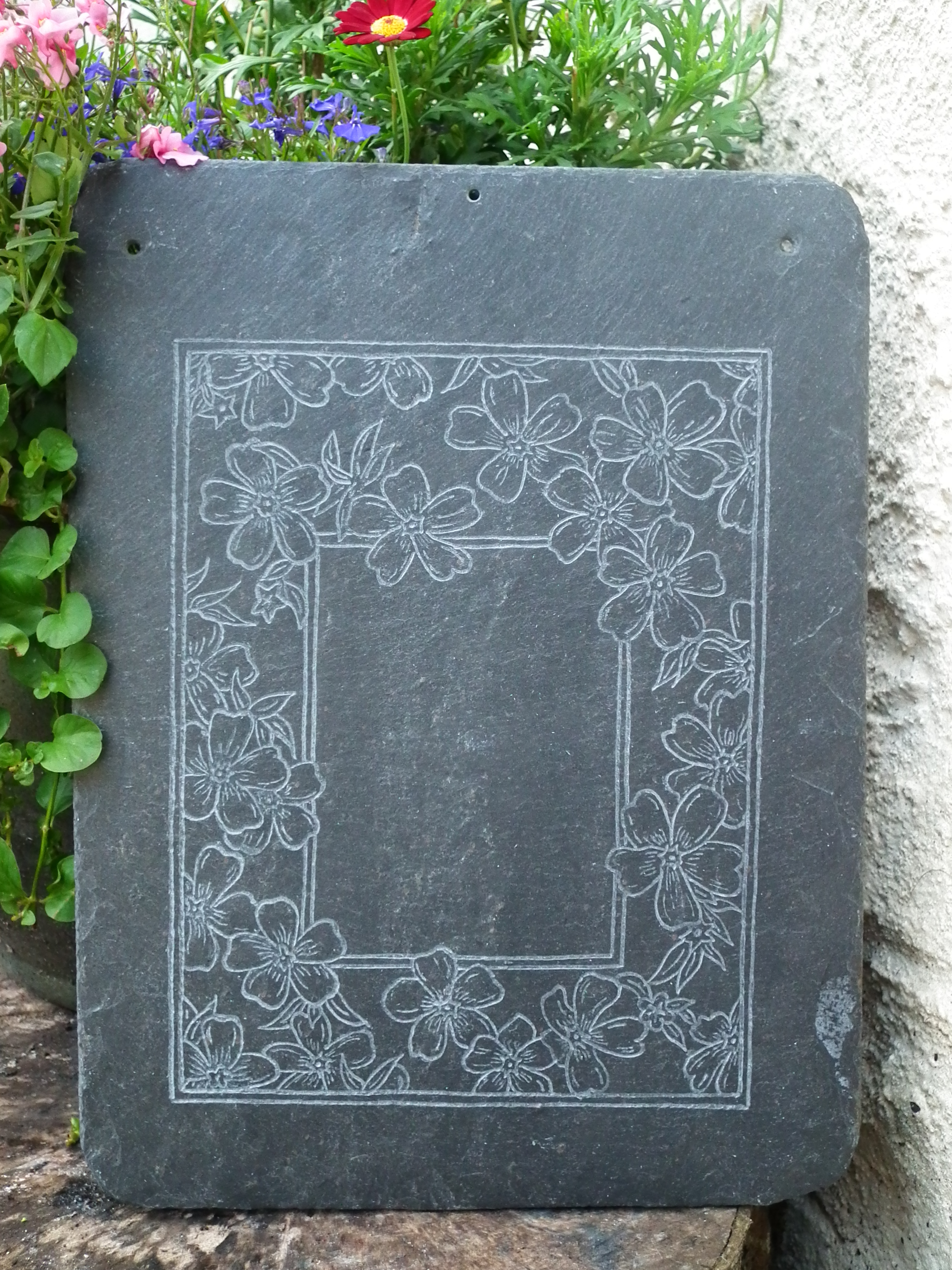

I hand engrave new and used roofing slate - usually fairly small pieces.
As some of my work needs to go outside, I found that sealing it with Adseal Invisiseal worked great over the engraving - keeping it visible when wet without altering the slate colour and being very nose friendly ;)
My newest problem is that my source of fairly dark slate has run out and the local shops (and my local roofer) only seem to have fairly light slate - meaning my engraved lines don't really stand out very much :(
While I am on the lookout for darker slate I am also considering staining the slate without making it look wet.
Now I figure that penetrating enhancers might soak in too deep so my engraved lines might not show while surface ones might make it look artificial and might stop my rotary engraver burrs working properly? Also I would still like to seal the finished work if possible and the enhancer and sealer might react?!
I don't work on a large scale but I would love to expand my hobby slowly. The lack of obtaining a few really dark roofing tiles at a time ( especially ones that don't shatter when I hand cut them) is so frustrating. Also I just haven't got the money to buy lots of different products to buy and the time when companies send out samples to someone like me is certainly in the past! :(
Any ideas or suggestion would be really appreciated as I am coming to a stand-still with my work.
I have attached a couple of pieces of my work just to show what I do.
Thanks a lot, LizzieLee

Welcome & wow!...Lovely work!
Some colour enhancing sealers may be suitable if wiped on then off fairly quickly. They contain silicone which will darken/ enhance the slate. Try a few offcut to see what results you get.
LizzieLee
Thank you! Any suggestions of products as I have only used adseal ? And which sealant would I be able to use over the top?
59
Lithofin Stain stop Plus is an enhancer and impregnating sealant in one. Need to use sparingly so you don't end up with gloss patches. Try @Lithofin BOB for his products. We have used them for years with no problems. Good Luck!
Tile Shop
Stay clear of anything Oil based. we tested Stone Oil and Linseed Oil on deep scratches and both blended them right in, made them invisible. Anything solvent or water based "should" be fine like the ones people have detailed above, but test them first. It would be hell of a shame to lose any of the lovely detail you've put in. Nice work :)
LizzieLee
Thanks Paul, I have oiled slate very lightly before engraving, then washed it before sealing but even though it slightly darkens the slate, it needs to be washed so well before sealing that it hardly shows.
I am very worried that most enhancers penetrate too deep.
Lovely work Liz. As said above lithofin stain stop plus is a good enhancer and sealer. Perhaps seal first then engrave so your your sealing into the bits you gave engraved ?
Tile Shop
I see your point but don't think you need to worry. After sealing first, with either with Oil or a Clear Synthetic sealer, later scratches on slate will still show up much lighter as will engraving as the hardened sealer is also being agitated. Its only when sealing after engraving that there is a chance the colour will alter. Clear sealers should leave the engraving that much lighter shade. but the oils darken it beyond recognition.
Its a common problem with honed slate. Sneeze on it an it will scratch. Awful stuff! So needed to find a solution to blend it in. After using the LTP Mattstone (both the solvent and the H2O) and their Colour Intensifier to seal first, as well as after deliberately damaging the tile, the scratches were still just as bold as before they were treated. The Stone oil and Linseed were the only ones that made it disappear.
But different slates may react in different ways, hence why you need to test a few pieces first.
LizzieLee
Will try and contact Lithofinbob for advice. The sealer over the top would have to be invisible and not react. The only other option would be to make them suitable for indoor use only, eliminating the need to seal the engraved lines until I find dark slate.
LizzieLee
Thanks, that's really helpful info. I just haven't got the money to order lots of products at £20-30 a bottle so am trying to narrow it down ☺.
Dumbo
I know @Lithofin BOB will give the definitive answer but my thoughts are lithofin colour intensifier prior to engraving and then to seal and weatherproof lithofin mn stainstop . These products will not react to each other as I have done this on slate myself .
