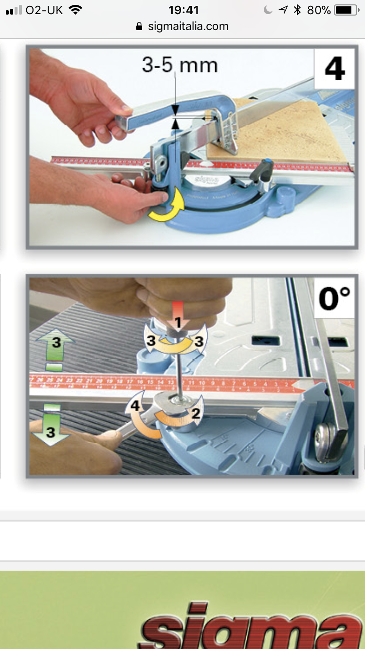

Mine doesn’t cut square. If you use the measurement bar it’s off by about 1 - 2mm over the length of a 600 tile
Have a go at this Andy

You may need a new adhesive measurement tape, part no: Art 107125 etc.
the sigma site, has all the instruction books, 3/4 of the
problems you say on the forum, can be solved
reading the instructions.
