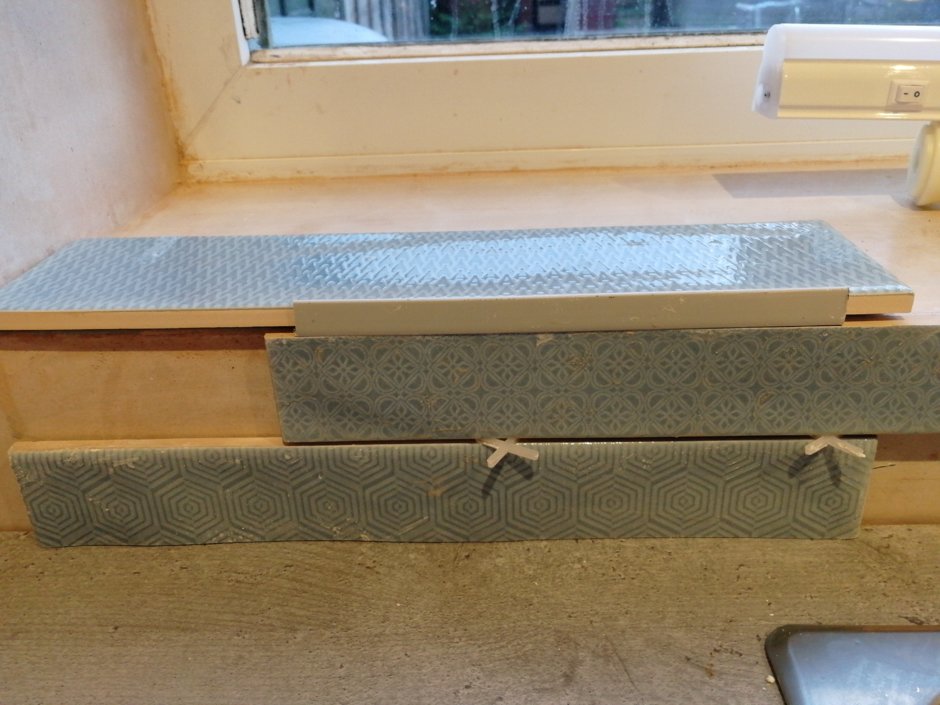

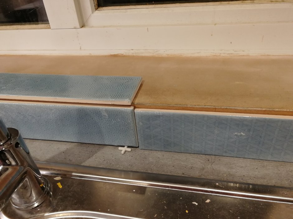

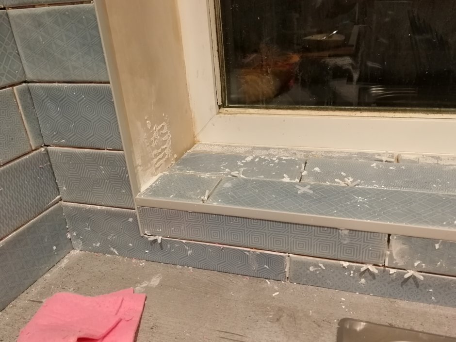

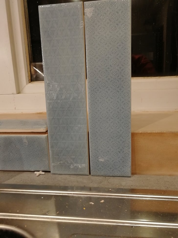

Huzzah, after far too many weeks the end is insight for our DiY kitchen fit. This weekend I'm tackling the tilng, it's been 12 years since we did the kitchen in our old house so I've forgotten about all the mistakes I made then!
Anyways, I've just been looking at the setting out. We're using 300x75 tiles and I'm planning a 1/3 bond with 2mm spacers. Around the window cill is a pain; there's a sliver left, I've put a tile on a 4mm spacer but it's still not enough. I'm fitting plastic edging trim on the corner.
The only option I can see it to have them vertical on the run under the window. Any thoughts?
