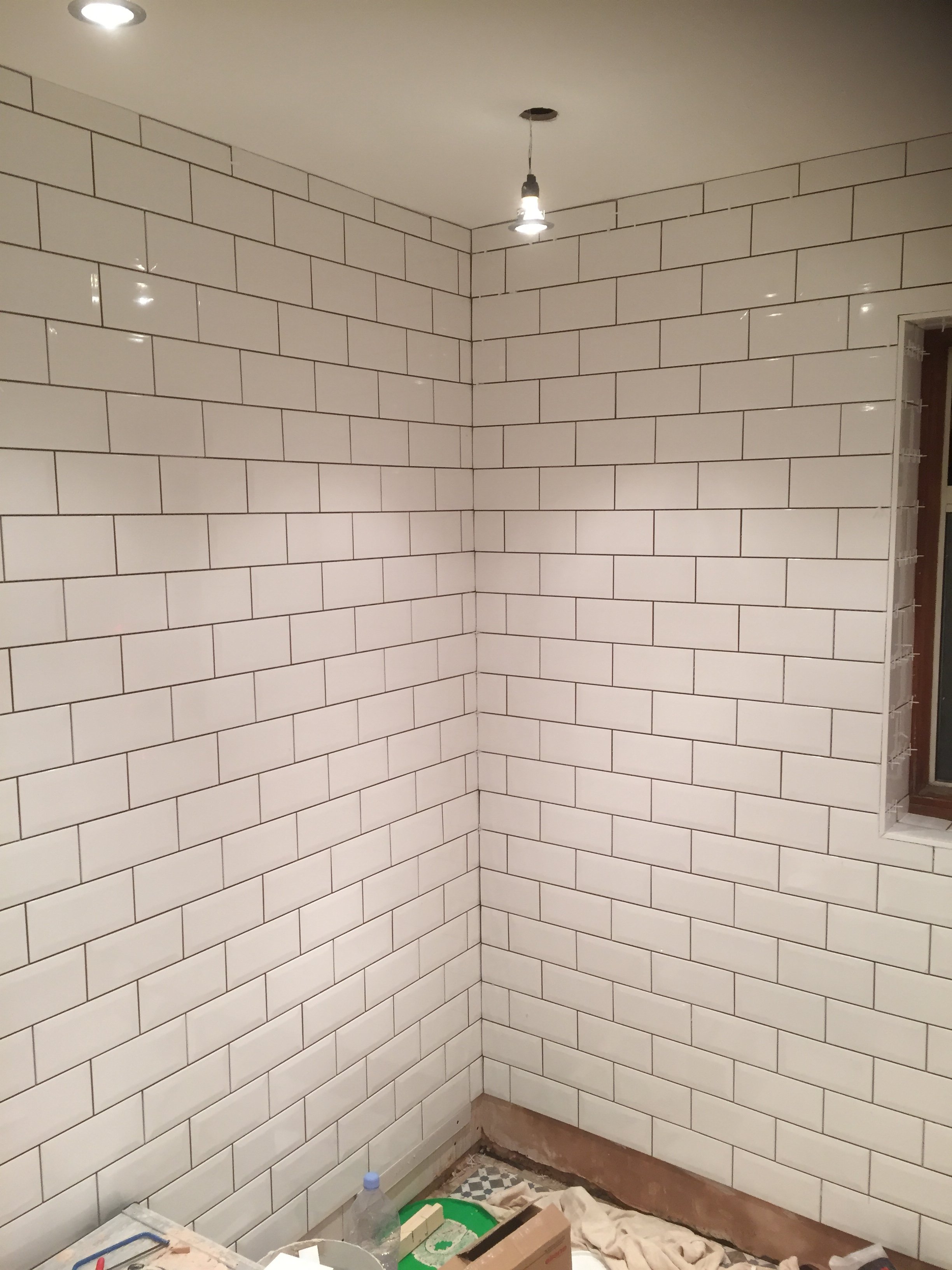

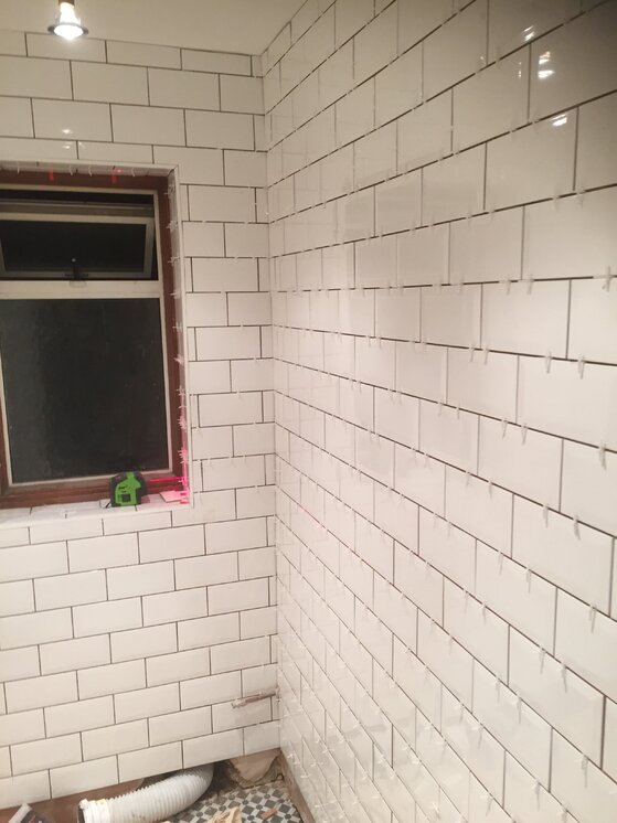

Been setting out my mum's bathroom and having a bit of a mare with the focal point which is the window. If I centre the window no matter of I start with a full tile or half tile (or even a quarter tile) im left with a small cut somewhere. The best compromise is a small cut sound the window but at least the tiles are balanced. Would you guys center the wall if the window doesn't work leaving bigger cuts but not balanced. This is driving me nuts!!

If you have small cuts running up the sides of a window (or similar feature) then the cuts around the corner can be very difficult and liable to breaking (even after fixing) so it is best to avoid such a set out. Pictures/dimensions needed to give an informed opinion as to any actual setout.

I've never been that hung up about centering the tiles round a window, most windows aren't center to the wall anyway. Just try to avoid slithers at all costs.
J Sid
centering the wall is fine imho, choose a grout colour to closely match the tile means the eye will not be drawn to small cuts if you have to have one
Cabnero
Thankso so much guys. Had another look and set out to the centre of the wall which looks far better. Just got a bit hung up with centering the window as this is how I was shown. Another problem has arisen thigh in that there is a difference in the floor height buy around 10 mm. To make this worse the shower tray is in but not quite level. It is out one way woke the floor is it another way. I still have to lay hardie so my question is do I pay this as normal to follow the floor thenot tile from the highest point keeping the four tiles flat AND level. One final thing,when I finish I will put pictures up etc and tell you about the the"builder"/"plumber". I'm sure it's nothing you have never heard but I cat believe what he thinks is acceptable re bathroom fitting, prep and tiles.
