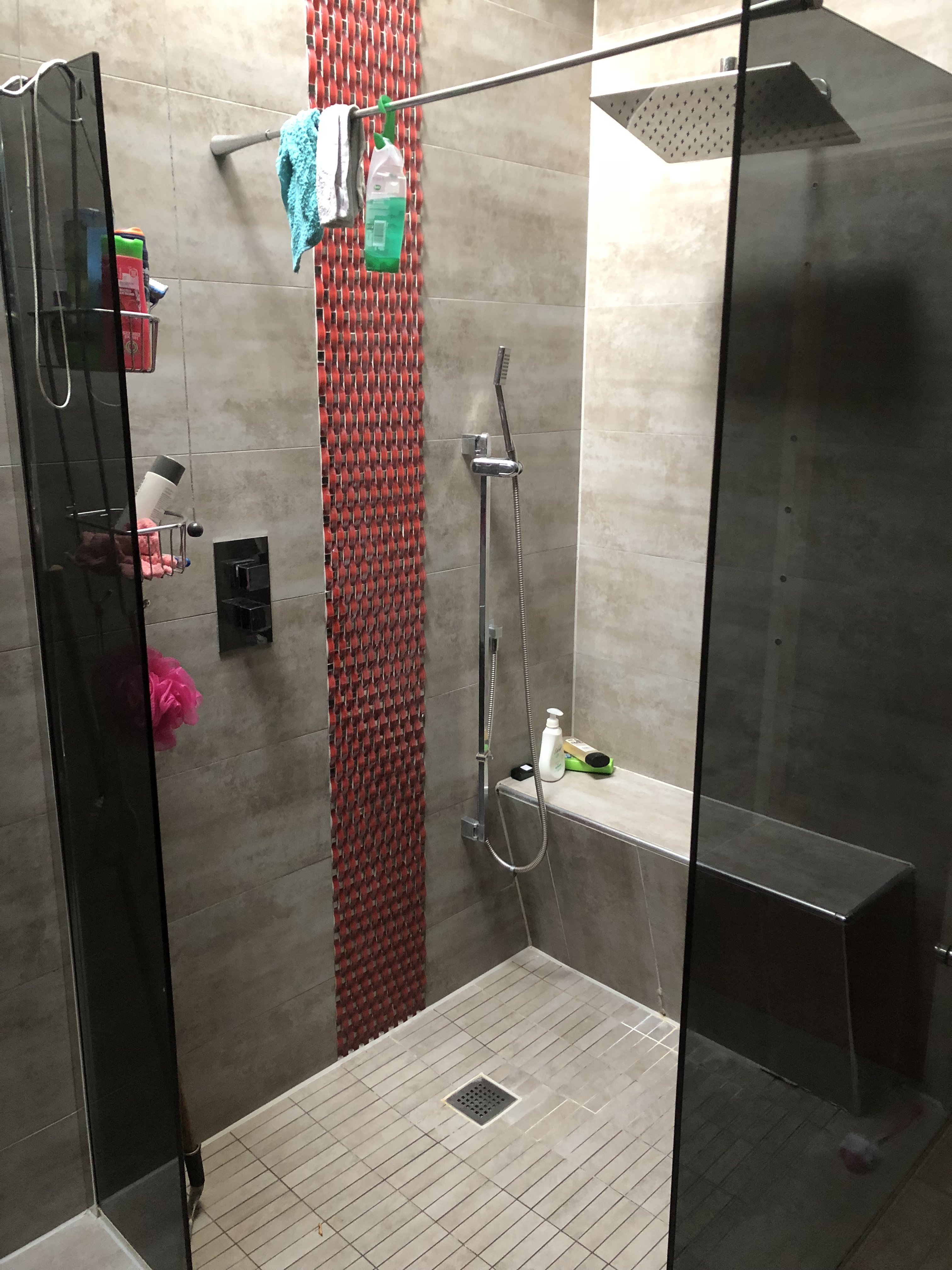

My wetroom is going to be refurbished after my impey tray failed after 10 years. Wetroom is 2m x 3m.
Existing Wetroom:
fO1NPz
I have decided to remove the whole floor, but leave the walls where the sink and radiator is. However, the bottom row of tiles from these 2 walls will be removed and replaced so that the floor tanking can be suitably overlapped. Will also allow me to reposition the radiator pipes through the wall. Finally, I will remove the 2 walls inside the glass enclosure.

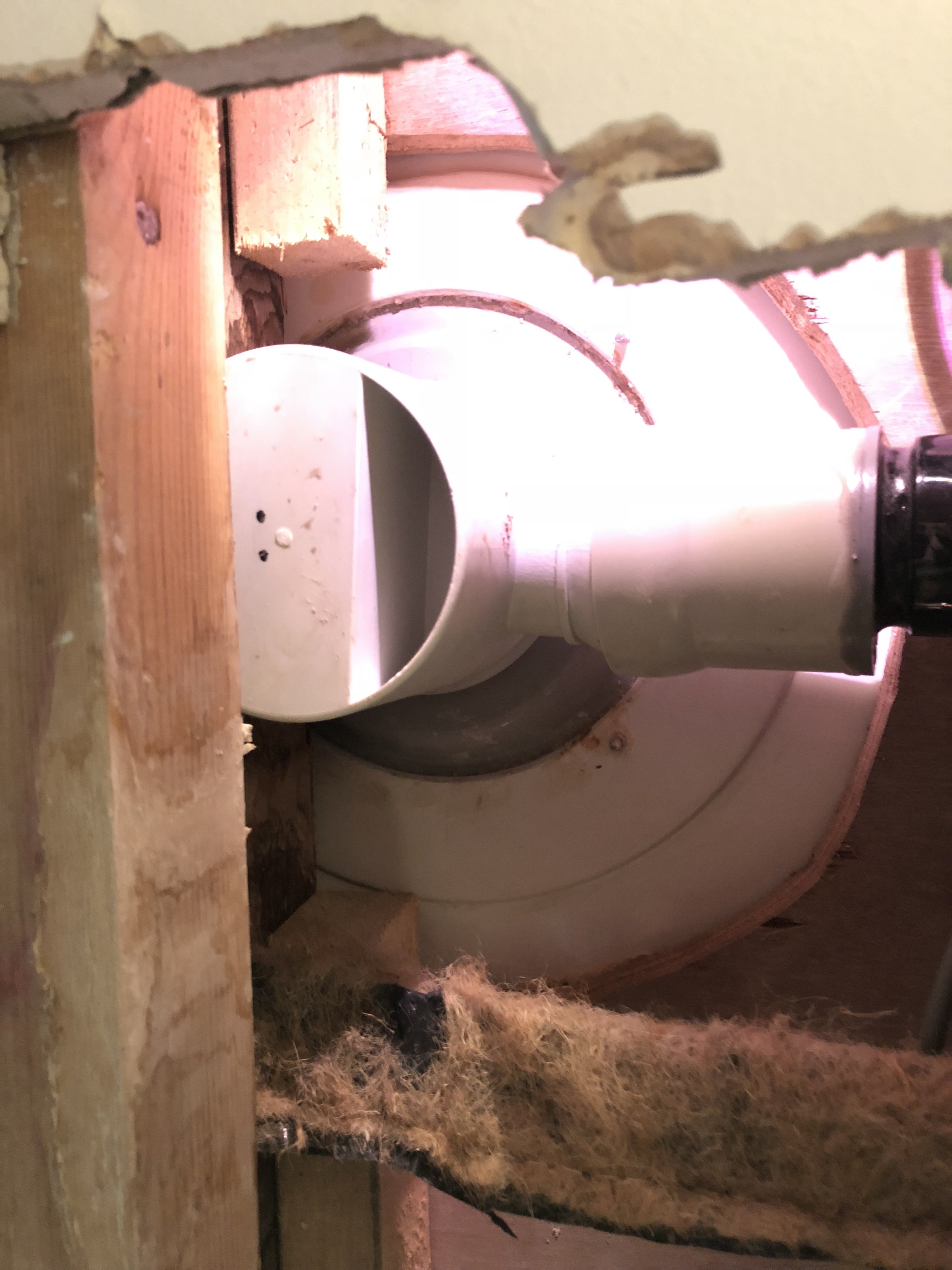

Can you elaborate on how the Impey former failed please and what tanking was originally used?
Sure,
When the shower is in use, small drops of water comes through the drain, I believe the previous tiler did not tank the inside of the drain flange before clamping. Then again not really failed, but not installed correctly.
10 years? Is that tanked with the tilesafe membrane then?
Are you absolutely sure that the drain isn’t leaking? The Impey traps are solvent weld or at least were back then.
Yh the black sticky stuff was used, i have open the ceiling in the living room below. definitely not from where the trap connects to the drain. its leaking from the circle flange.
You could very easily save yourself a load of grief and upheaval by fibreglassing around the underside of the former and onto the drain surround.
I know its a patch up job, but it works!
Yeah I’m pretty sure I could fix that without touching a tile
