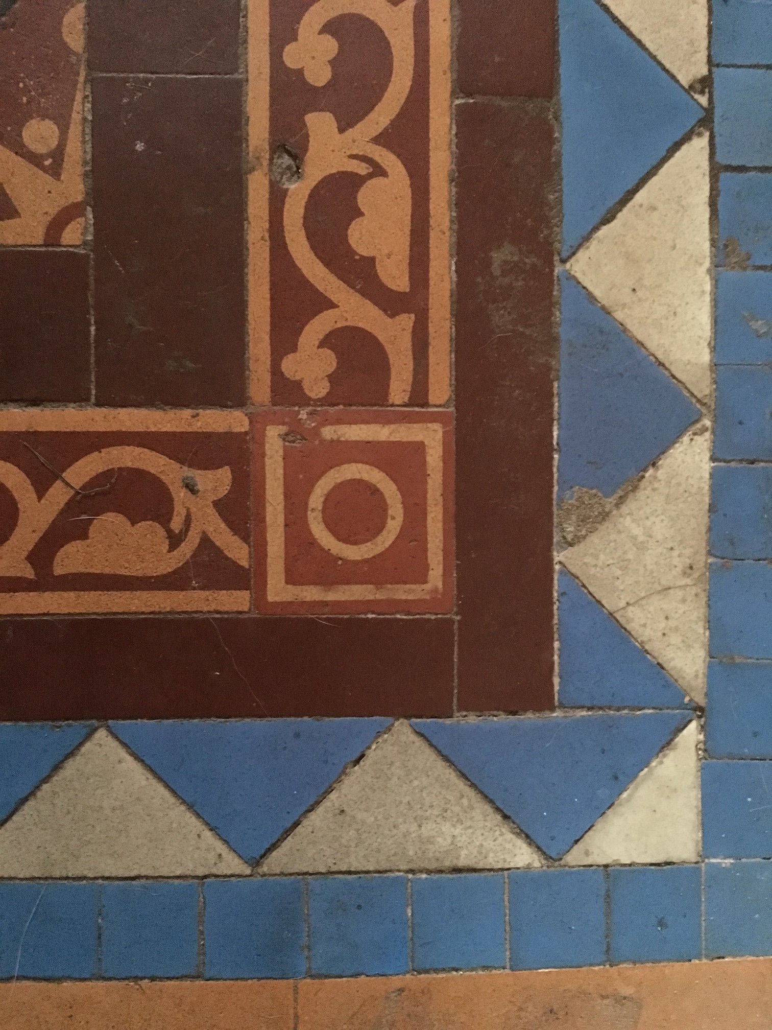

Thanks all. Image attached (hopefully).
It's the small square encaustic (the one with circles on) that needs to come out. An original tile that's a better colour match has been bought.
Am worried about lifting other tiles either side.
Cheers
If I understand your intention it’s to take out the small red square tile because it’s slightly pale compared to its rectangular neighbours, yet your leaving the blue chipped triangle and adjoining rectangle with a hole in it!
No, there will be three tiles that are the corners of the border, when the floor is complete. The other two haven't survived along with a 2 metre patch (due to overeager plumbers way before we bought the house).
We've managed to match all the tiles we need through Ebay and Craven Dunnill Jackfield.
I'm keen to keep a bit of character so the odd chip is welcome.
If I can lift this one easily enough and replace with a reclaimed one, it'll look more considered.
It's certainly too tight to get the angle grinder down there.
