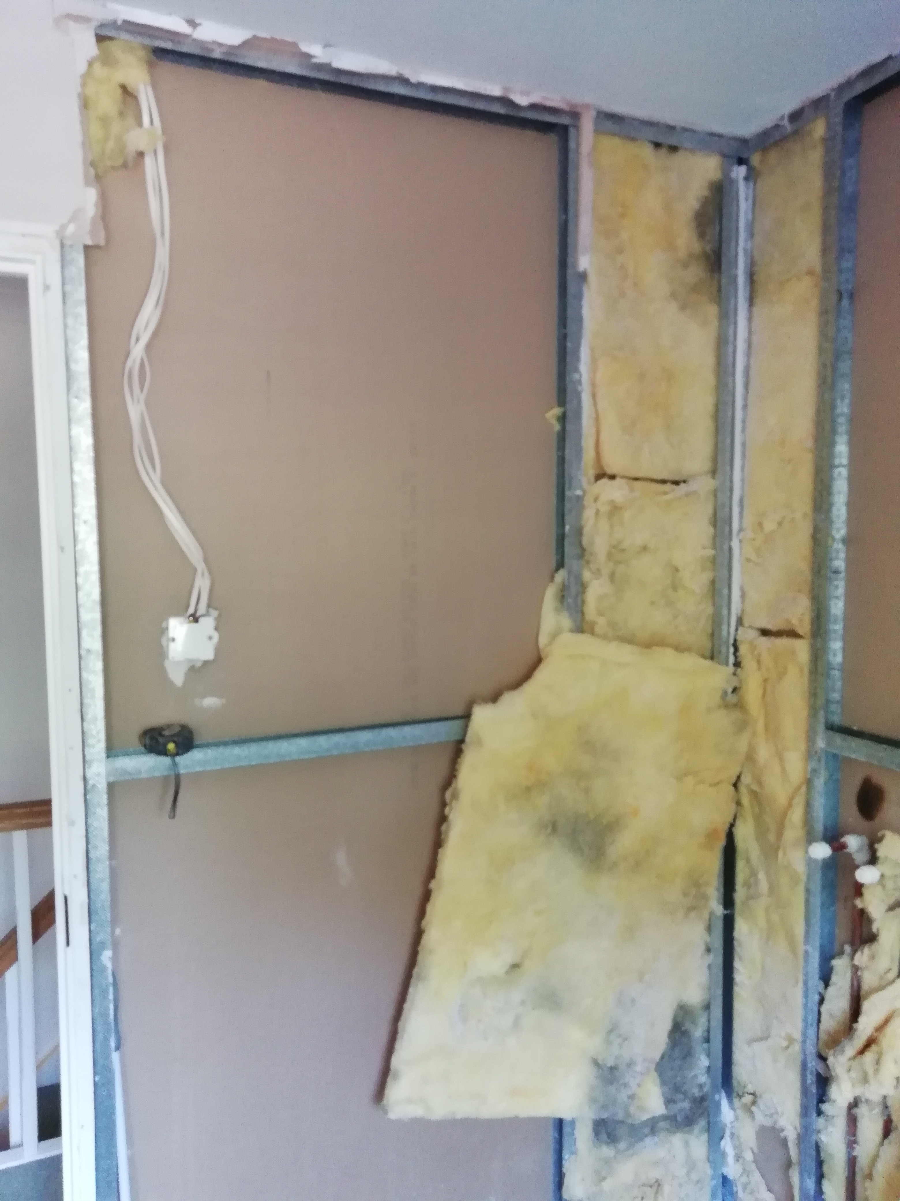

Hi im going to be using 600x300mm 9mm porcelain tiles, on the wall, Im really confused on the best way to go. Have a look at the pics this is were the shower is going, do u think no more ply 12mm boards would be stronger than using 20mm marmox?

The walls will definitely need some more uprights.
From experience I can say 12mm Hardi on metal stud work won’t go anywhere in a hurry!
But the walls I worked on were 450 centres if I recall.

Yes I was surprised on how little supports there, I'm going to reinforce but still can't make my mind up to go nmp or marmox

Omg! I hadn’t seen photo, been too busy ranting! :D
That needs work for sure. :eek:
Like Boggs says, needs more stud work haha
Doesn’t matter what you clad it in, it needs more studs.
