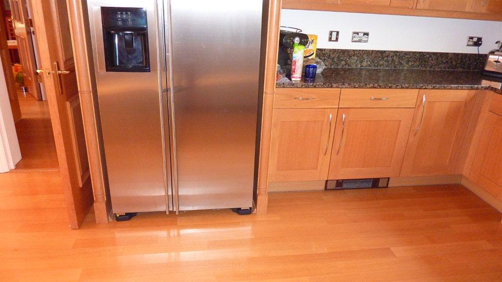

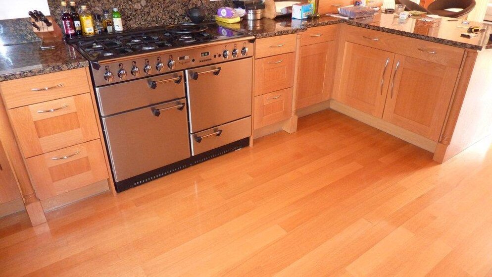

Went to view a kitchen yesterday.
The kitchen cabinets are sitting on 15mm solid wood flooring. The flooring is bulging in the middle of the floor. I believe this is caused because the heavy kitchen is sitting on the wood and the wood has nowhere to expand to (except upwards). Customer wants wood removed (about 30sqm) and replaced with UFH & 600x600 porcelain tiles. My problem is how do I remove the wood flooring from around and under the cabinets? I have found a tool called ‘Toe kick saw’ but it only seems to be available in the States. Also, I believe it is quite a dangerous tool to use. This tool will cut upto ¾ inch in depth and will cut right up to the cabinet. Is there anything in the UK that will fit the bill. The kitchen cabinets are solid wood really expensive with granite work surfaces. Cheers Sean
