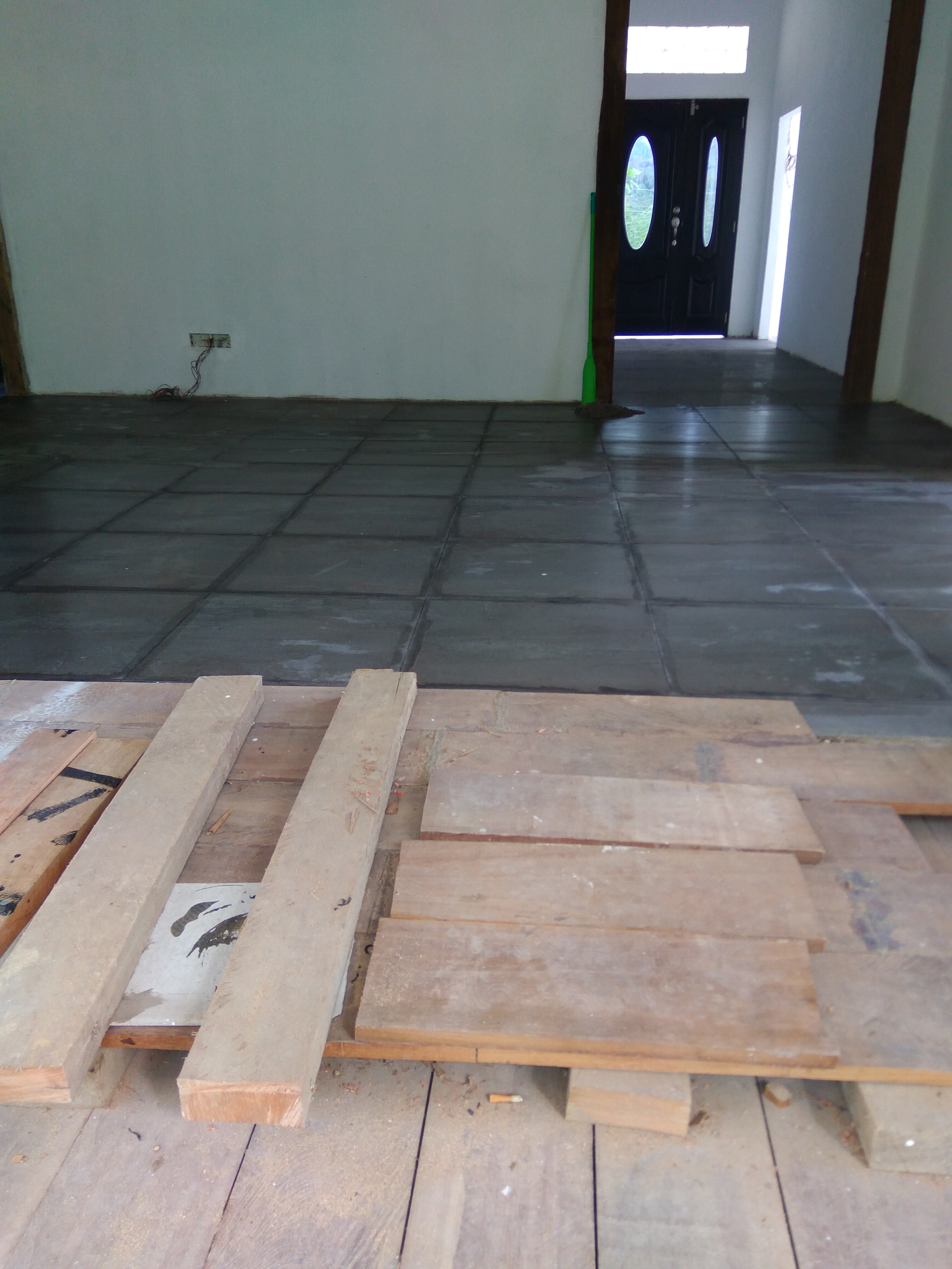

i'm using black grout to match the tile..but the stain on the tile won't come out after scrubbing. i try out the vinegar tip but isnt working.please do advise?
