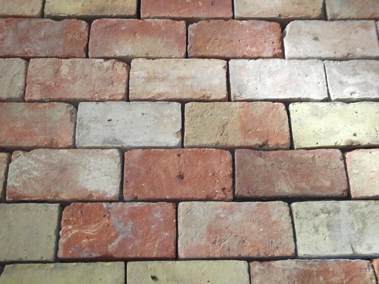

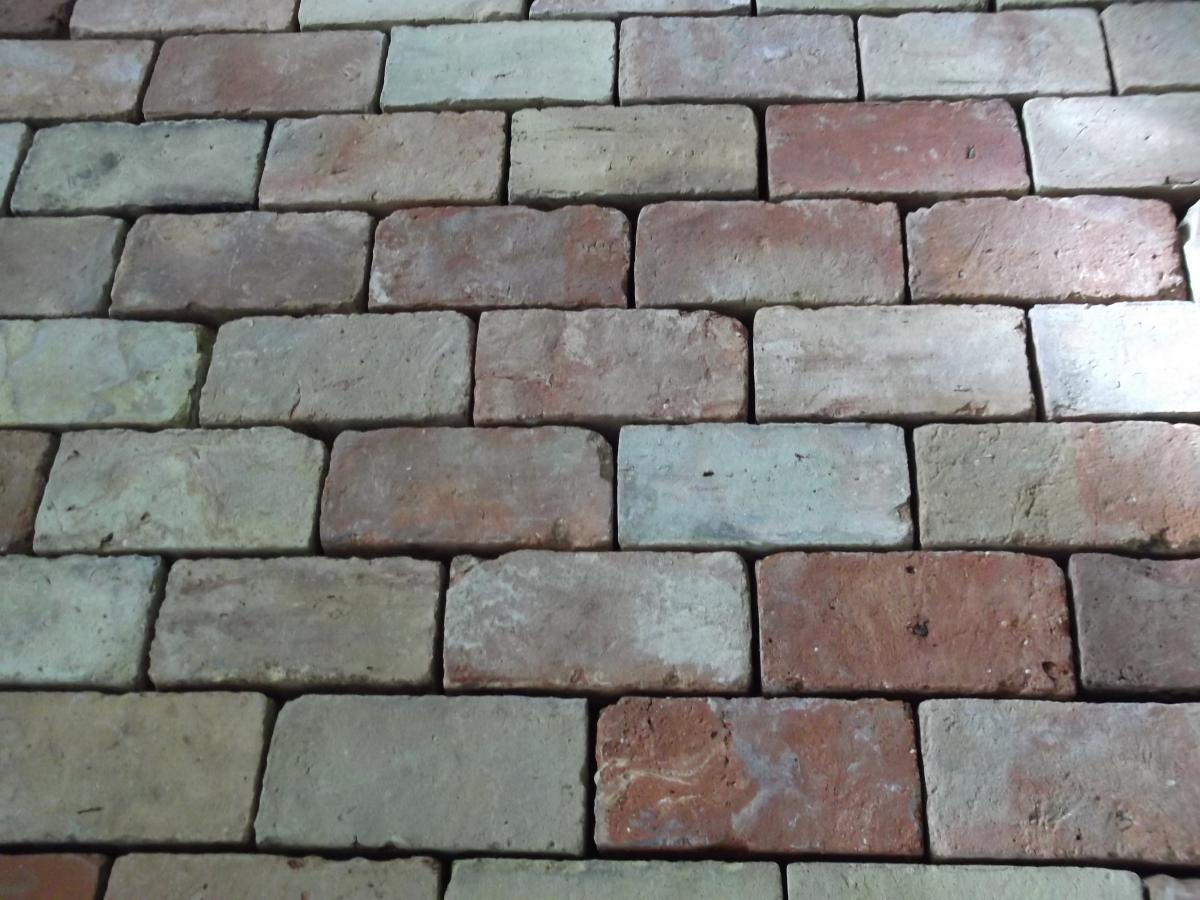

I've just laid a reclaimed brick floor in my kitchen (full bricks, 2.75 inches thick). I haven't pointed them yet, as I need to seal them first. Problem is, I need help to choose what type to get. I love the natural colour, mellow and rustic, so ideally I don't want that to change. However, the surface is rough and I can imagine that, leaving them with a matt finish, they will be a nightmare to clean. So, the ideal scenario is to seal it with something that won't change the colour and lets the floor breathe, and is either a delicate silk finish, or add a top coat to achieve the same effect. What I definetly would hate is any darkening/plastic looking finish. Also a high gloss isn't the look I'm after. So, can someone please help?

Bubblecraft - Thanks for the kind words. They look even better in the flesh and i love them. Which is why I am determined not to cover them in plastic looking gunk. Natural as possible is what I'm after.
DPF - The clue is in the title, NOT LINSEED!:smilewinkgrin: I used it years ago on some old Norfolk pamments, and it looked awful. I don't like what it does to terracotta either, but thanks anyway.

Just finished laying the cut bricks today, so I'll leave it to dry for a few days then seal before I point it (how to do that will be another thread!). How you floor tilers do this all day every day is beyond me, this has killed my back.
AliGage - I'll be happy to post a photo of the completed floor, hopefully by the end of next week. Not bad for a floor that's cost me just the sand and cement so far, oh yes and some SBR. Mind you, this is just halfway, not enough bricks for the whole floor. Undecided as to what I'll do on the other half.
