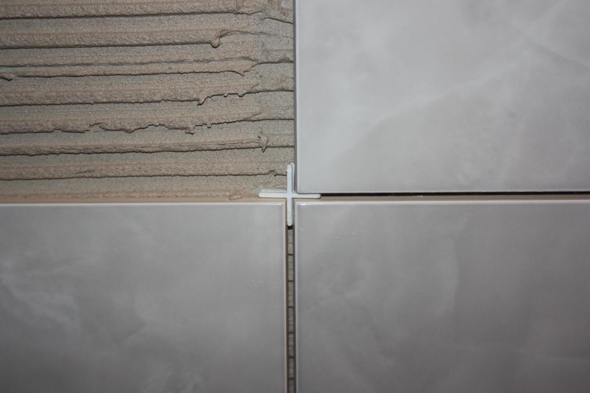

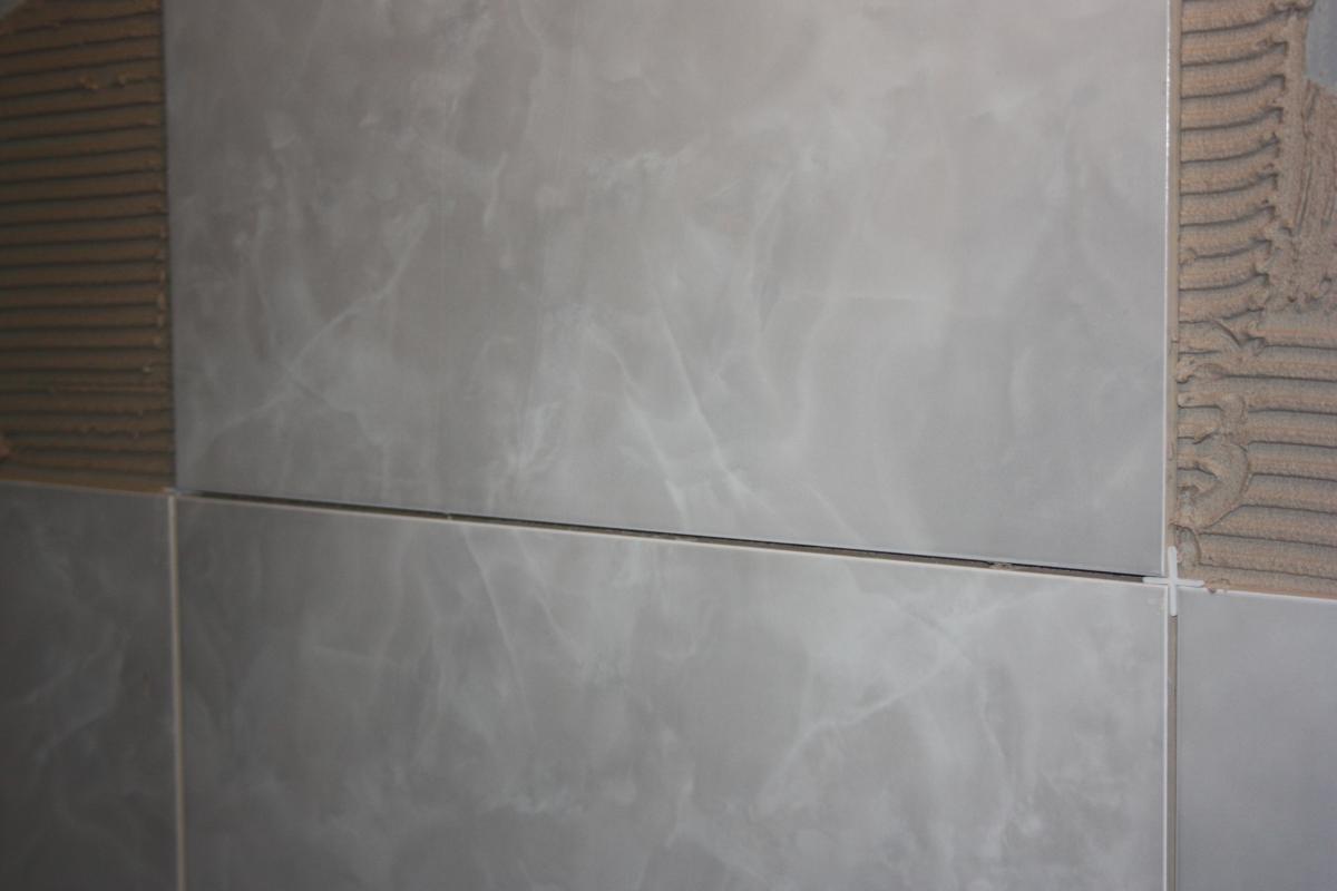

Installing a bathroom and the customer has choosen 600x300 Dorchester-Carrara tiles made by British ceramic Tiles.
Finding that some of the tiles are up to 2mm different in size and other tiles have blemishes or crack lines in the glaze.

I know what you mean. How can they produce a tile over 2mm different with all the tiles having the same batch number.

Yep did a shower enclosure before xmas, similar thing, mis-sizes and also curved on a 250x330. Shocking really, used to go out with a girl and her chest was flatter than the tiles from BCT
Fixing British ceramics in a bathroom at the moment and 2mm difference in sizes, don't make the job any easier....

It's the same with some Spanish tiles. Just laid 450 x 450 floor tiles, 2 - 3mm difference in size and more belly than a Tellytubby
