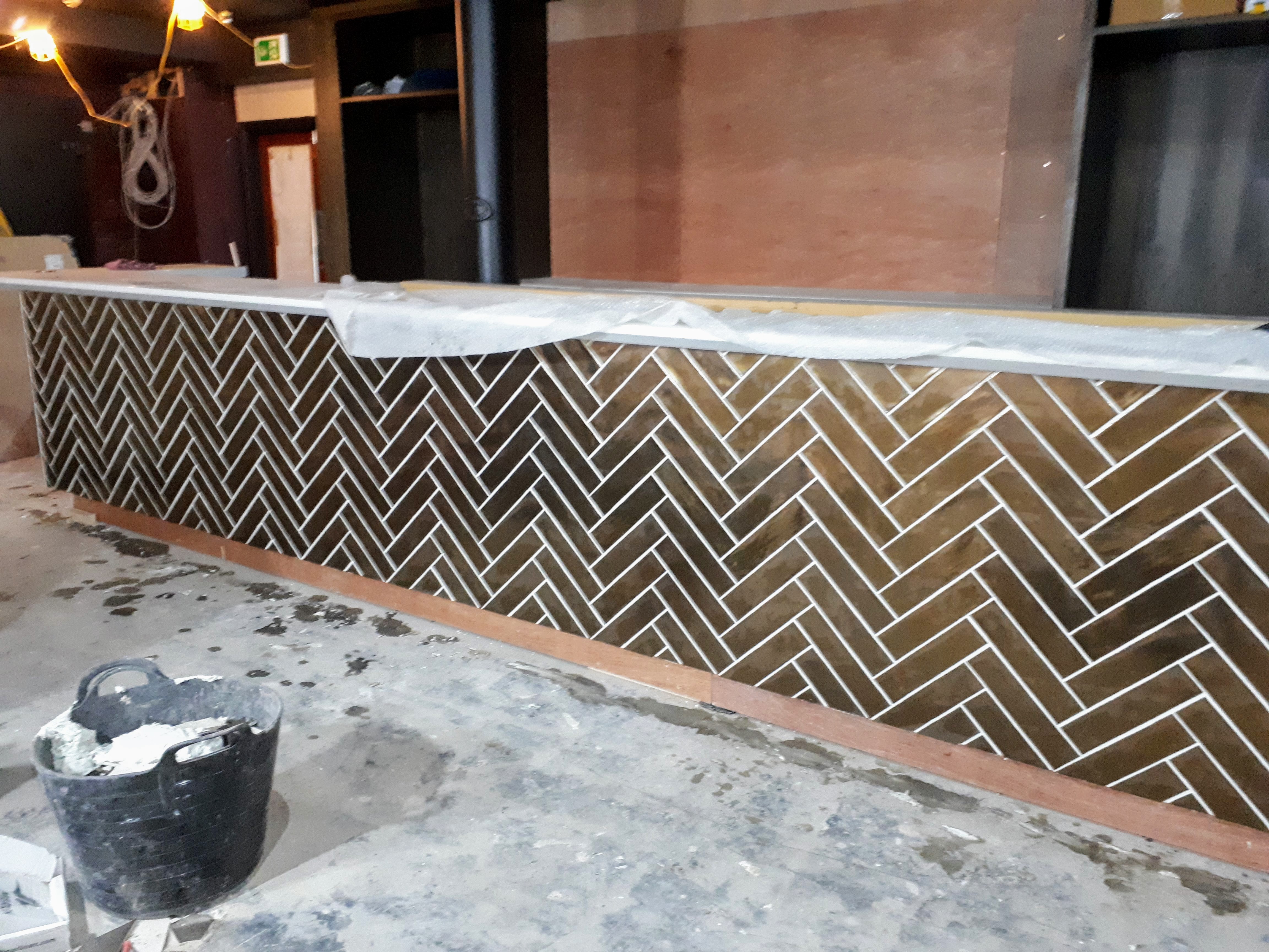

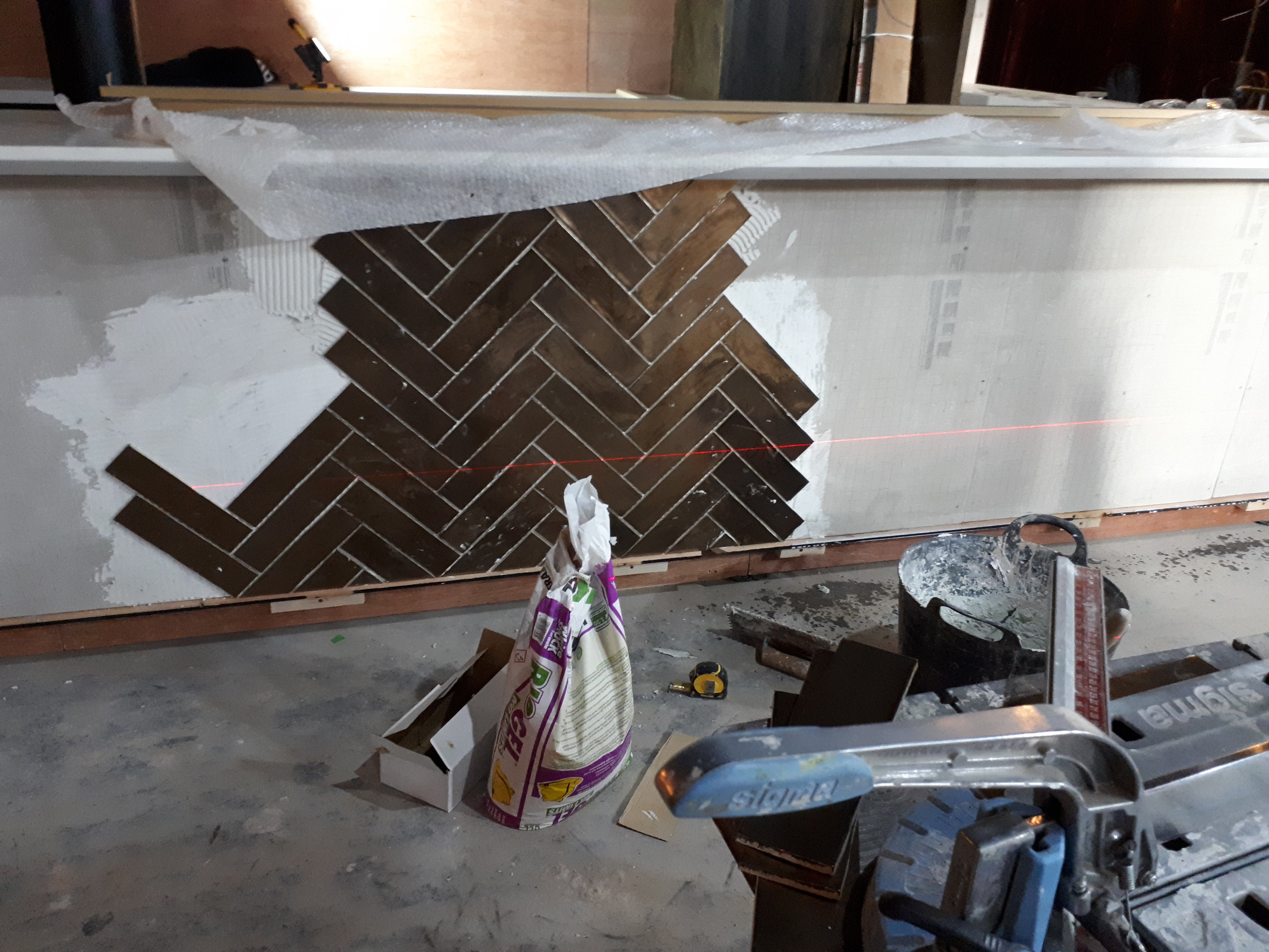

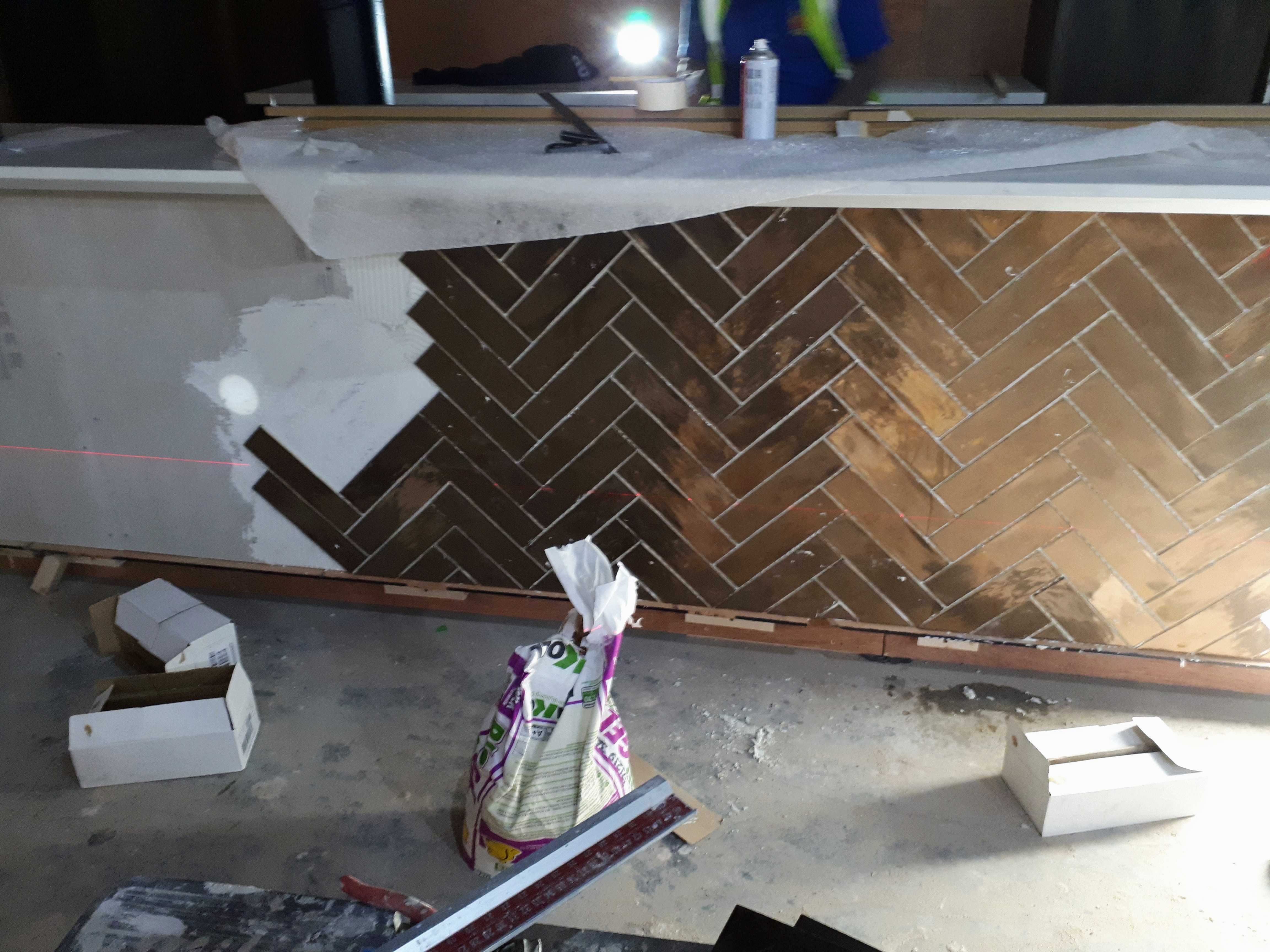

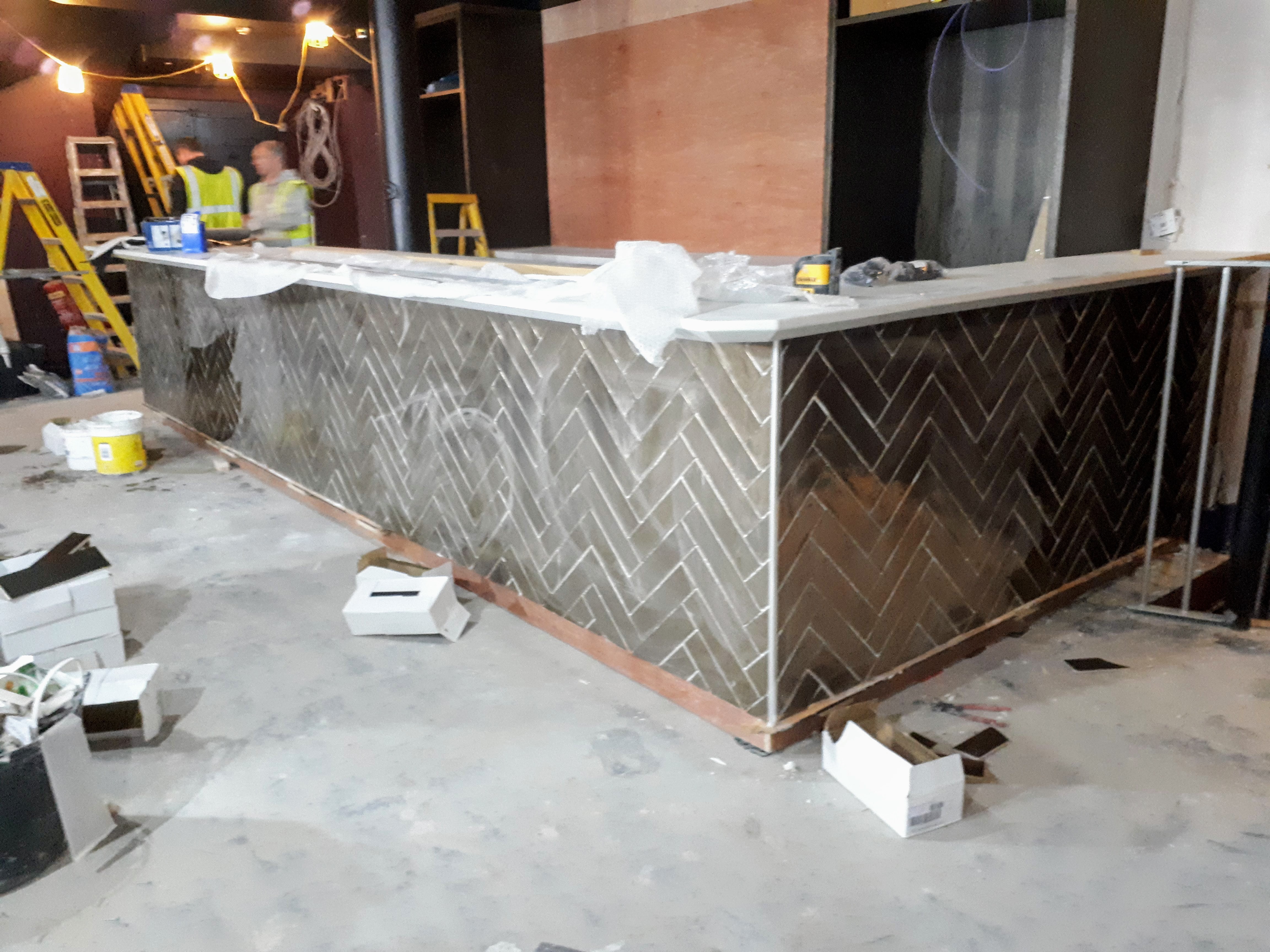

I would say it takes at least twice as long as normal tiling...
This job was 15 m2 and took me about 4 and a half days...

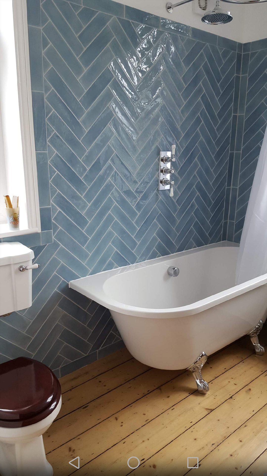

Hi! Can see you put an extra row of tiles at the top of your herringbone, am thinking of putting a black box trim on the top of my beveled metro white tiles (herringbone) with grey grout - in your opinion will this work?
