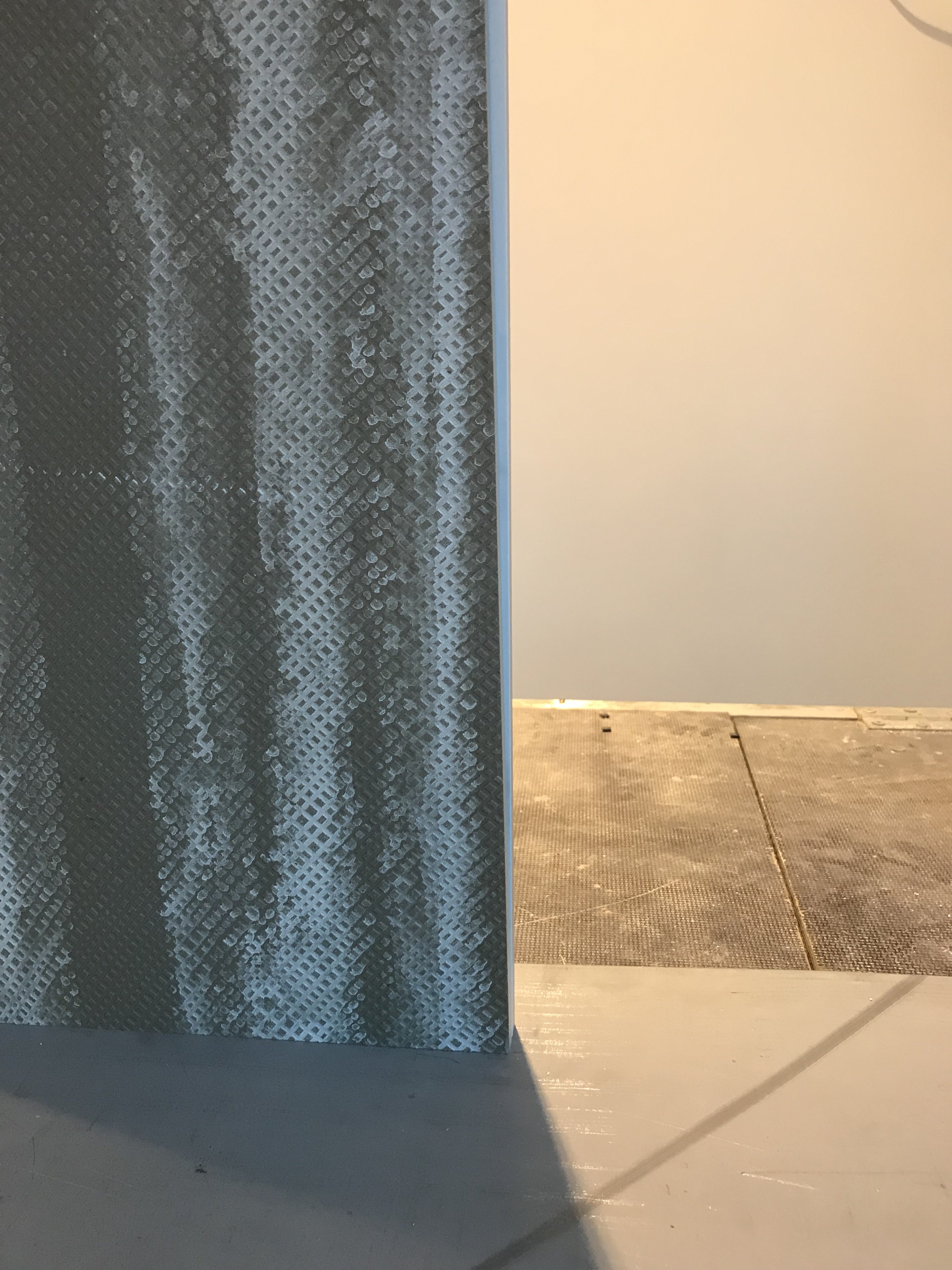

Currently in a 3 way dispute
Started tiling with a 600x300 and stopped after fixing 2 full tiles and 2 cuts. The tiles are made in India (says it all) when I put tiles together standing vertically on the 300 side they actually ran out 9mm over the length indicating that they’re out of square by 4.5mm and warpage runs out to 3mm from centre. So under British standards can they get away with even selling this crap.
These are porcelain. Been in this game 27yrs
Never seen anything like it
Look forward to your thoughts
Thanks all

@Paul C. will be able to give you the info you need i expect but I'd say no
are they the same batch....just because there in the same box doesn't mean they are

Agree. Alot of the Indian factories are very good quality, but 9mm difference is well out of tolerance. The allowance for a 600mm tile is +/-2mm from the average size of all the tiles together, meaning the maximum allowed difference between the extremes smallest and largest should be no more than 4mm. Only time this wouldn't apply is for tiles with wavey edges that are deliberately made to a variation for a rustic look.
4mm sounds alot.... and it is (needs reducing in my opinion), but most factories sort their finished tiles into calibres to ensure they are with no more than 1-2mm total difference in a single batch. Guess this factory don't have that sorting process in place.

Also for the "squareness", tolerance for that is also 2mm. So one side 600, the other 598, technically acceptable (as per BSEN14411). 600 to 597 is not.
Run your eye up the tile. Cheers
