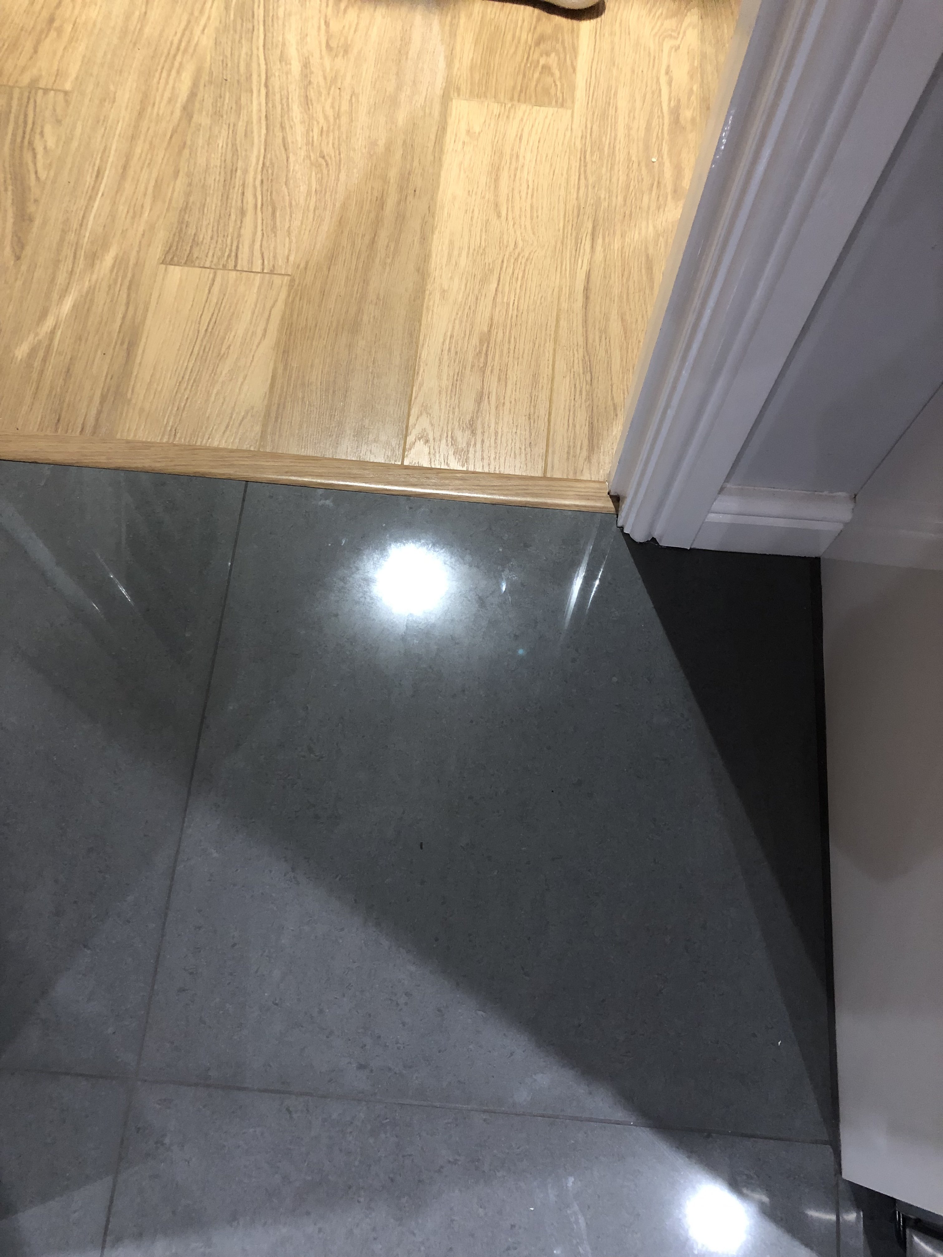

Hi,
I have recently had my kitchen floor tiled using a dark grey polished porcelain tile. It looks great but when the light catches some of the tiles they look ‘hazed’ could anyone tell me a) what it is and b) how I can go about getting rid of it. Here’s a picture, it’s incredibly hard to photograph it but hopefully you can tell what I mean. I’m also unsure if the picture will even post!!

Thanks for sharing that article, that potentially explains it. The only thing I would say is the most obvious tile is that one in the picture right in the doorway.. the one behind it for instance doesn’t seem to have it at all. I can also see the haze from above, I’m not saying it’s not optical haze as it could well be, I just want to be certain that there is nothing I can do to sort it out.
Good info, I've seen it many tiles and was never sure what was going on. I did a large floor last year with polished porcelain and they were really bad for it, got me paranoid as hell that it was me causing it. it's strange how it's not usually consistent
One Day
I've only seen it once and it was with cheaper porcelain. Transit wax can look similar but obviously cleans up ok.
I'm not saying it is OP's problem here and Waluigi may well be on the money, but just throwing it in for consideration...
