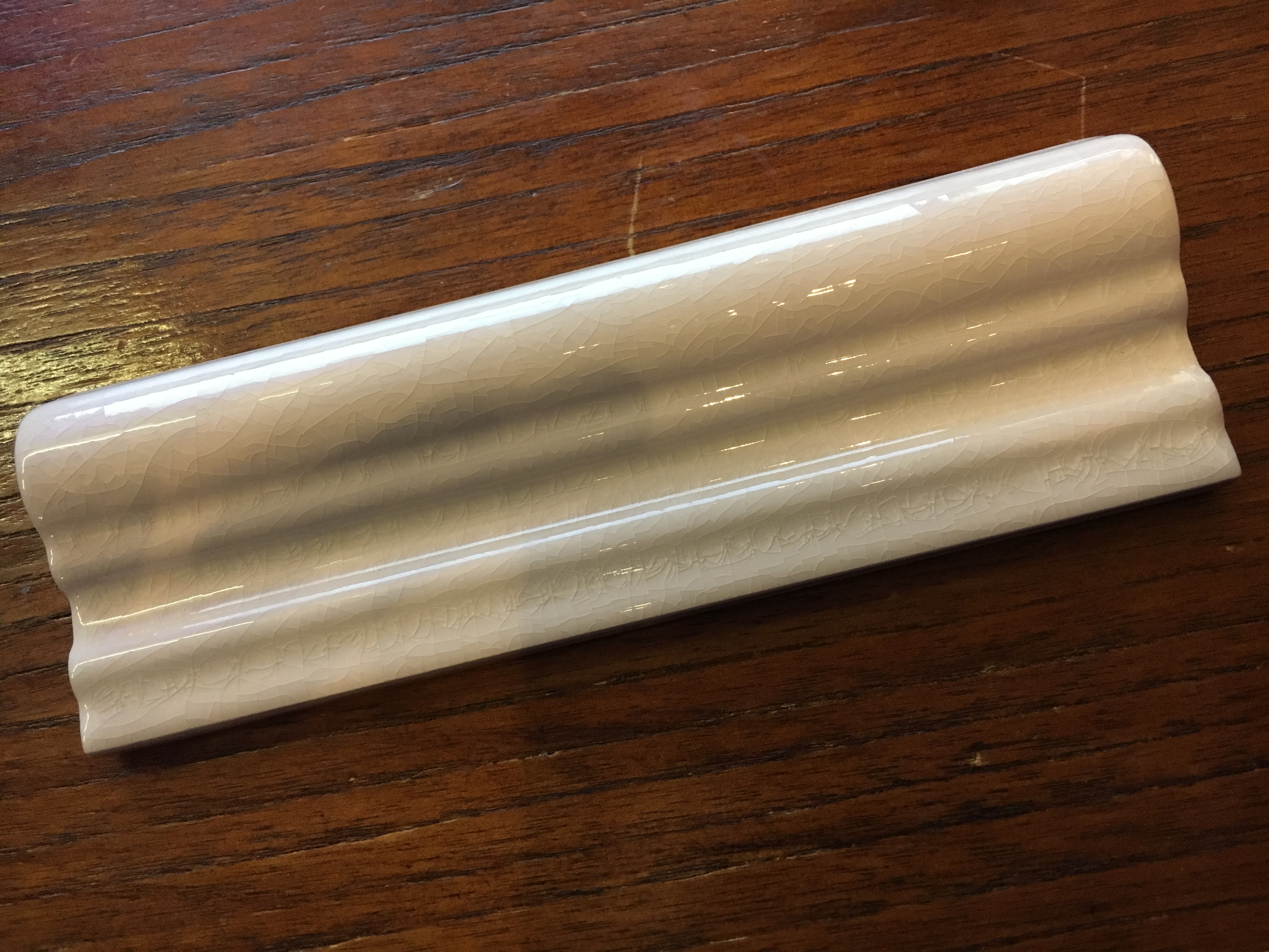

Im looking for some suggestions/advice on how to tile a wall outer corner with the following border tile, images attached below.
Can anyone recommend the best finish for these?

Whats the best way to achieve a good mitre? I do have a wet tile saw yes.
Could doing this potentially damage the crackle finish on the tile?
Sorry I dont understand your question, there will be multiple outer corners where two border tiles will butt together using a mitre (hopefully!).
No will not damage finish on tile as long as you have a decent diamond blade on wet saw and it is not worn out and make sure there is plenty of water in tank. I would suggest holding the two border tiles together at 90 degree angles so that you can see which way the mitre on each tile will need to be cut then Place in wet saw and line up so that the blade will cut required angle
Thanks very much for your help.
The tile attached below will be tiled in metro style with the border along the top to finish. How would you finish these at the same outer corners?
