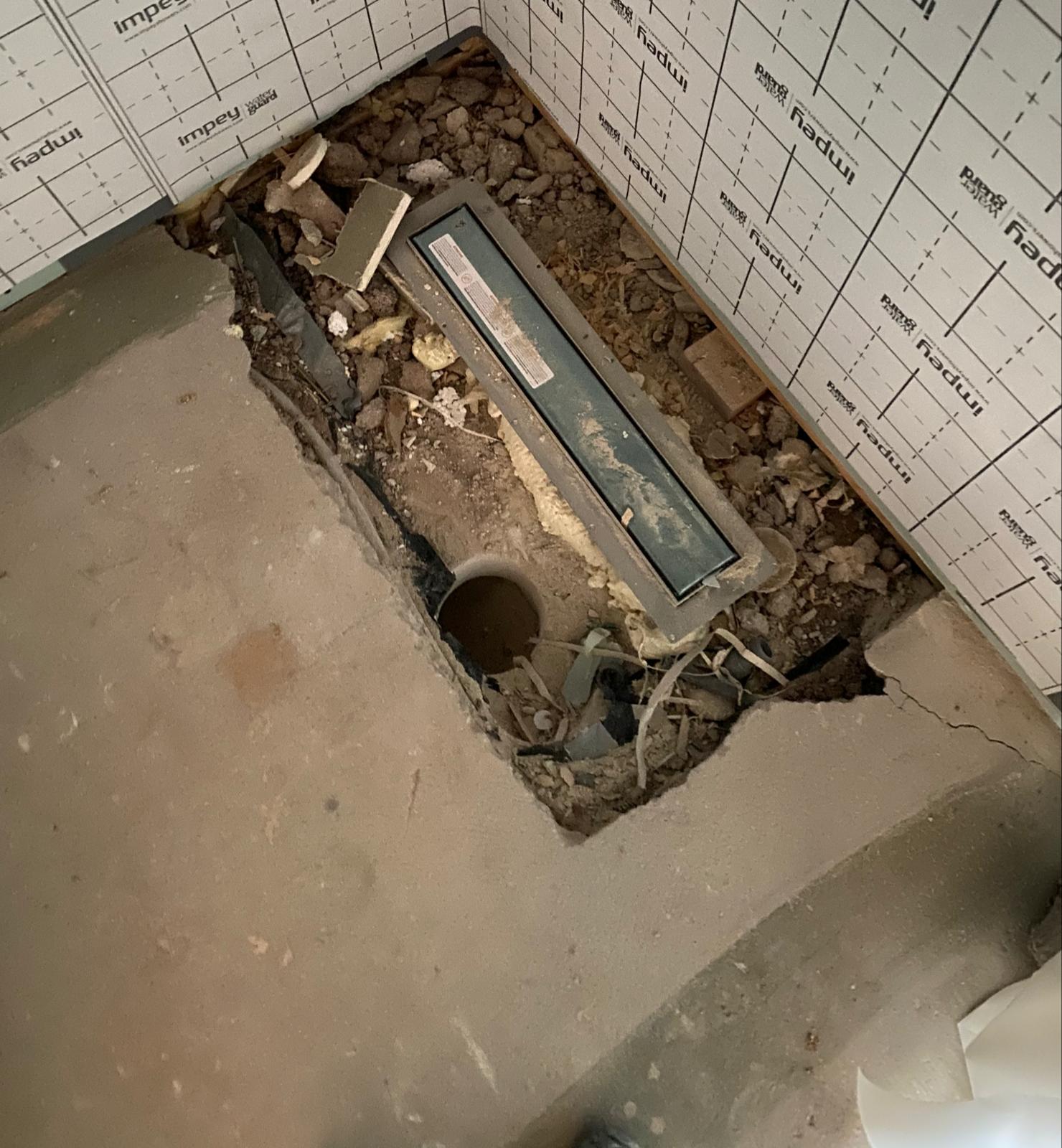

Wet pipe ran straight through onto the tray in all 4 bathrooms, my suggestion was for them to cut out block and bring back up leaving the depth for a foam former to be fitted flush to the rest of the floor but the pipes are in so poses another potential issue... its around 50mm thick above the pipe and you can get 40mm thick foam trays so they wouldn't have to break out floor completely. Would be a ball ache but I don't see another way without the job failing. DPM has been cut out around tray and a big hole going straight through ground floor ceiling which is a major issue in itself... so in my opinion this whole shower enclosure would need cutting out and re doing anyway? Got a meeting with the builder tomorrow about this whole issue anyway because he is adamant that this is how they are done (I've done over 20 Wetrooms in the last year alone still never seen anything as bad as this until now)
