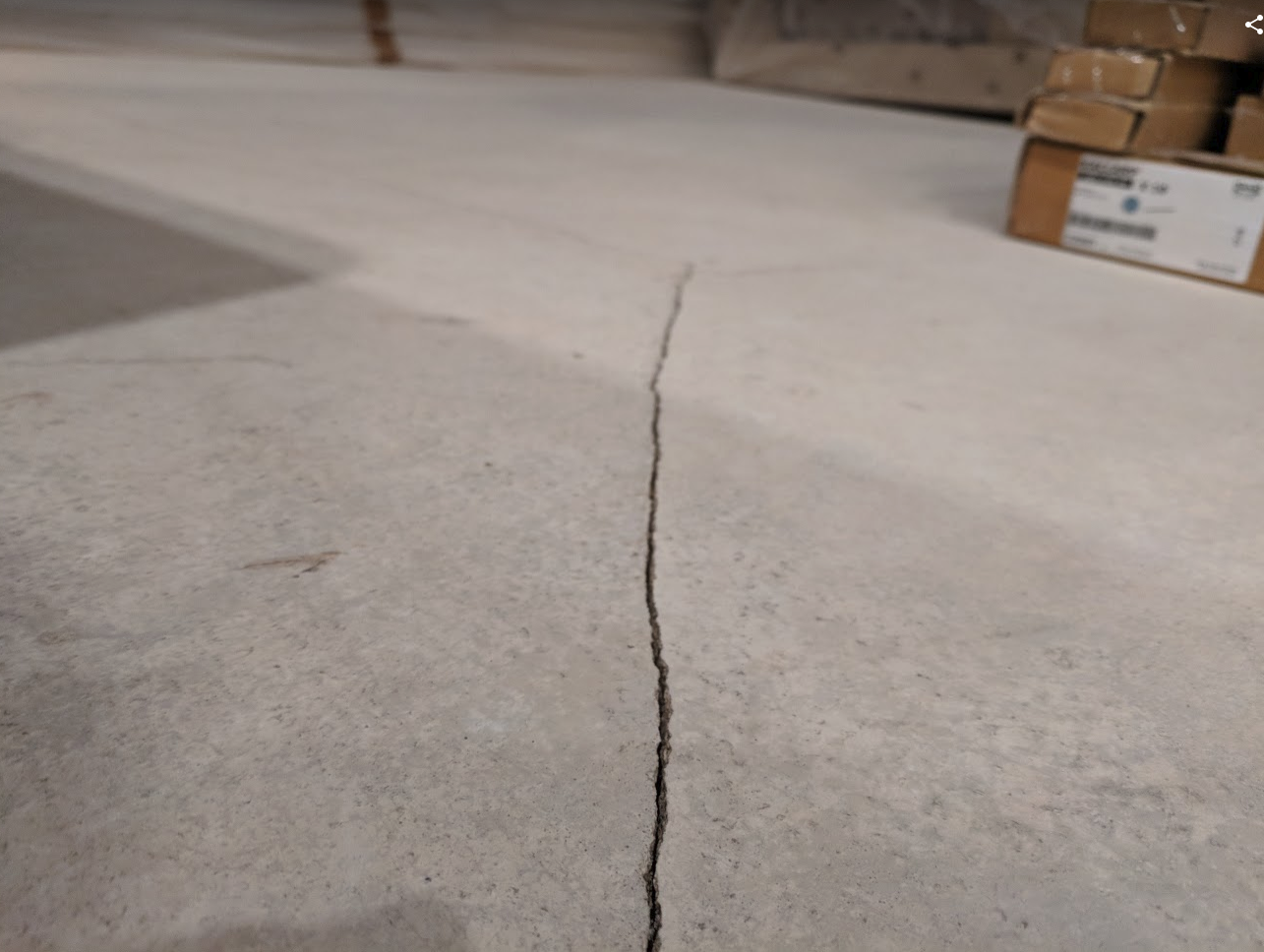

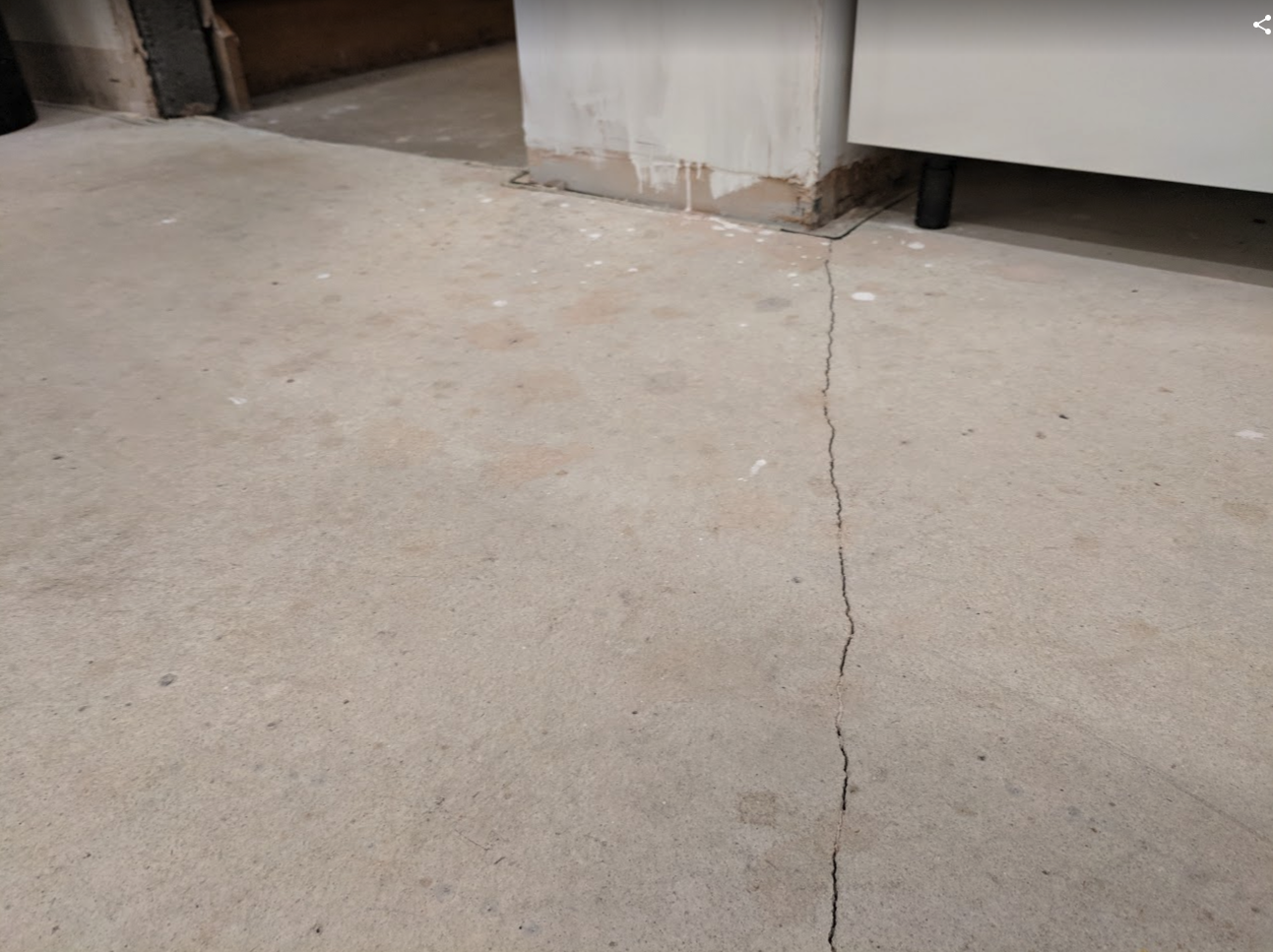

Cementainous screed with some cracks. Plan to deal with as below:
1. Sand/hoover/seal? Is the seal bit needed?
2. Fill any cracks I can with Resincoat Epoxy Crack Repair Filler.
3. Kerakoll Idrobuild Tex as uncoupling membrane
4. Stick everything down with Kerakoll BioGel NO LIMITS
Good plan?
