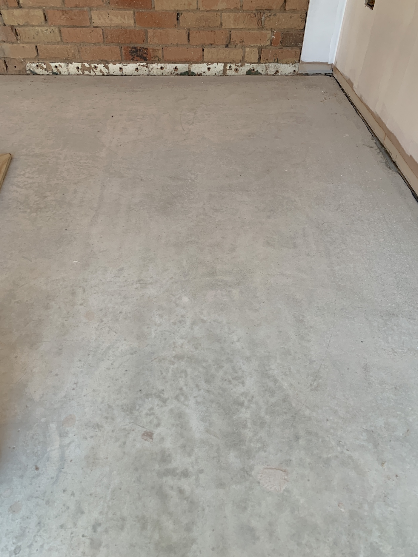

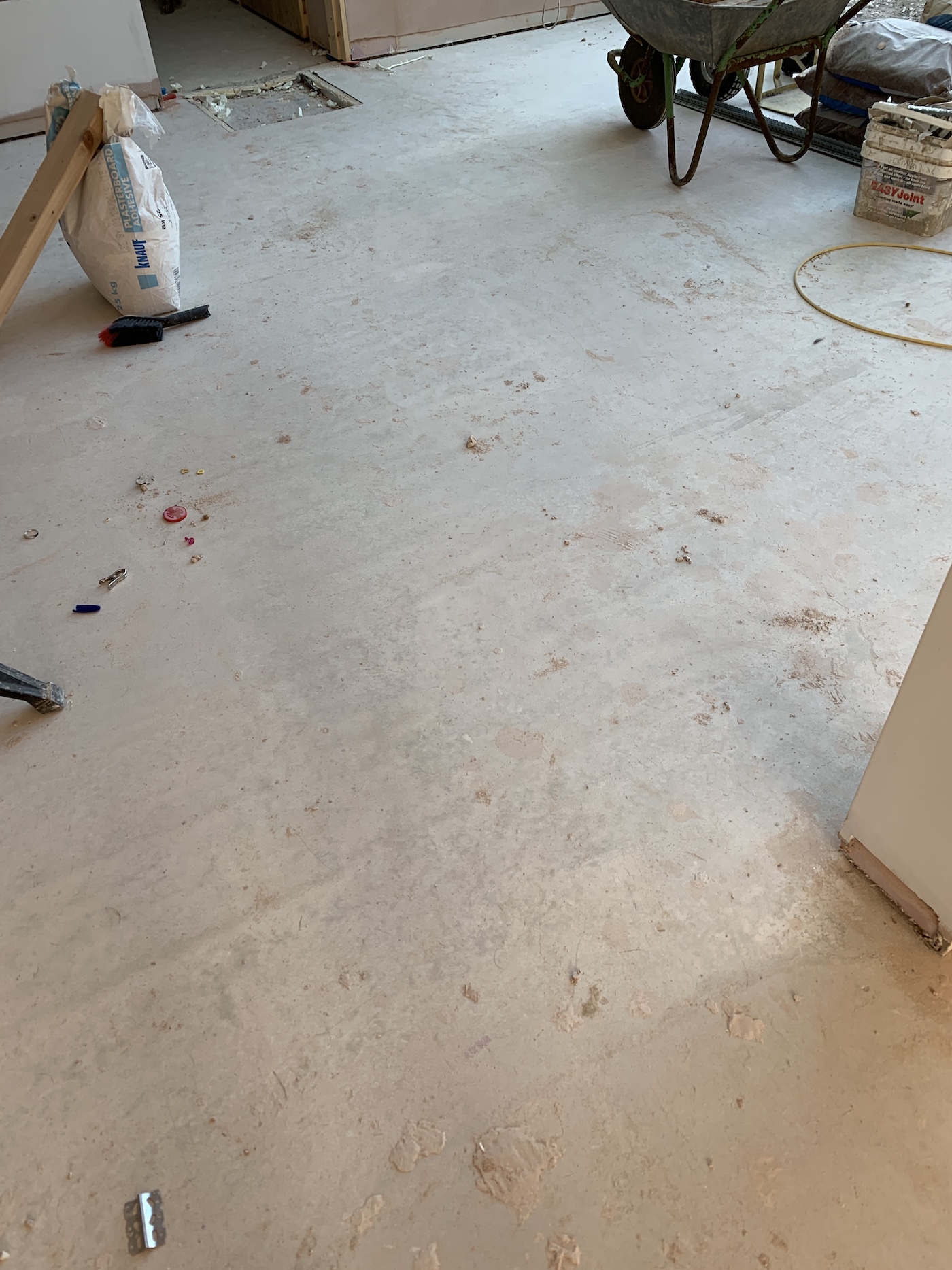

First thing, determine if the floor is cement or anhydrite. Post photos and take it from there, no point guessing !

Can't be certain from those photos but it does have a hefty layer of laitance on there which needs removing

I am thinking anhydrite. It just doesn't look the right colour for sand/cement and the surface seems to have a slight sheen. It also seems as flat as a billiard table. You can do a simple test with PH paper that will give an indication of the screed type and it should indicate green or purple but the best way to find out is from the people who supplied it (Humble pie?), and it won't matter which screed it is it can still be tiled but with different prep needed. HMTiling's advice is good.

Its cement based screed. Still needs sanding and moisture testing. UFH needs to be commissioned and run and screed needs priming etc etc

It looks like cement based to me as well, colour looks wrong for analshite .
