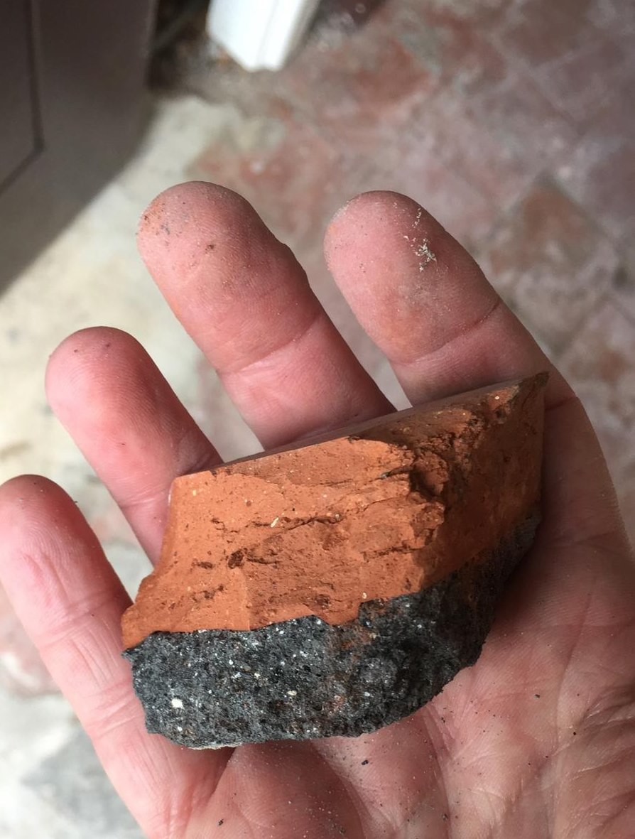

Situation (see photo)
100 year old terrace house. Front room appears to have original (or very old) quarry tiles on top of a thin base (not sure what), back room seems to be some form of concrete floor, age unknown.
Area has a high water table and damp floors and damp solid walls are the norm in this area.
We will be applying a chemical or liquid DPC to the walls but do not want to uplift the existing floor, but can increase floor height by around 30mm.
Many posts on this forum discuss various liquid DPM to be applied to floors, but in some threads (like one @Andrew contributed to above) someone gives warning about the need to keep the floor breathable.
This seems like a sensible way to proceed.
My proposed solution:
Lay new or reclaimed Quarry Tiles over the existing floor using some form of breathable mortar eg Hourdex.
We will also fit some form of re-circulating air system to extract dampness from the air.
I would appreciate comments on this or alternative solutions.
Any possible issues I have not considered.
Assuming we will be removing some plaster at bottom of all walls to apply DPC, is there any specific thing we should do when tiling up to the wall - before or after we replaster and add skirting board?
Tile sealer?
Obviously we do not want to completely seal the tiles. What should we apply to the tiles to minimize effects of liquid spills and to help maintain the surface.

Have you considered DITRA matting?
I’am sure it has all the properties you are after in 1 product.
Ask schluter technical.

We are not damp proofing experts , I suggest you talk to your damp proofing contractor telling them that you want to tile floor and ask them what steps they would take in preparing this for the work you have planned .

Tilemaster pro flow, and standard Setaflex white are both breathable. Universeal rapid all in one is breathable too

i would use bal bone flex which is a breathable membrain decoupler and tilemaster seta flex. the mat dose not need glue ing to the floor see BAL bone flex on web site
