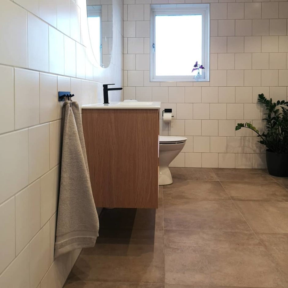

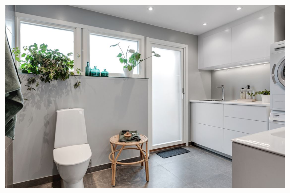

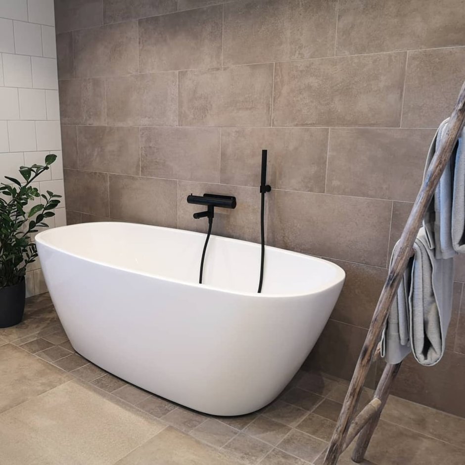

Bathroom I finished last year - Even thou all the walls are not tiled- it's still a wet room. Rules over here in Sweden are so strict - plus you must be a member of the Swedish tilers association before you can renovate any bathrooms - plus they send out inspectors to look at your work- if you have broke the rules & there are so many - then your licence will be taking away from you- membership is £700 a year
P.s_ I was Limco before ( but could not remember my password )- wow that was 10 years
Ago - where did all the time go ?
Post automatically merged:
This was bathroom finished last month

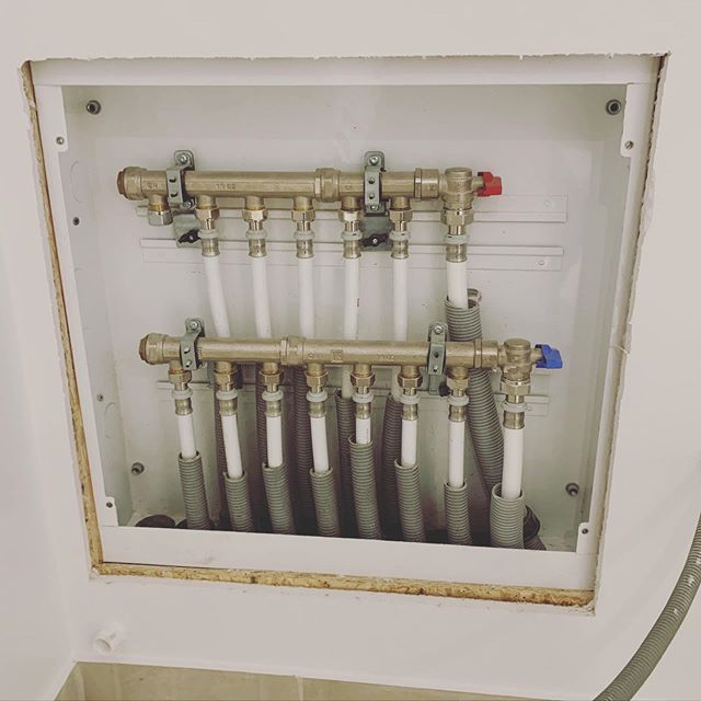

Okay ! lets see if I can explain this a bit better - when water pipes have been joined ( pressed ) and they are in the wall - then a access panel must be used-
this access panel will be on the other side of the wall ( not in the bathroom ) - could be in the bedroom or hallway......if this is not possible- then it will be in the bathroom
If the water pipes are old- they will be replaced with this ( photo enclosed )70836010_232584557706055_1919763503923344118_n.jpg
This will be in the outer wall - In Sweden, we call this Safety water installations - all new water pipes will be controlled here- as I said, there are so many rules over here with bathrooms

Me and a plumber did this for a guy with OCD who couldn't live with a joint in the wall so all pipes were hep2o running back to a manifold as above he did though have to have joints on the back of the shower mixer
