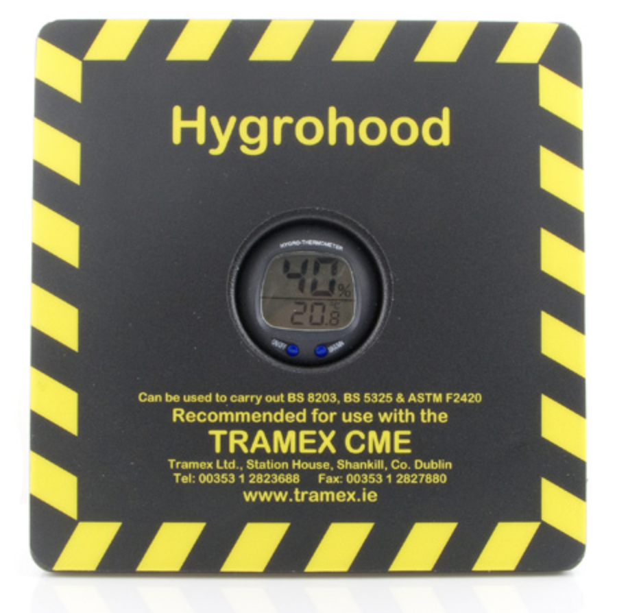

the only way to test concrete subfloors is with a hygrometer like protimeter hygromaster, protimeter mms or tramex cmexpert either by drilling floor and putting in the plugs or with a hygro box. All other damp meters are for wood but caan be used on concrete to give you best places to test. Rh% is the measurement british standards dictate otherwise you're liable for a failed floor. This should be done for every job and takes minimum of 48 hours to test.
check with british standards it's the only test they will back up
