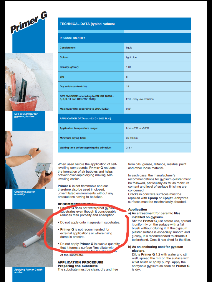

Thanks I had it in my own mind that using the same grout is a little ott. As the mapei primer G is ony about £8 I don't mind buying that extra but then can I use tilemaster addy on top of that (2.8x2.7 ) half of which will have Mapei P4 SLC on it.
WetSaw
Filip
43
Oh I missed that thank you so much, looks like I need the sp ? one I keep reading about in the P4 SLC info.
I will look int the sp
