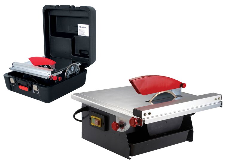

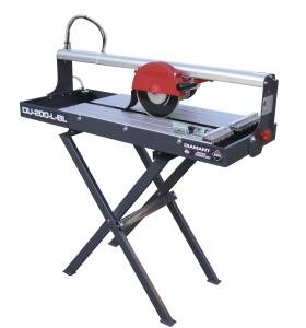

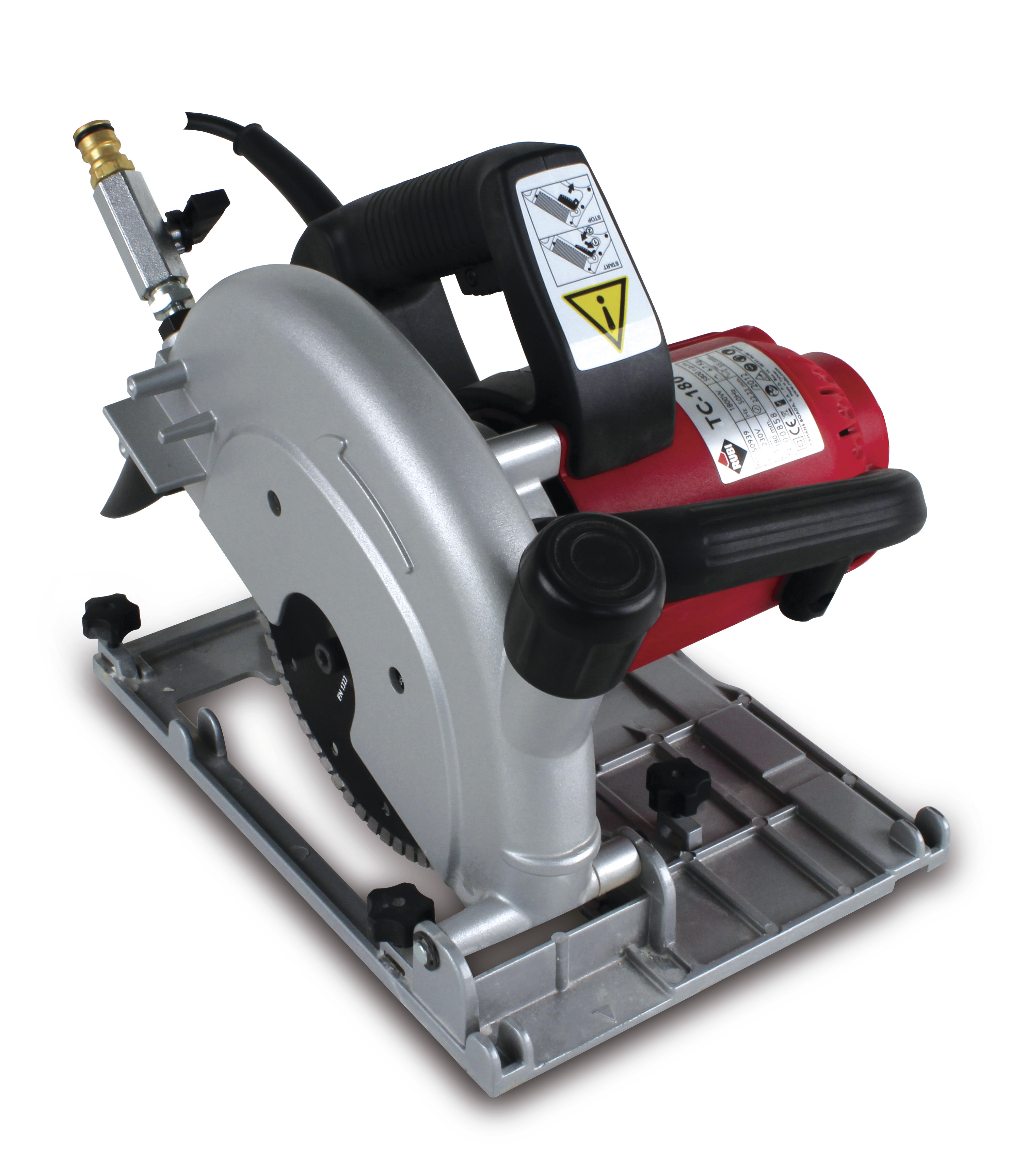

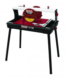

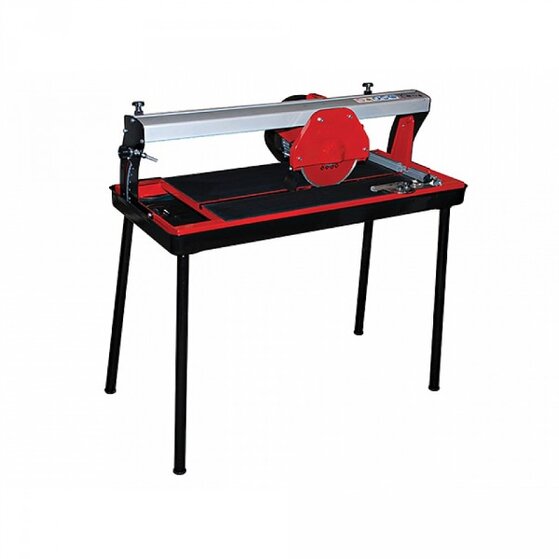

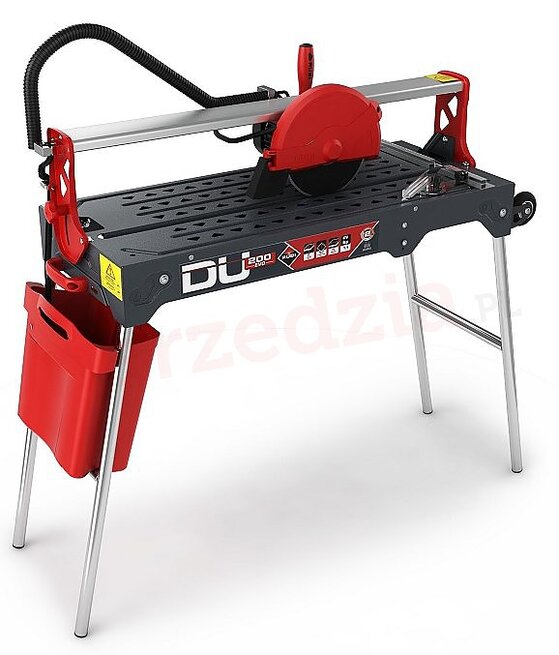

@Dan,
Rubi tc 180
Rubi BL 180 now renamed ND180
Lumberjack tc 180
Rubi du 200 L BL (basic line)
Rubi DU 200 Evo is American, not available here.
@Ttt1601 VORTEX! Haha Vitrex Power pro 800
Vitrex power pro 750
Personally, given the choice of all those listed
Except the Rubi TC180 (first image)

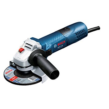

I'd probably go for Bosch GWS 7-115 and a decent blade, there are a fair few reasonable blades about now.
